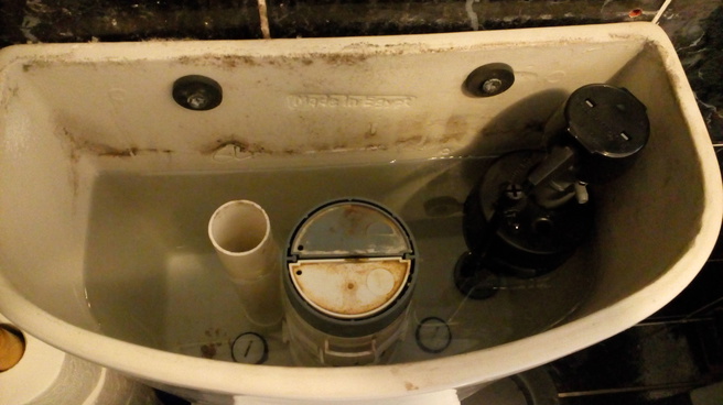

From time to time our toilet makes a sound as if there is water going into the cistern, but only very briefly: it only lasts only a second or so, if that. There seems to be no obvious reason for it happening (it doesn’t seem to happen when we run taps, or when we have just flushed it etc). I’d say we hear it maybe every couple of days but of course it might happen more often than that and we just don’t notice. It doesn’t sound like water going into the pan though I haven’t seen into the pan when it happens. It's probably been happening for a couple of weeks.
So, thinking it might be the fill valve I did a like for like replacement but heard the short ‘extra’ sound again last night. Does anyone have any suggestions as to what it might be and/or how to fix it (e.g. replacing the flush valve?) There’s no sign of a leak into the pan.
I’ve put a picture of the set-up below. The fill valve is new, the flush valve probably 5 or so years old. Except for the sound of ‘extra’ water, the whole thing works fine.

Might just be fluctuations in the water pressure overcoming the inlet valve till the level rises slightly to exert more pressure on the float. I have a similar effect if the toilet is flushed just before showering, it fills and stops whilst you are in the shower but briefly trickles as soon as the shower is turned off.
there is a seal on the flush valve , not the one that seals it to the cistern ,its on the end of the drop valve. if the condition is poor ,it allows a tiny amount of water to pass and you can hardly notice it running into the pan. eventually the water level drops in the cistern and the float valve opens ,only momentarily ,tops up the level and closes . this cycle repeats non stop ,but it can be hours in between. if you grab hold of your flush valve at the top ,and turn it about half a turn ,it will separate from its base and you can withdraw it from the cistern .the seal is at the bottom of the section you have withdrawn . turn off the water supply before you do this and flush WC before you start as well.

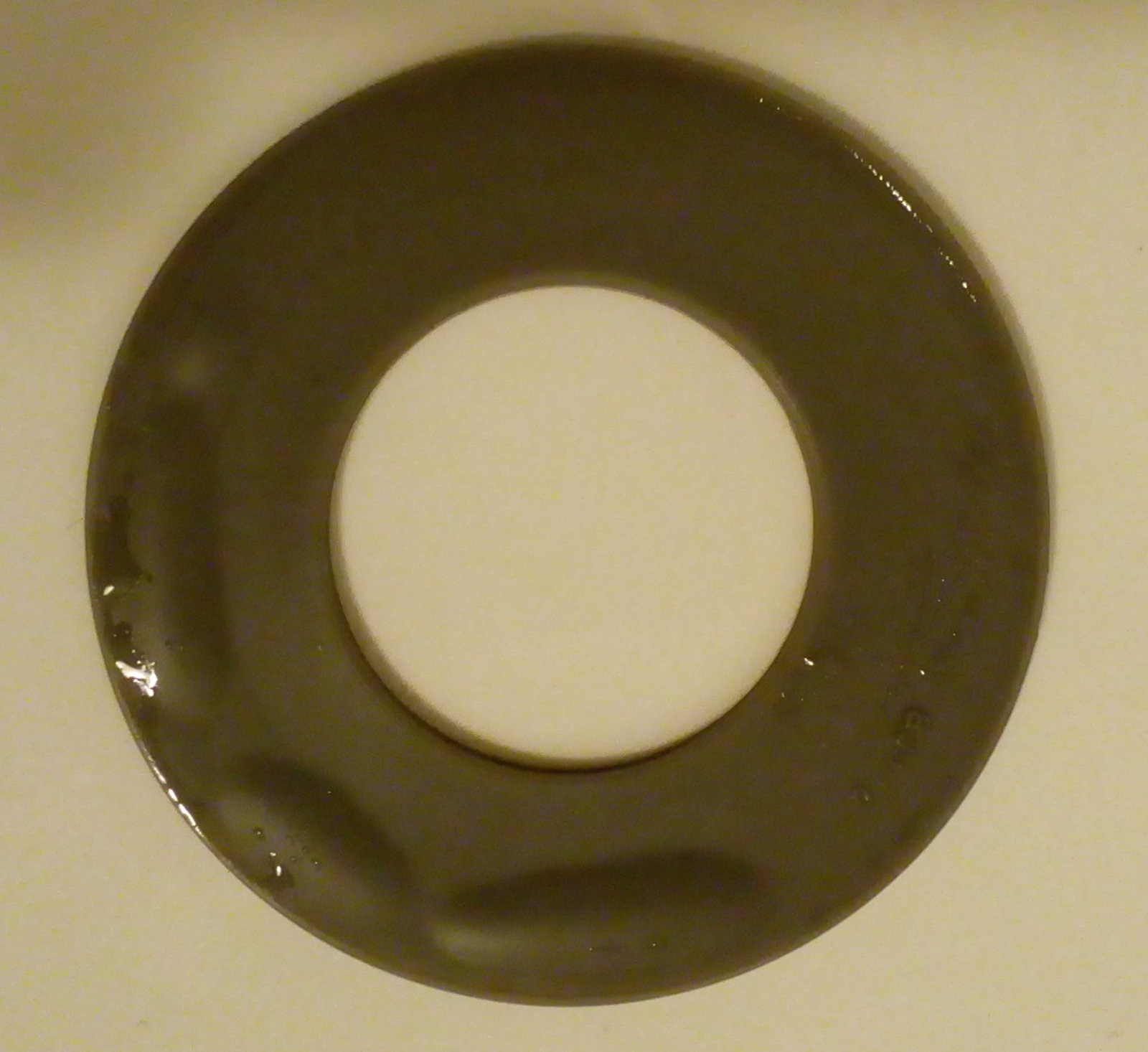

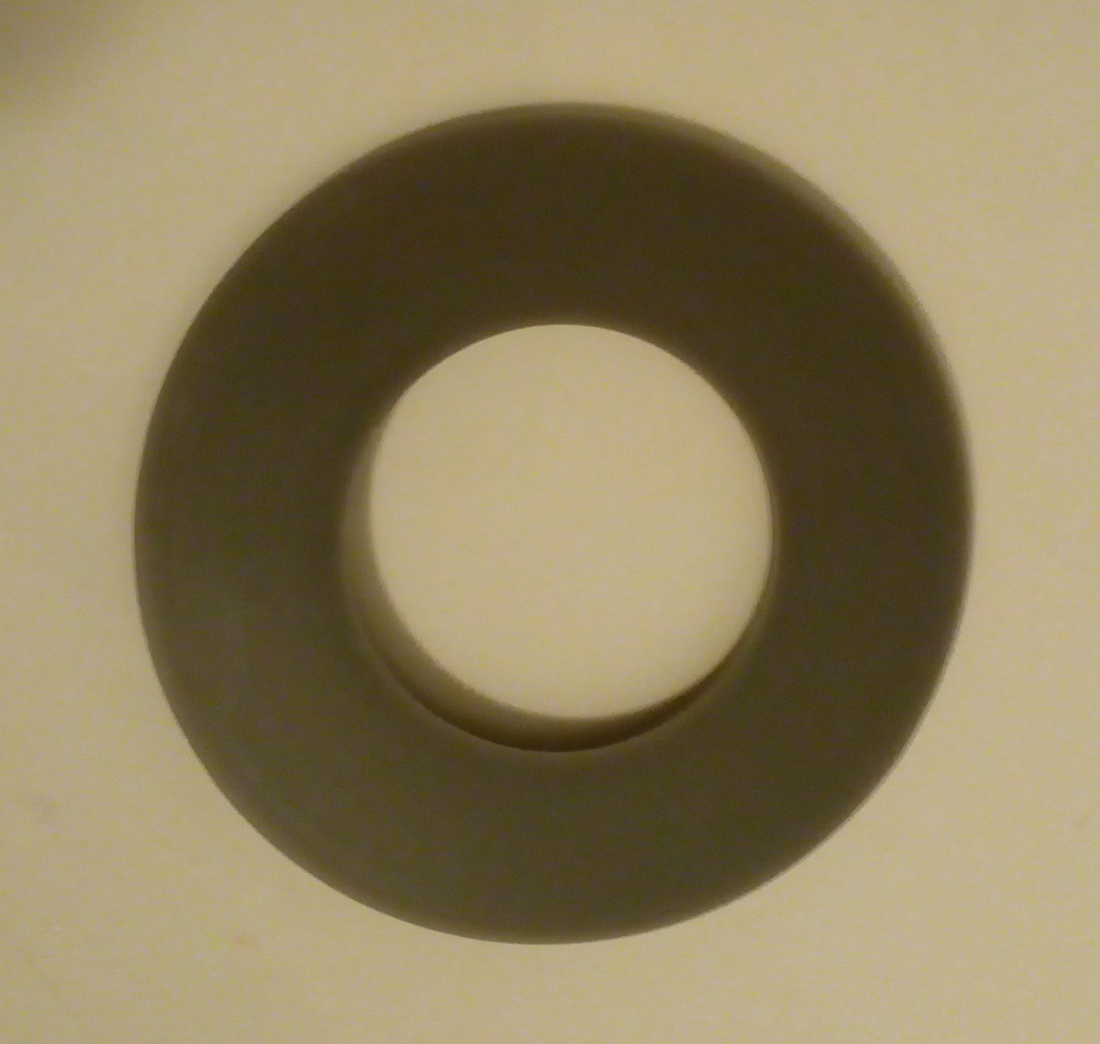

can you post some pics of the seal ? also check the basepart of the valve ,the bit that is left in place in the cistern. see if it is seated tight against its seal against the cistern ,by trying to rotate it slightly.if that seal is letting water pass you get the same effect.
Aha.
The basepart won't budge, so I'm confident it's not that. But when I removed the seal to take photos look what I saw...
The underneath (the bit that makes contact with the basepart) looks fine.
but the other side (the side that's concealed when the seal is fitted) has a series of bubbles in it.
Maybe that could account for the problem? In any case, it doesn't look good.
as just pumps says thats exactly your problem ,the little bubbles stop it from sealing fully. just change the seal.
