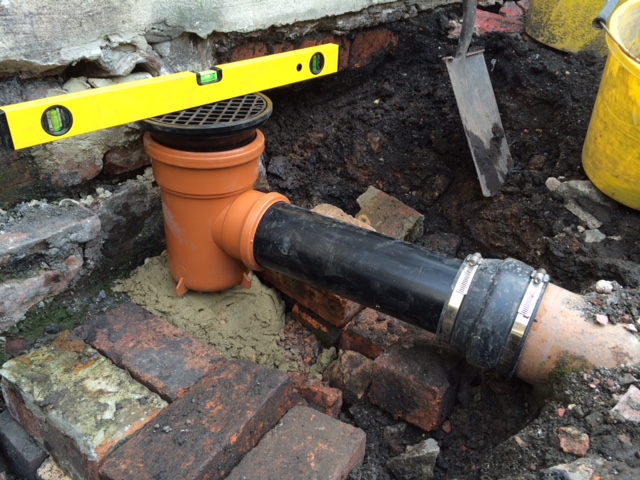

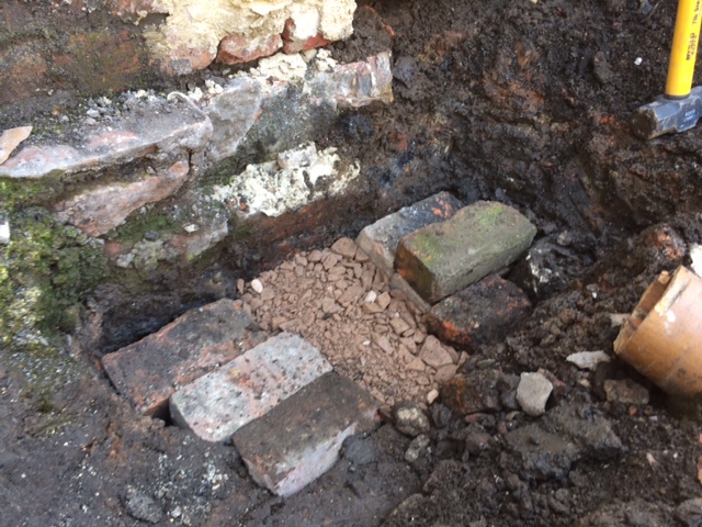

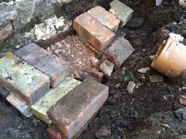

This weekend I've spent some time fixing in place the bottle gully you recommended. Here are the steps ive taken:
* Dug a lilttle further down to accomodate some sub-base.
* Installed some bricks loosely around the area that will contain sub-base.
* Applied sub-based and compacted with a sledge hammer.

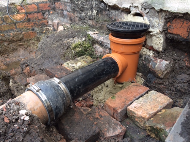

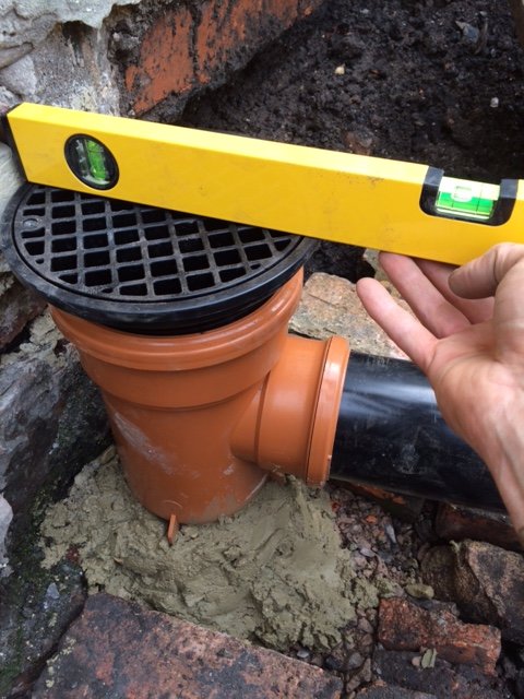

* Set bottle gully in position on a bed of concrete (5 balast, 3 sand, 2 cement)
* Checked for level on the gully grate, there is a slight fall towards the pipe.
* Checked for fall on the PVC pipe, there is a slight fall away from the gully.
I would like some feedback on this before I go ahead and fill with gravel and cap with concrete.
Many thanks.

The way I read this 'hole' (you get it) post was that your house might collapse due to this broken drain. If that's what you where asking I don't think you have anything to worry about.
It looks like you have another waste pipe coming in from the left of your first picture so you where correct to redo the drain correctly you can almost guarantee that as soon as you started to back fill that clay to plastic converter would have popped off.
Your grate should be level as the gradient is already built in but it wont matter.
Maybe post a picture?
But if you followed the advise on here and you are happy about it they I am sure it's fine.
As tomfe said, it looks as if you have another waste pipe coming out from under your house just behind the drain cover? If this is still in use, I'd be sure to connect it up before you back fill.
