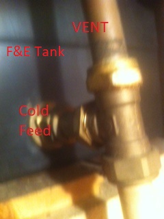

Hi my f&e is pumping over and BG said it would be best to combine both pipes (££££££££) and lose the vent, is this a job that can be possibly done by a diyer thanks Billy

Before rushing off can you post a photo/details of your existing system.

Changing to combined is tackling the symptoms, not the cause. My guess is the overpumping is due to a restriction between the vent and feed connections. Needs clearing. I assume the system is piped boiler - open vent - cold feed - pump.
Many thanks for your responses will take the joints apart and clean the H
Did I see a picture of your H a few minutes ago?, seems to have disappeared, but if so looks as if it might have been cut out sometime and replaced with all compression fittings so no problem in opening it up now??.
