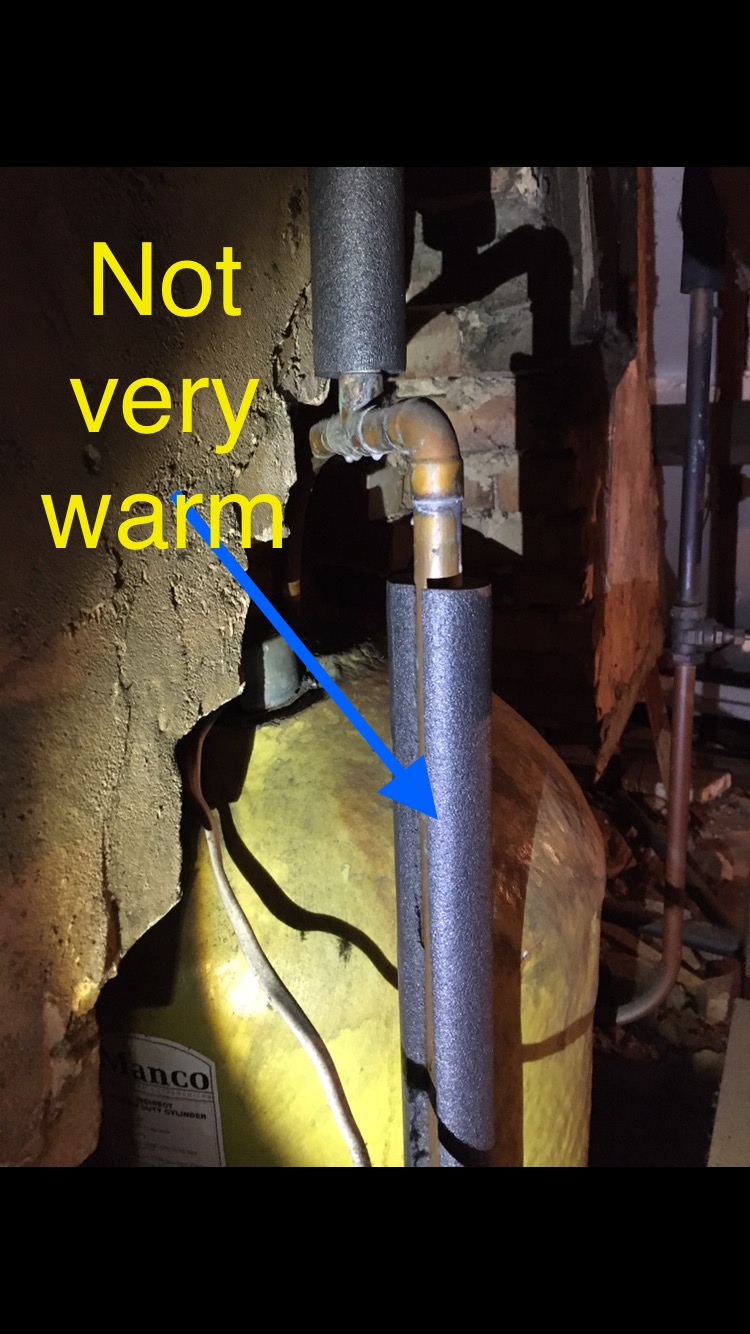

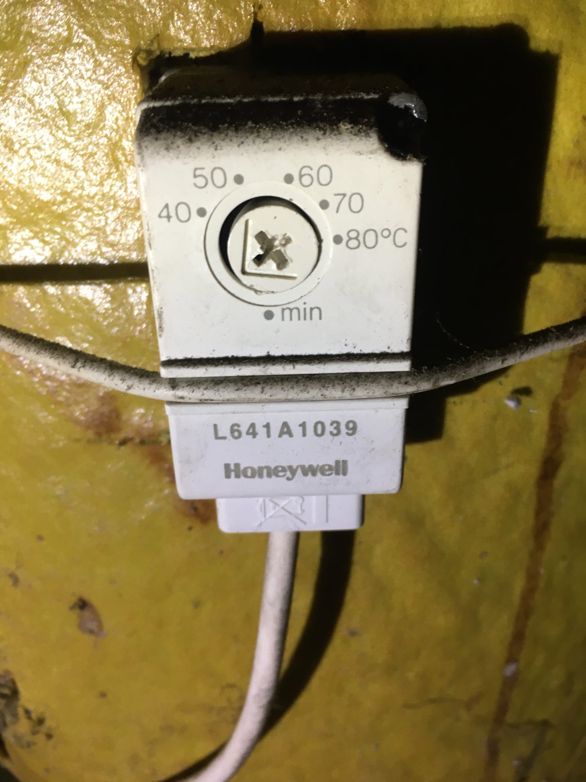

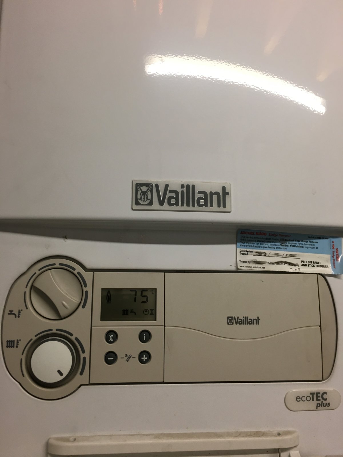

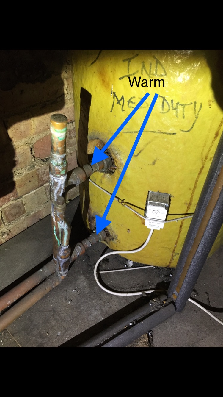

Ok so I went in loft and checked the pipes out the two pipes going in to the green hot water cylinder were warm to hot, but the pipe coming out the top of the cylinder and bending around was not very warm, this was after the hot water has been on for half an hour also I checked the thermostat on the hot water cylinder and it clicked at 35, I have also turned both dials on the boiler to maximum I’ve added some pictures

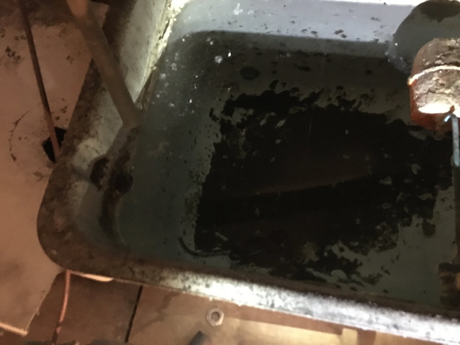

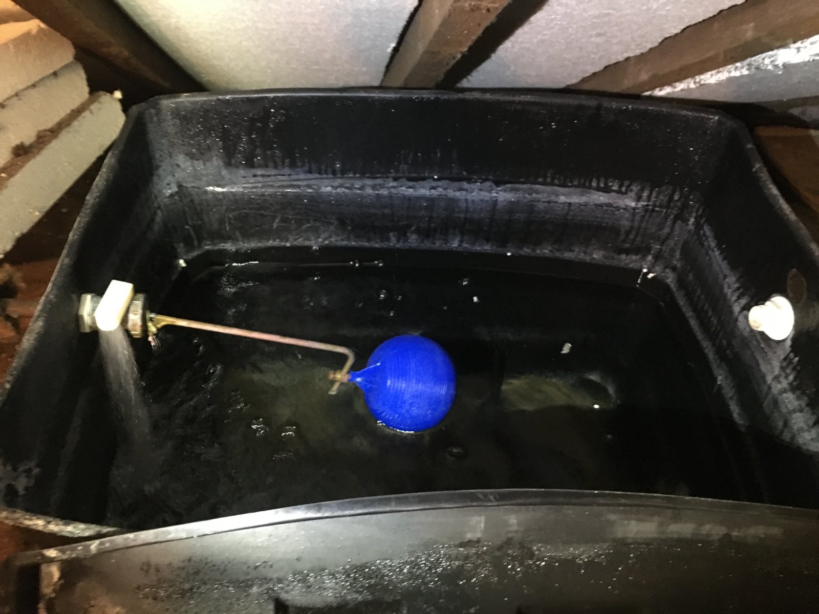

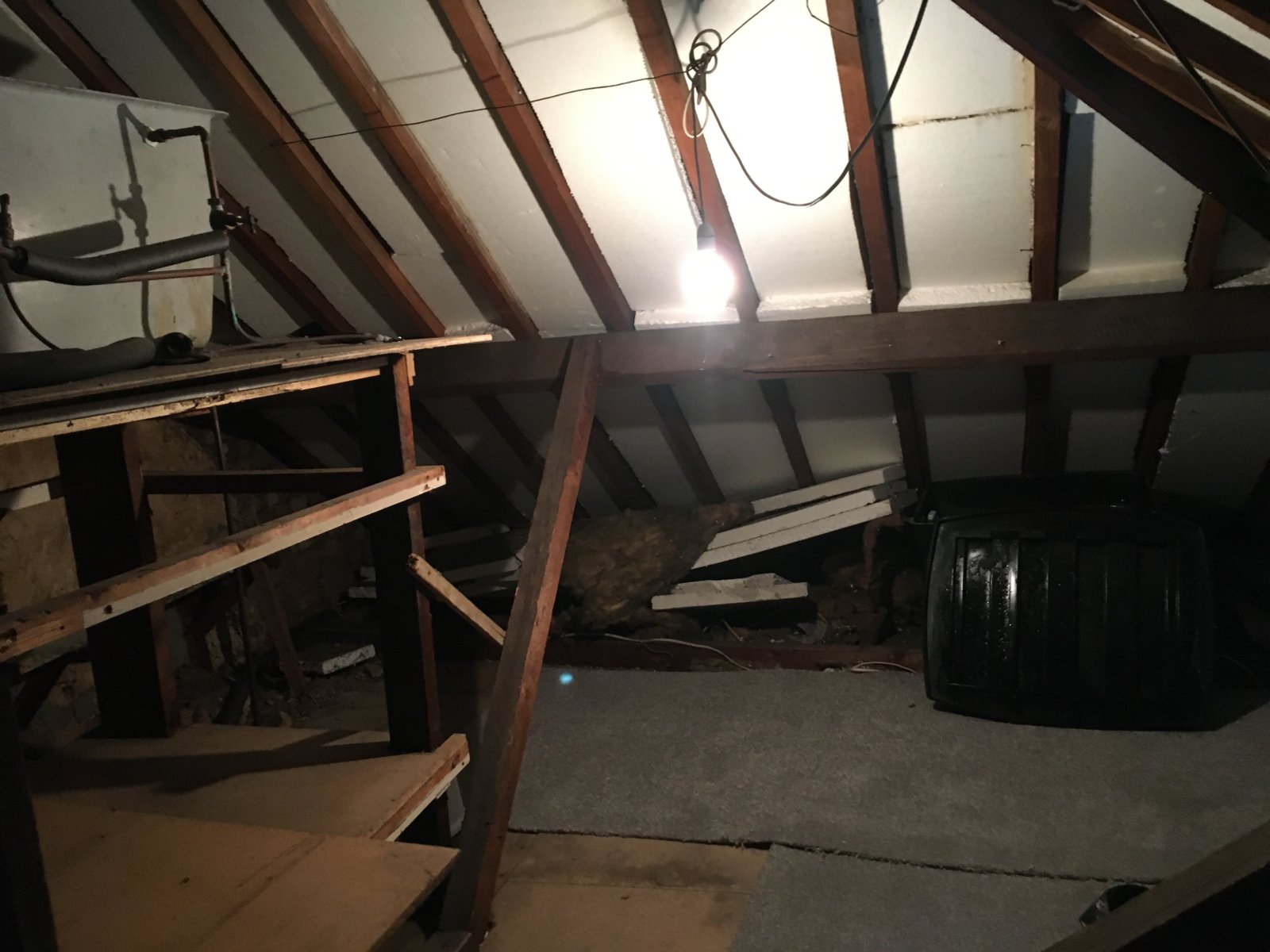

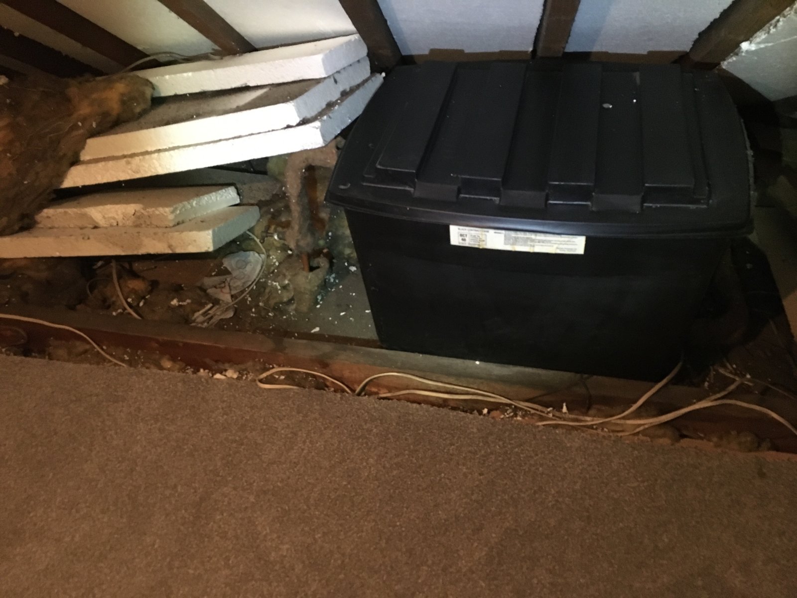

I have also noticed that I have 2 cold storage tanks the blue one which is high up on the wooden platform seems to be doing nothing the outlets have been capped off this is strange because I thought the blue cold water tank supply’s the hot water cylinder???, also the black one on the loft floor seems to fill up when the cold bathroom tap is on full, but the blue one in the platform does nothing, but that makes me wonder how is the hot water tank being supplied with water?
The smaller black tank appears to be just sat on the plasterboard ceiling, so at risk of making its way through the plasterboard.
It seems to me that someone has done a partial, unfinished conversion from an open vented system, to a combi. It really needs a thorough survey by someone who knows what they are looking at, to tell you what's going on..
Its your boiler output temperature which is too low to heat the water. Boiler output temperature has to be higher than the cylinder temperature, or no heat will be transferred and the boiler will futilely burn lots of gas trying.

btw in the picture the ops boiler stat is set at around 70 degrees .

Yes, the OP's boiler is set at 70C and if his cylinder stat were set at 60C all would work fine. If he were to set the boiler at 60C and the cylinder stat at 70C, then the boiler would just cycle endlessly wasting gas to achieve nothing useful.
How can heat from something (the circulated boiler water), (normally) be transferred to something which is the same temperature (the cylinder)?
Where will the boiler heat go? It would just be wasted warming the pipes up, as it cannot be transferred into the cylinder..
It’s me the OP I set the boiler to 70 and the hot water cylinder only clicks at around 35 it never clicks at 60
