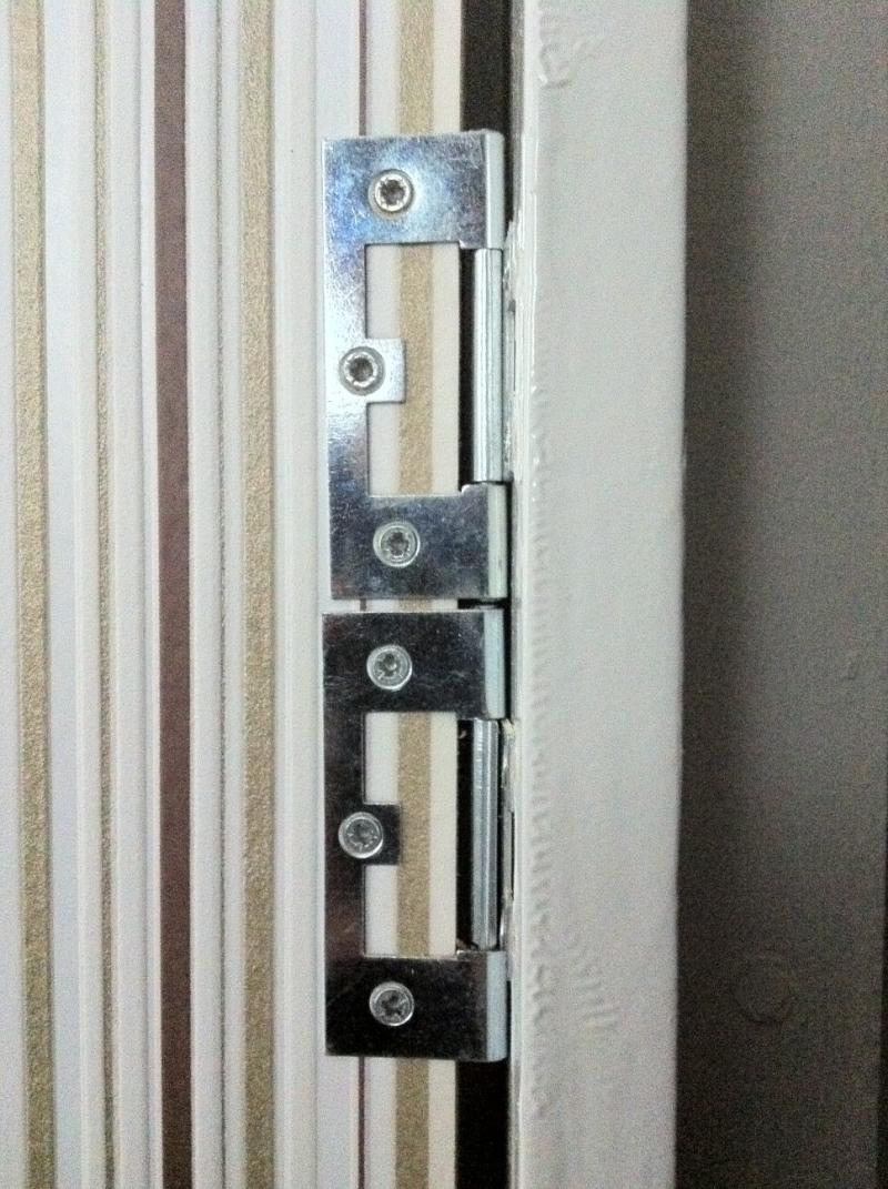

So I've put up a huge MDF door to a fitted wardrobe.
Amazingly I've got it completely straight and level but when I open it wide it slowly swings back to the middle (below) and when I close it, it slowly swings open to the same position.
What I really want is for it to swing open fully on its own when I've opened it (I'll use magnets to keep it closed). So I guess I need to swap a couple of the hinges for spring to open ones. Maybe just a few until it swings open just enough on its own.
The hinges on there are the moment are flush hinges and the tube part just fits between the door and the wardrobe (below).
Where can I find sprint to open hinges that are flush and the same size as the ones I have on there now so I can replace the hinges one by one without taking the door off? ie the tube part of the hinge must be small enough to slip between the door and the frame.

You have put the hinges on the wrong way and not level that's why it swings open.Self closing hinges [if that's what you mean] cannot be used with touch latches since one fights the other.

How have I put hinges on the 'wrong' way? If you're suggesting the large part of the hinge should go on the frame you're wrong, as the 'barrel' won't be flush that way and won't fit.
And what do you mean when you say they're not level? The door as it is is completely level, though I imagine the frame might not be. How should I correct this?
The hinges are designed to fit on the edge of a door and frame and if level the door would not swing open.The hinges in centre picture are clearly out of line with each other which will cause them to pull against each other.
