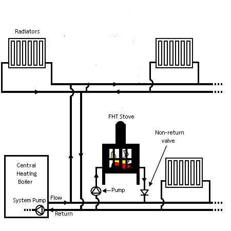

Hi, I’d like some advice, I’ve had the idea of installing a log burner in my front room, but I’d like to go a step further and have it heat the rads eveywhere else in the house, I have a Worcester combi boiler fitted, and I was wondering if I could just t into the heating system down to the log burner and fit an additional ch pump to it get it circulating round, question is in by doing this am I going to cause fault with the boiler?

Not that easy I am afraid. Solid fuel has very little thermostatic control, and needs some form of heat sink to dissipate unused heat. The system has the potential to boil the water, and needs to be built with appropriate safety systems in place. A combi is usually fitted on a sealed system, they would need to be kept separate, and connected to the Rads via a suitable Heat Exchanger.
Not really a DIY job, needs someone who knows what they're doing or you could create a potential bomb.
Adding a secondary uncontrolled heat source to a CH system will never be cheap and easy.

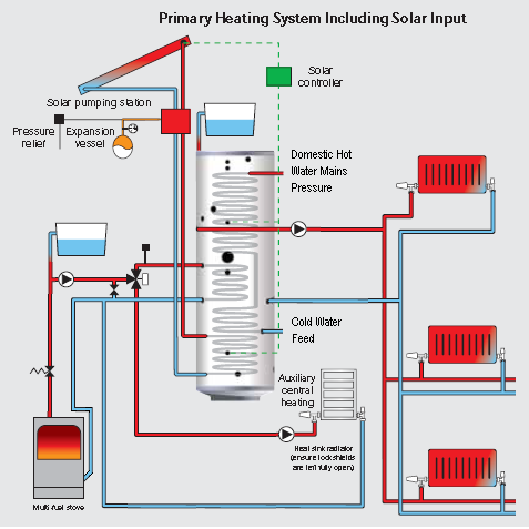

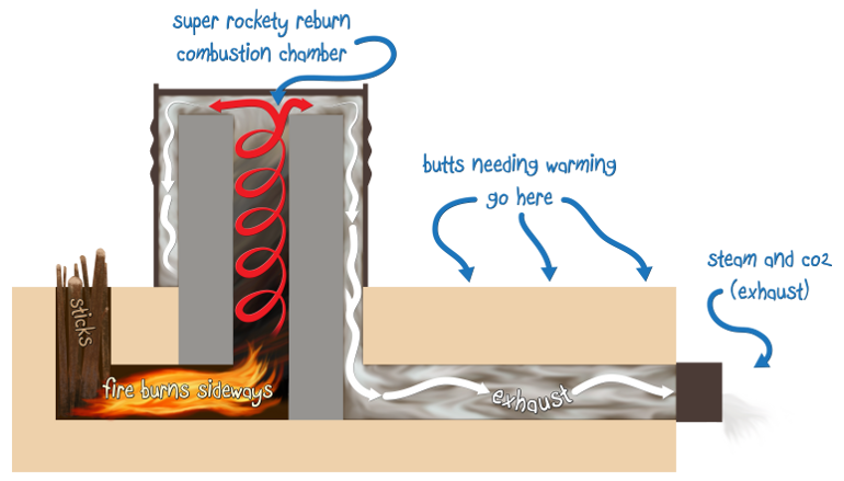

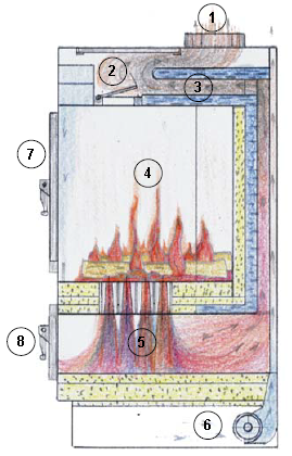

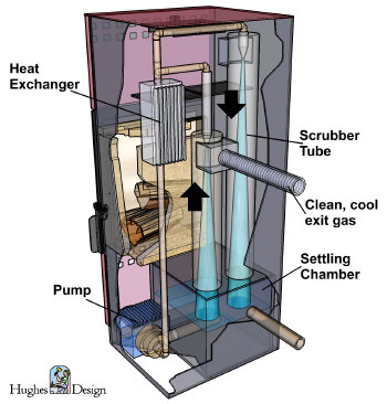

This is the basic idea, as @algas said with first answer, the idea is the wood burner can get rid of the heat using thermal syphon, although it shows a pump, water can still circulate without it. There have been some ideas, the stove shown here Hughes Condensing Stove 2 small.jpgwas claimed to be condensing and super efficient, I wrote to them and asked what system was used to cater for power cuts, I got no answer, same with this wallnoefer.PNG one, great ideas, but not thought through, the rocket rocket-mass-heater-diagram.pngdoes seem to work, but not connected to the central heating, and near impossible to get home insurance with one fitted, so most these ideas are just that, an idea, which has never really been thought through.
The tank shown on the first diagram looks simple, but in real terms very expensive, only seen one fitted, it was fitted when the house was built, so the floor could take the weight of the two massive tanks, diagram shows one tank, but in real terms it was two, I would guess around 150 gallons of water, it was enough so when my brother-in-law who lived in the house visited his children in Germany by turning the temperature down when he left, the solar panels could not only stop anything freezing, but heat the twin tanks enough so at airport on return he could turn up temperature and have house toasty warm using the stored heat, and once home one fire in the evening would maintain the house temperature all day.
So on moving he thought good idea to get installed on new house, got quotes around £24k, no way at 70 would that ever pay back, so he like everyone else has a fire as back up should the oil fired central heating fail, but no back boiler fitted.
