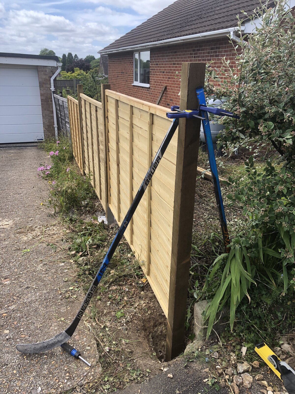

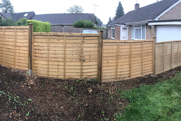

Last year I replaced the front side fence between my neighbour’s house and my house, using 3” wooden posts and 4 foot overlap panels. It looks very neat.

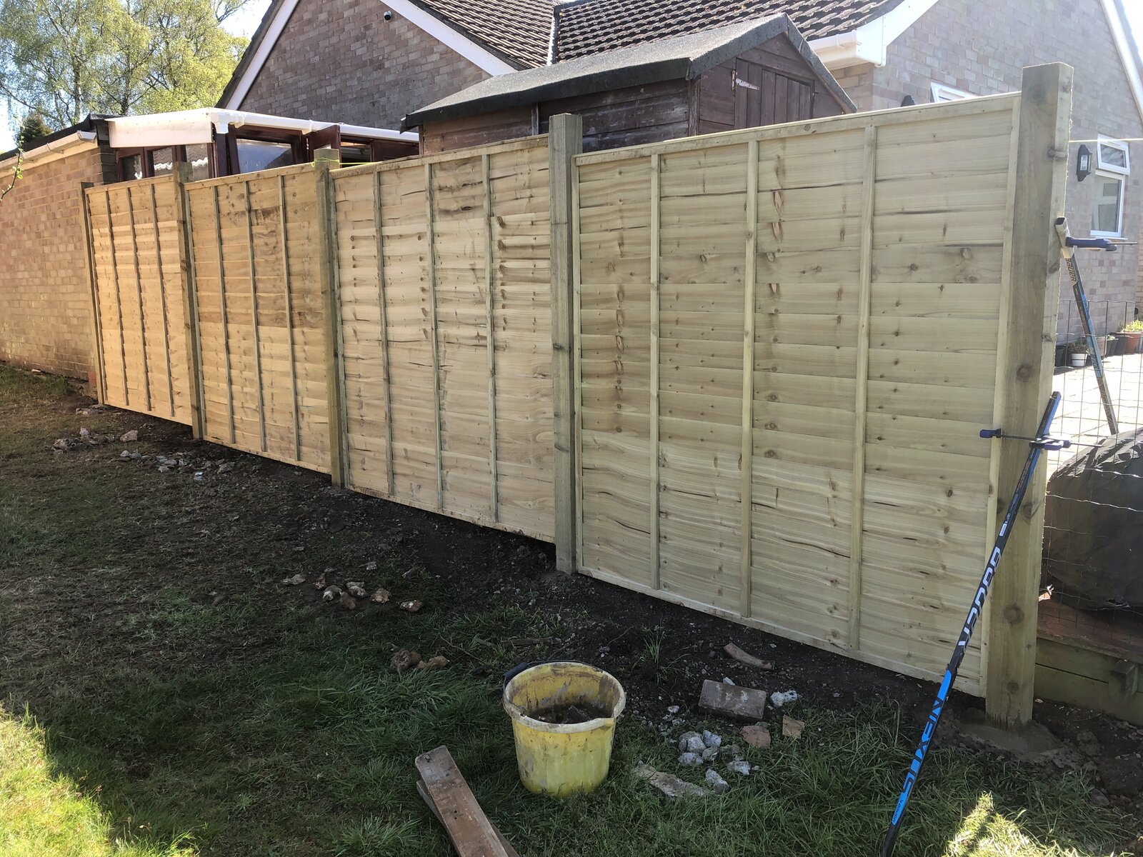

Early this year some panels and posts in the rear fence with the same neighbour came down in high winds. So I need to replace them, and I will replace the whole fence. There are ten panels in total, each 6 foot tall and 6 foot wide. Most of the panels were supported by 3” wooden posts. A few had 4” wooden posts. The fence is at least 18 years old, and almost all of the 3” posts are solid, three 4” posts rotted.
I reckon I will have no chance in hell of doing concrete posts on my own, or putting in the panels on my own. So wood it is. I can lift 8 foot 4” posts, and 6 by 6 foot panels on my own. I will buy a two wheel cart to move them. I did the front posts in concrete, exposed to the air at the top and sloped downwards to ensure water drains. I will do the same at the rear.
The general advice I see everywhere is to use 4” posts. Has anyone here used 3” posts, what was the outcome? I am tempted to use 3”, my reasoning is that the posts outlast panels by a few years at best, and replacing a post is easy, and best done when a panel goes. Also, 4” are heavy and not easy to manage.
