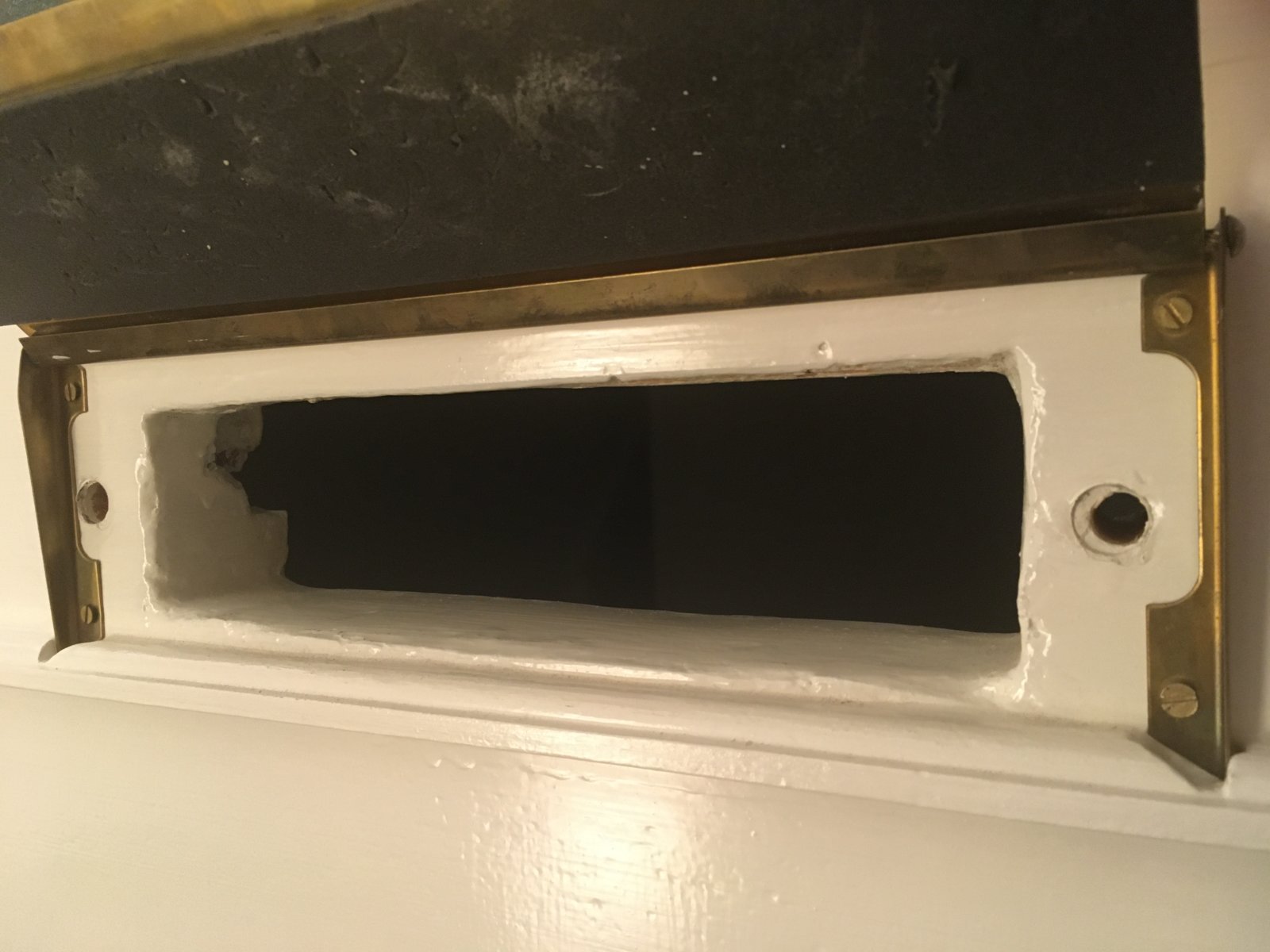

Hello. I would like to do away with my letterbox so I need to fill the hole. The end result will hopefully be a door with no sign on both sides of an old letterbox. It’s quite a large rectangular hole cut into a very solid wooden front door. What would be the best method?
Remove the paint in the existing hole (route it to the size of the block to fill it with).
How about a brass plate covering it? perhaps one that's meant to go on a door above the handle to push open - but fitted horizontal?
Thanks for your suggestions but I don’t want a shiny metal plate on either side. That’s kinda the whole point of getting rid of the letterbox. I want it to look like there was never anything there.
In fill with timber slightly proud as tight as possible , then wood/car filler to finish and sand back . Decorate.There will always be a possibility for the repair to crack though .
Fill it with wood and paint the whole door then :)
Still remove the paint from the inside edges of the hole before fixing wood in though.

i suppose i will try the filling with wood and then filler (I’ll prob use Toupret caulk and then filler to try prevent cracks appearing.
I did consider expandable foam followed by a thin piece of wood either side, but that could get messy.

I think you need to make a "Dutchman" -that's what the yanks call it, maybe Brits too?
Basically rout a perfect oblong that covers the hole, a bit bigger than the hole and shallow so that the door provides support for the panel that will be let in. Ditto on the other side.
Then cut a timber patch and use something like gorilla glue to hold the patch. Fill the centre with a chunk of timber and another patch on the outside of the door.
Cut the patch so it sits just proud of the door surface
A bit of sawdust and glue as filler helps then sand or plane the patch so it is flush with the door surface. It's easier than a big block of wood in the letter box and you can take your time

Treat the letterbox hole as two separate repairs, one inside, one outside. This way it's easier to get both sides looking ok as you only need to get each side right, and not undo one good side because you messed up the second.
Using a template and router, you can create a pocket that uses the same size patch instead of two one off's.
The router can remove a larger area than the letter box but only make a shallow recess to suit the patching timber. But the recess should allow enough of the original door's material to support the patch all the way around.
You don't really need to fill the centre of the hole but soundproofing would be better and it's "properly done" if you do.
