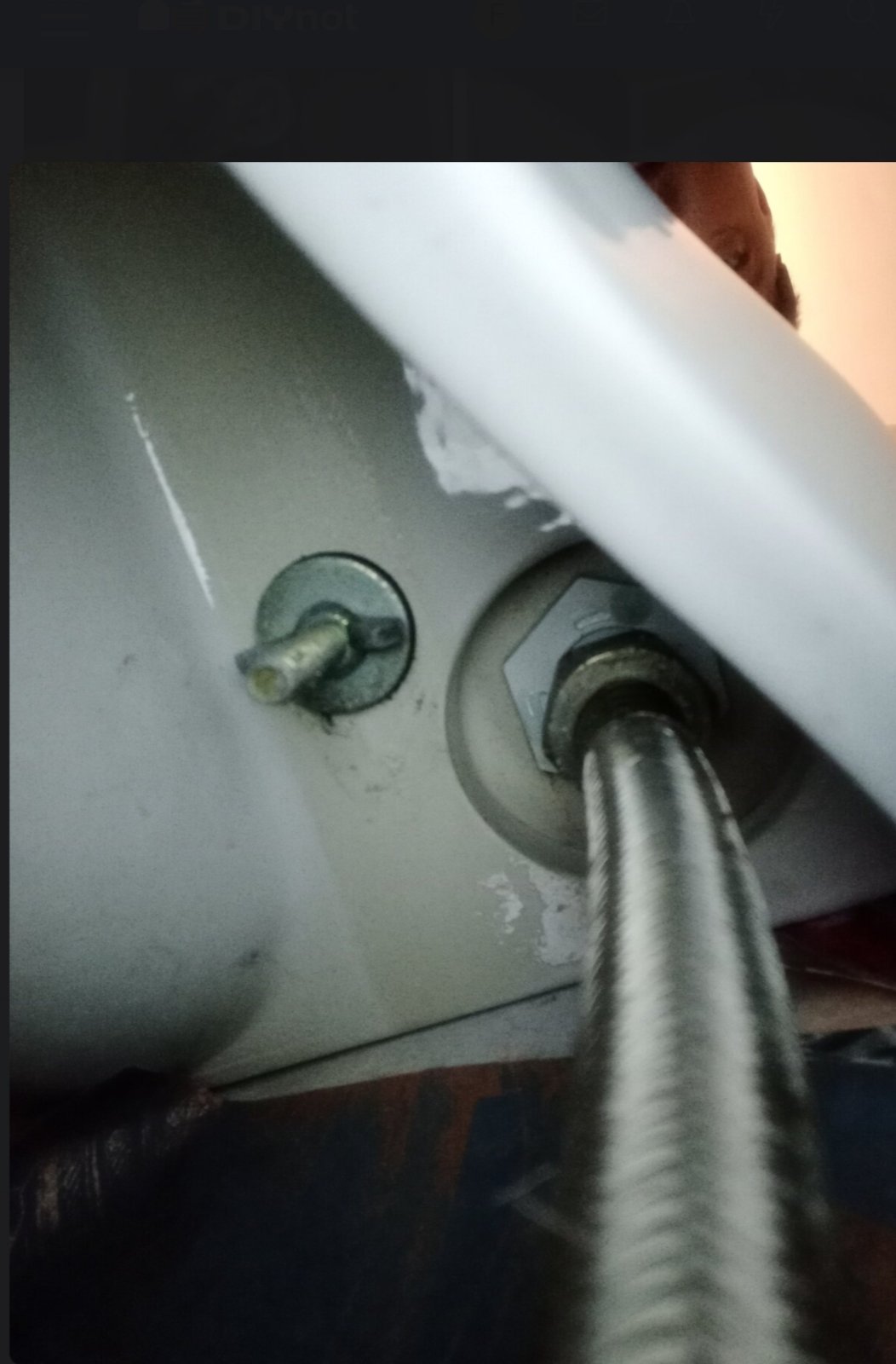

Can you change the fill valve on a ideal standard toilet that is kind of semi concealed without having to remove the cistern from the toilet
You want to change valve of have ago at swapping valve rubber?
It's like that
Looks likely you can.
Turn water on.
No need to get it tight when you fit new one. Just a gentle nip up.
You need to get water out cistern first with sponge and dry up.
Get that inlet off. Get that far and it's all good
Refurb kits for Ideal fill valves are available -diaphragm washer ,billet etc.
CBA to research the part number just now but saves sweat if access is poor e.g. back to wall wc
Those close coupled designs are a PITA!
If you can get a tool up there then sure, go for it, but I usually have to remove the cistern and then change both fill and flush to one's that are top removable.
