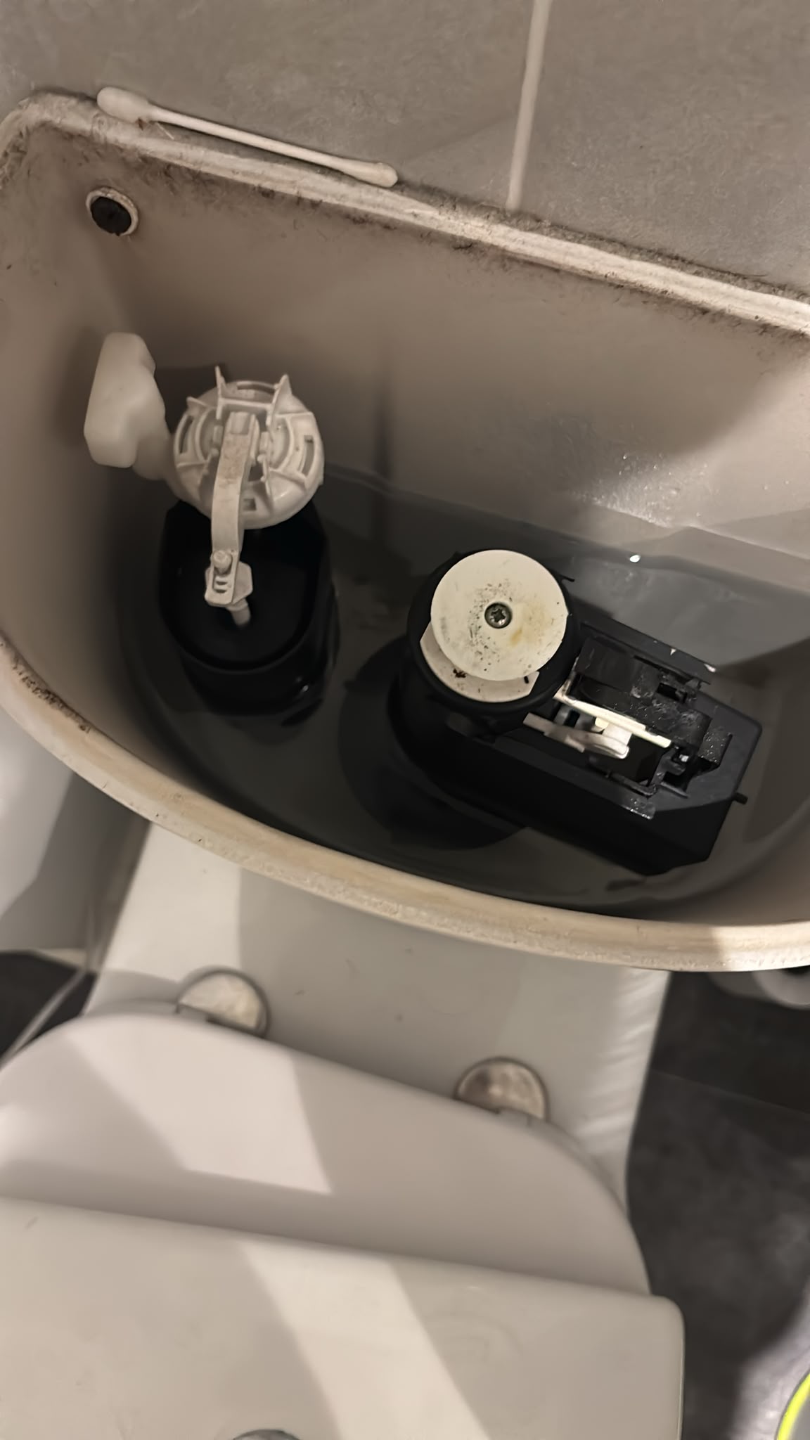

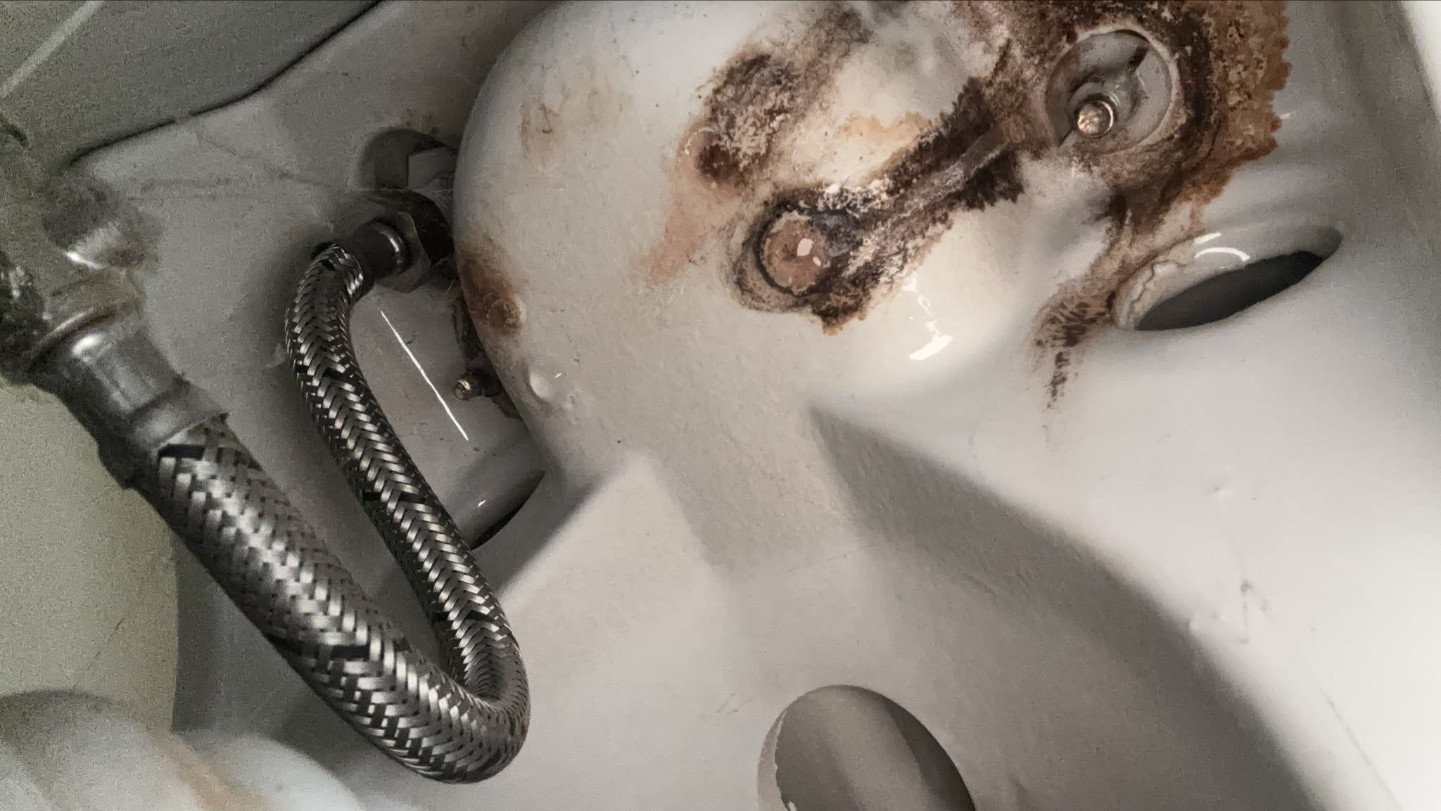

Looking from above it looks like it's on a close couple kit can't see the bolts. Is toilet off new close coupled kit ( flat one with it being ideal). donut washer. Would you just do a full toilet refurb if taking the cistern off? New flush valve fill valve

Was thinking of swapping to fluidmaster fill valve and they do a decent 2inch flush valve.
I've started to use skylo over fluid master.
I'll have a look either way might as well swap everything if taking it off? May just be the donut. But I know that ideal flush valve is obsolete if anything goes with it in the future
That's my thoughts if I have it off. Even if just donut. Might aswel replace it all? for the time it takes
Skylo are good and I wouldn't fit an inlet valve without a brass shank but some of the villages around here have up to 10 bar standing pressure and they can't cope with it
I wouldn't send 10bar to any internal valves!
