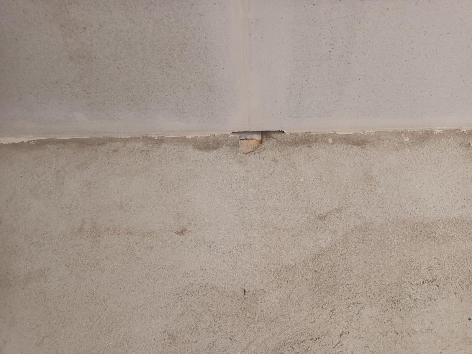

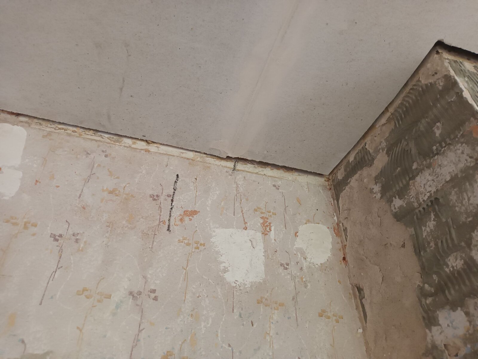

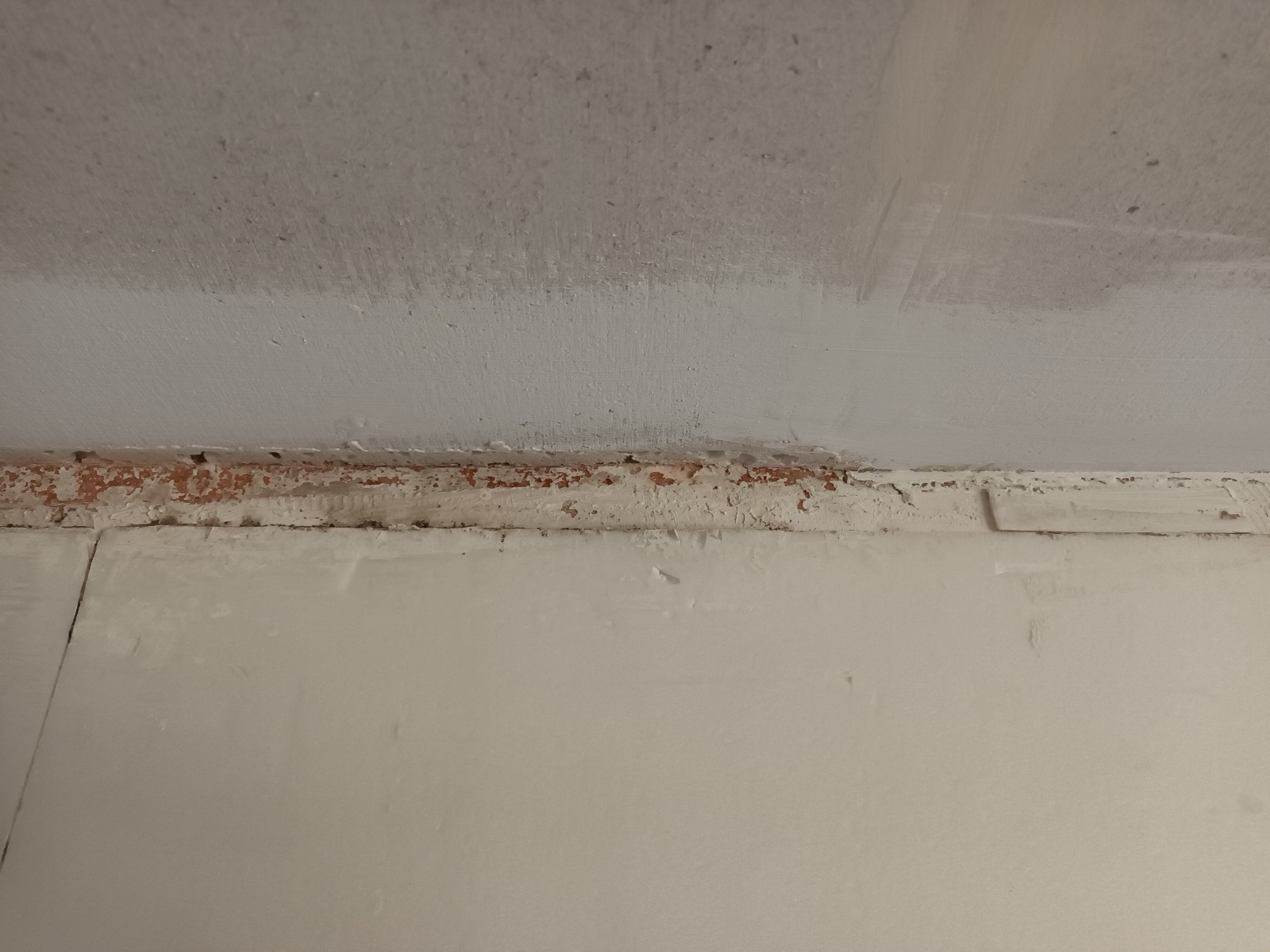

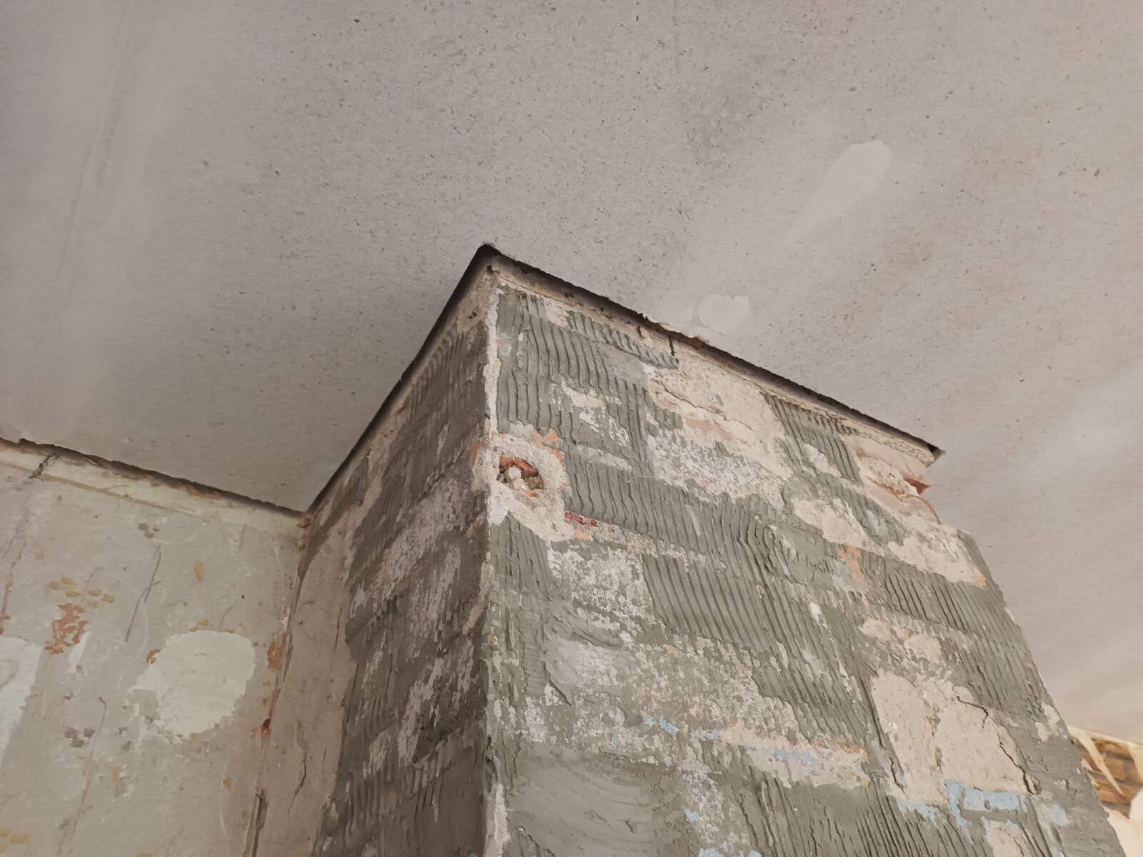

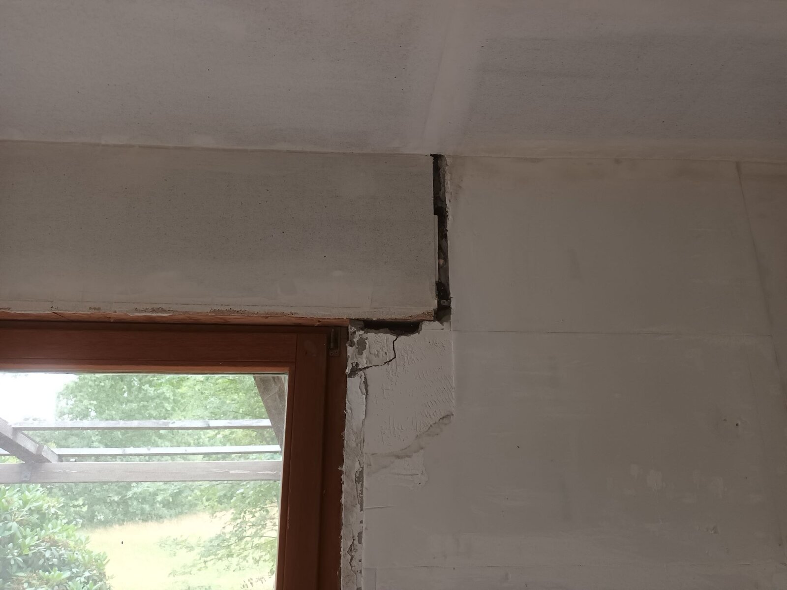

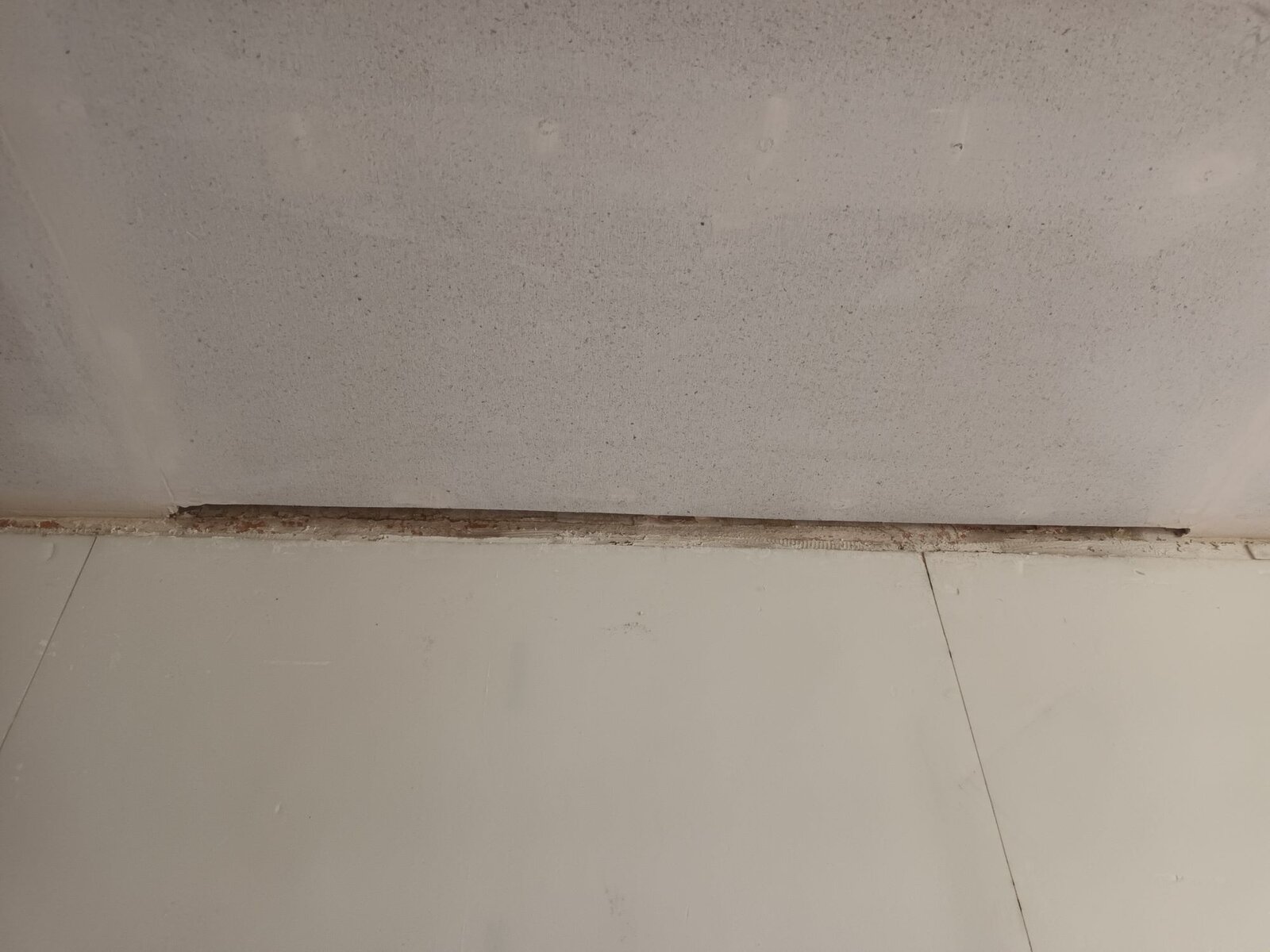

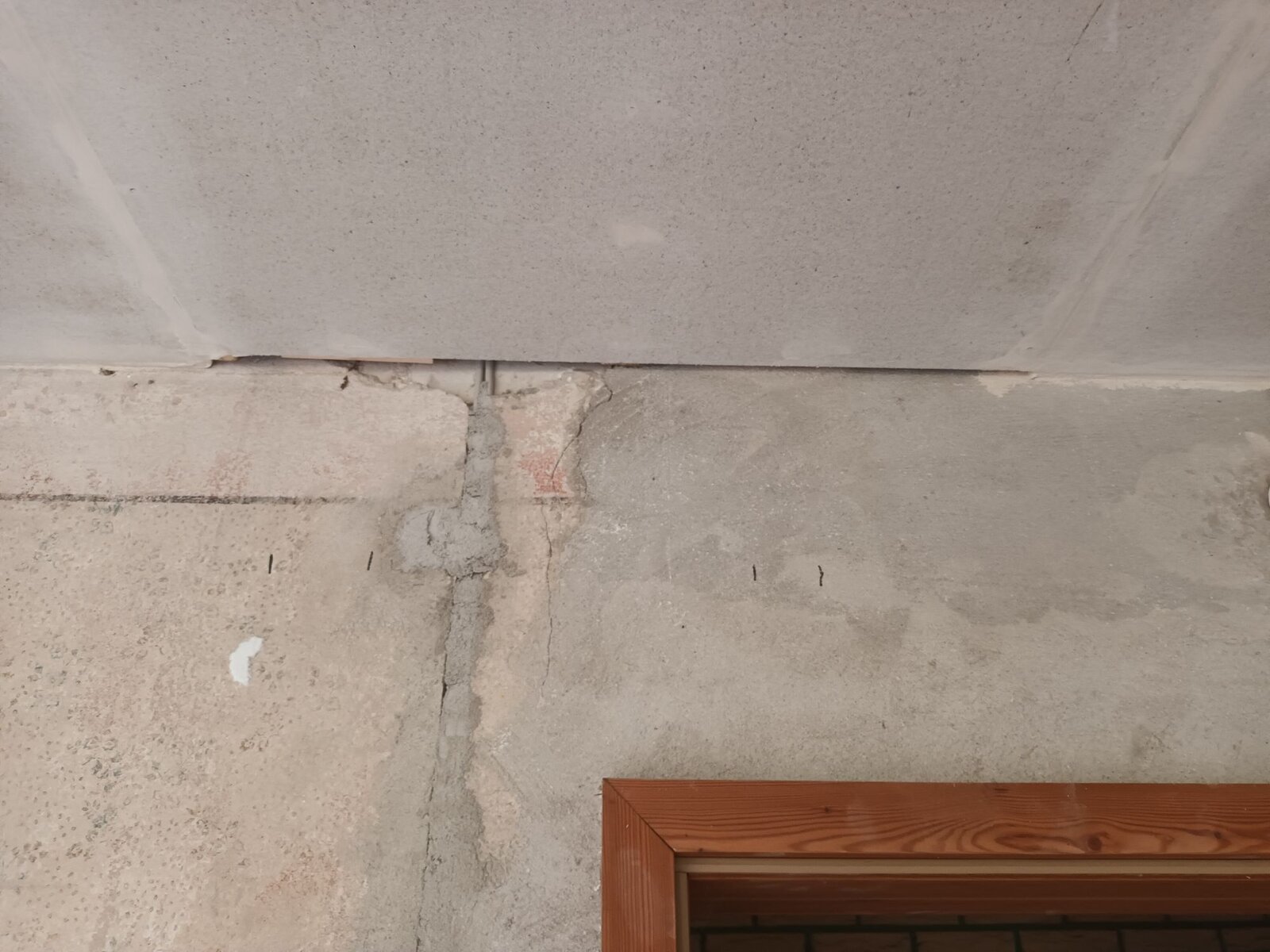

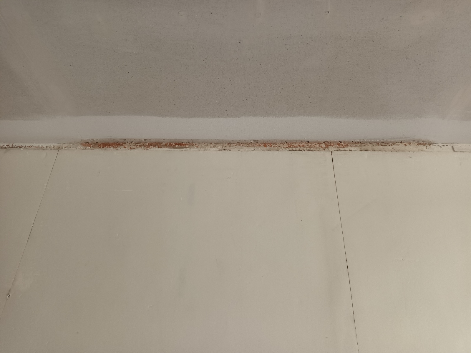

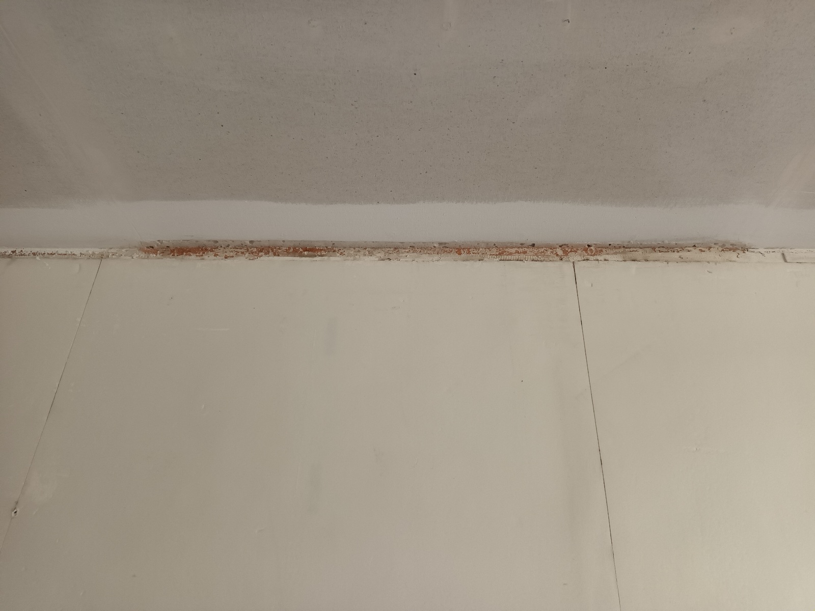

Expanding foam worked nicely. I used one that doesn't get super hard. And I cut it with a multi tool with the spatula tool connected. Cuts very cleanly.
