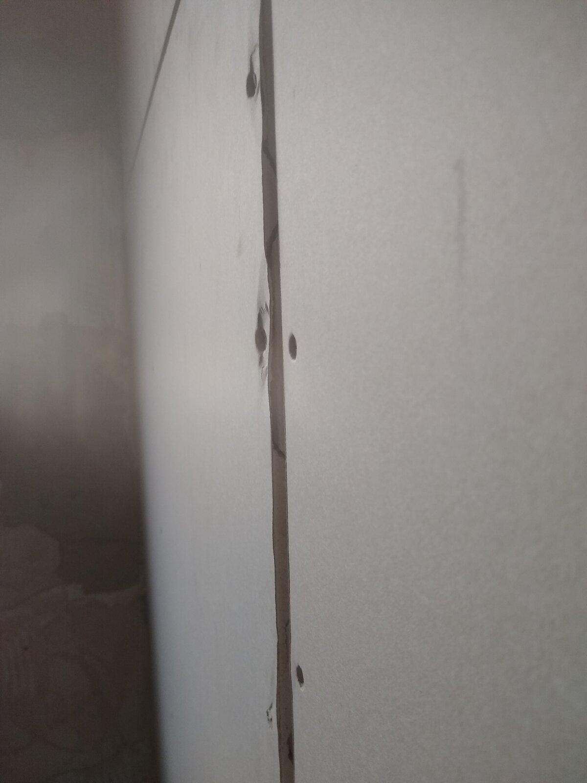

I've left some larger than i wanted gaps between some plasterboard sheets - how do i go about filling before skimming?
Also one of the boards has a lip of 3mm before the next one, how would you go about sorting this out? Just feather it in with next board along?
I will be using plasterboard adhesive tomorrow for one part of the room, could i just fill the gaps in with that?
In terms of applying scrim tape - do i fill the gaps first then apply scrim tape before the skim?
cheers
Take the board back off and close the gap, that board is protruding about 10mm going by the pic! i would try and level that out before filling.
