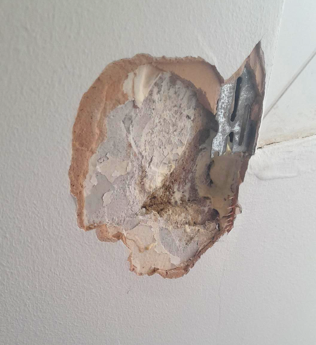

Good Morning,
What is the best way to go about filling this hole?
Many Thanks
Slightly dampen surface first with water.
Use this in layers using old credit card or tesco card (don't overfill as more to sand off):
Use this to sand it down noting it will be disty so use a vac):
Note that the filled finsh will be flater than surrounding area so will not be 100% invisable.
