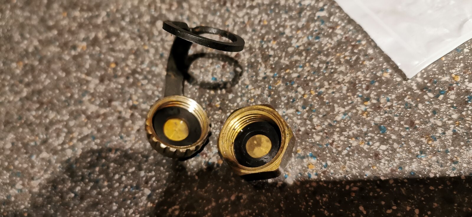

These are the two caps. This is what they were like when I took them out the first time. Should they both have washers in?
In theory, aren't the caps just for show as the valve should do all the work in stopping the water?
One has no seal ,and the other brass one looks like the wrong seal ,( too small a diameter)
Do you have any PTFE tape ?
As these valves are prone to not fully close in time ,the blanking caps serve the purpose of sealing what would be an open ended pipe.
I didn't have any PTFE tape but I found some washers that almost fit. Bit of a tight squeeze but they seem to do the job and no leaking from the caps! :)
