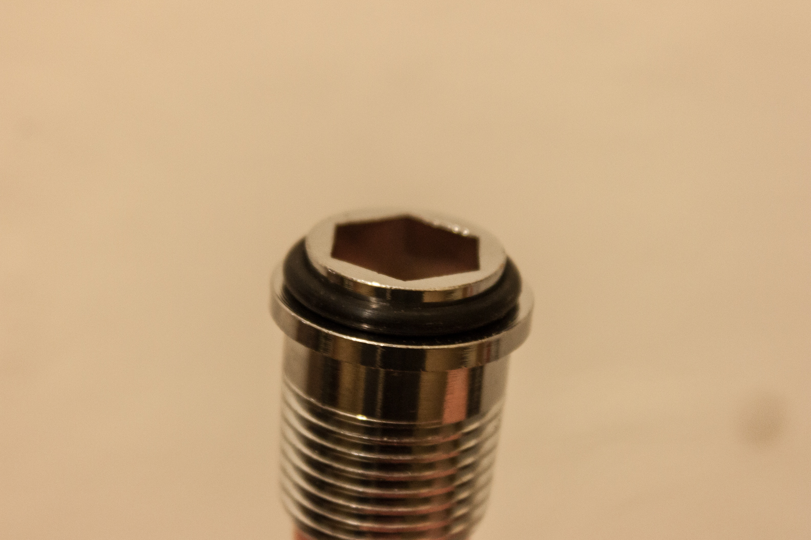

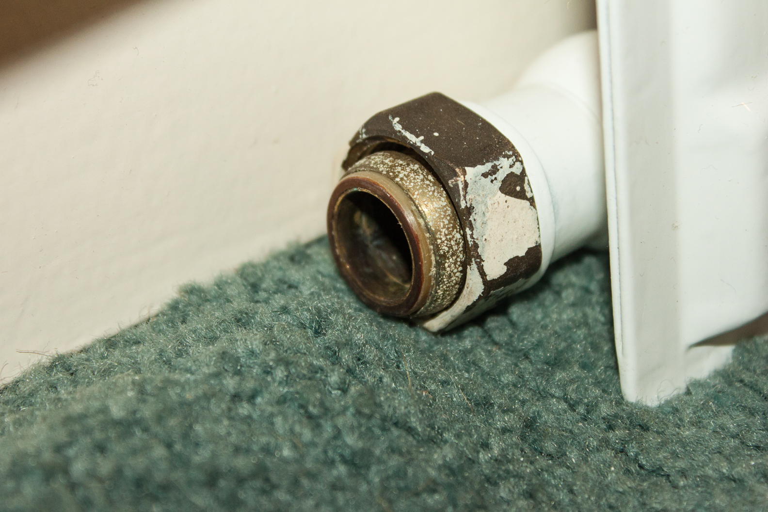

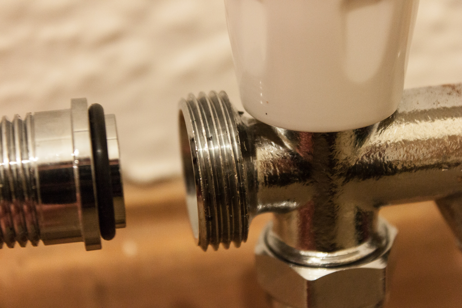

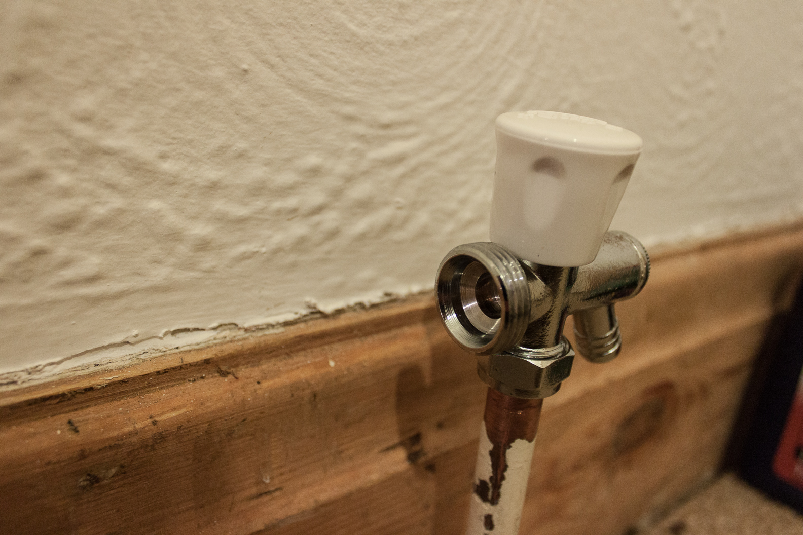

2) When reattaching radiators. It seems the older connections have a metal washer (see picture) creating a seal between the radiator and the valve. Does this create a good enough seal on it's own, or should I put some boss white around it? When looking at videos, most seem to just reattach the radiator without issue.
3) I replaced one of the valves with one with a drain off valve to make things much easier in the future. The radiator connection that came with it by default has a rubber washer/seal to make a good contact with the valve. Whereas as per above....the existing connection has a metal washer. I assume it is fine to keep it as it is.

You have two different designs of valve,one with rubber washer and one without. The latter seals without any washer or compound. It relies on closely machined mating surfaces.
So does that mean it is inadvisable to mix and match?
I assume that chances of them being similarly machined is low.
The radiator tail ,and the valve that is supplied with it ,are a pair. It wouldn't be good practice to mix one manufacturers valve ,with another manufacturers tail ,if that's what you mean by mix and match .
Thanks, yeh I was unsure....although....for some reason I am not really a fan of the rubber washer solution....how well are they regarded, any long term issues with them?
None that I am aware of ,having said that , rubber does not have infinite lifespan.
