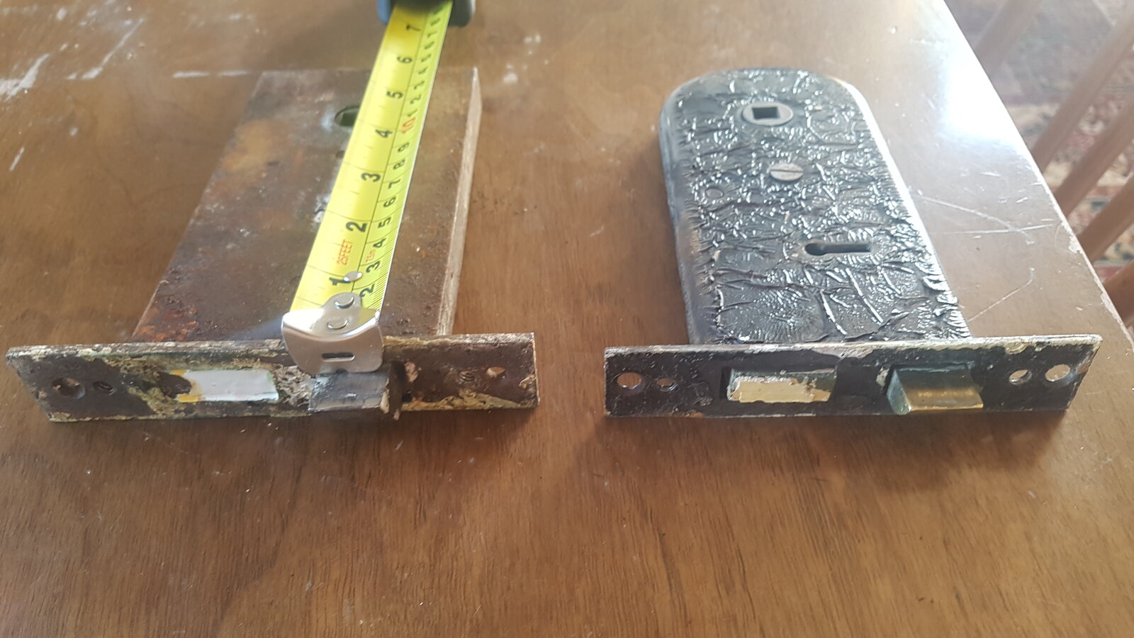

Any idea where I can source some 4.5 inch / 114mm backset mortice locks for internal doors?
I've had all the doors stripped and we want to replace the mortices and misc door furniture.
Struggling to find a 4.5 inch backset.
Closest I can find is a 4.2 inch (108mm)...
Advice appreciated.
you do mean backset? not case size?
is it a vertical
sashlock?
or a horizontal
sashlock?
or just a latch?
ah, those are quite small cases
the imperial case would be too big. But you could chisel out the mortice
the Union has only 101.5mm backset
I have some other brand here I will look at.

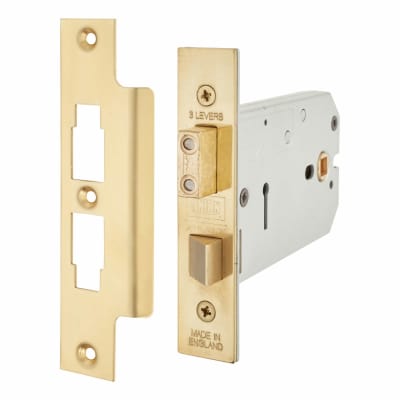

I think a modern case size to fit will probably be 5-inch with a 4 1/2" knob backset (about)
like https://www.ironmongerydirect.co.uk...-case-38-1015mm-backset-polished-brass-850745
A bathroom sashlock is very handy for bathrooms and bedrooms as it gives privacy
you may have to get the nearest readily available, and use the knob rose to hide the old marks on the door. Are you going to paint it?
Imperial 3011 also only 102mm
Looks to me like they have all metricated a 4-inch backset.
And you want 4 1/2"

Try a Union 2077 or 2026 five inch 127mm, or the Fulham.

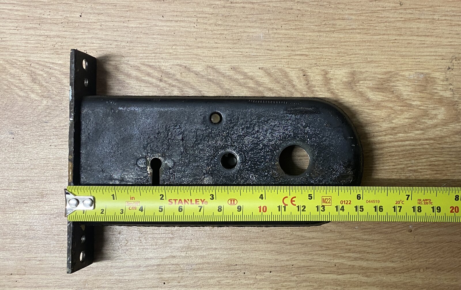

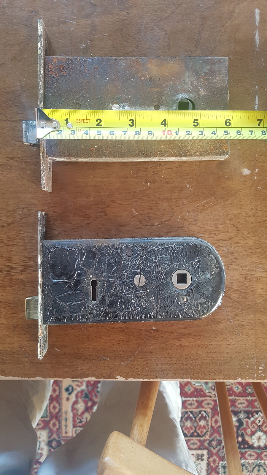

Sorry to bump a (very) old thread but I am also having this issue and jacko555 seems to be the only other person on the internet with the same lock as the one I've pulled out of a door in my house!
The bottom one of the original two two (the black rounded one) looks exactly the same as my ones and I'm having no luck at all finding a replacement; I was wondering if jacko555, or anyone else, had ever found one (or what they did instead)? There isn't anything seemingly unusual about my house (1920s UK build) so I am finding it slightly strange that I can't seem to find anyone else posting about this before..
Any advice greatly appreciated. Cheers

What, precisely, is the backset on your lock?
Hi JohnD,
Thanks for replying, looks to be 117mm to me (so 4.6 inches). I’ve attached a photo so you can see, also shows the similarities to jacko555’s. Mines been opened so missing some of the bolts etc but it looks the same to me?
