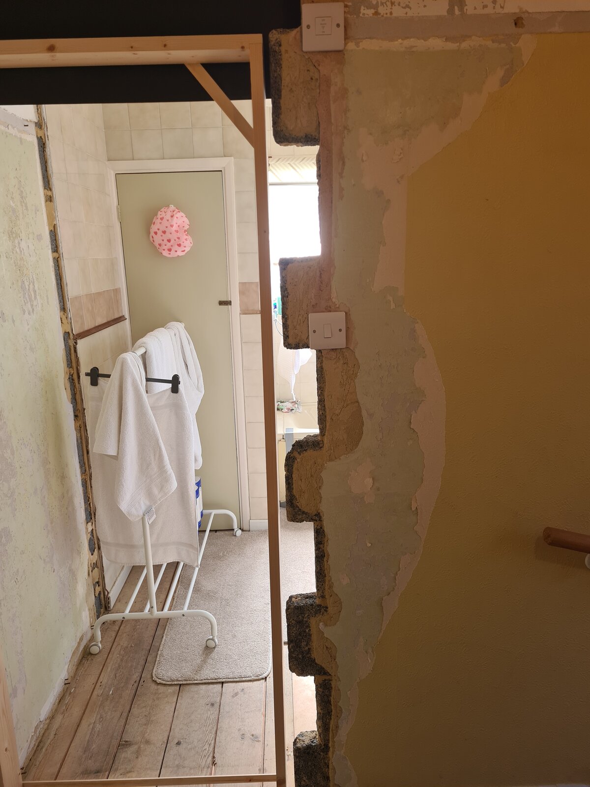

Evening all,
We brought forward the bathroom entrance but not too sure what is the best way to finish the wall next to the door lining? I do have a few of the grey bricks left which I could cut to a better fit but that still leaves me with some holes. Photo attached.
Infill all the gaps with masonry before fixing the lining to the masonry, even if that means buying a couple of blocks
Thanks for the reply! You can't seem to buy these blocks anymore, they're really slim (like 2.5" thick). I wasn't sure if just shoving a brick in there with some mortar would hold up in the door slamming regions
Brick with mortar should do. Having access to the brickes' masonry saw on site I tend to forget how fortunate I am
