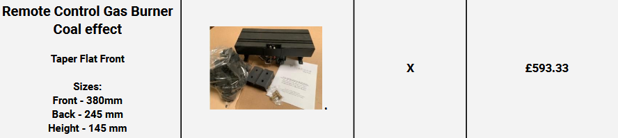

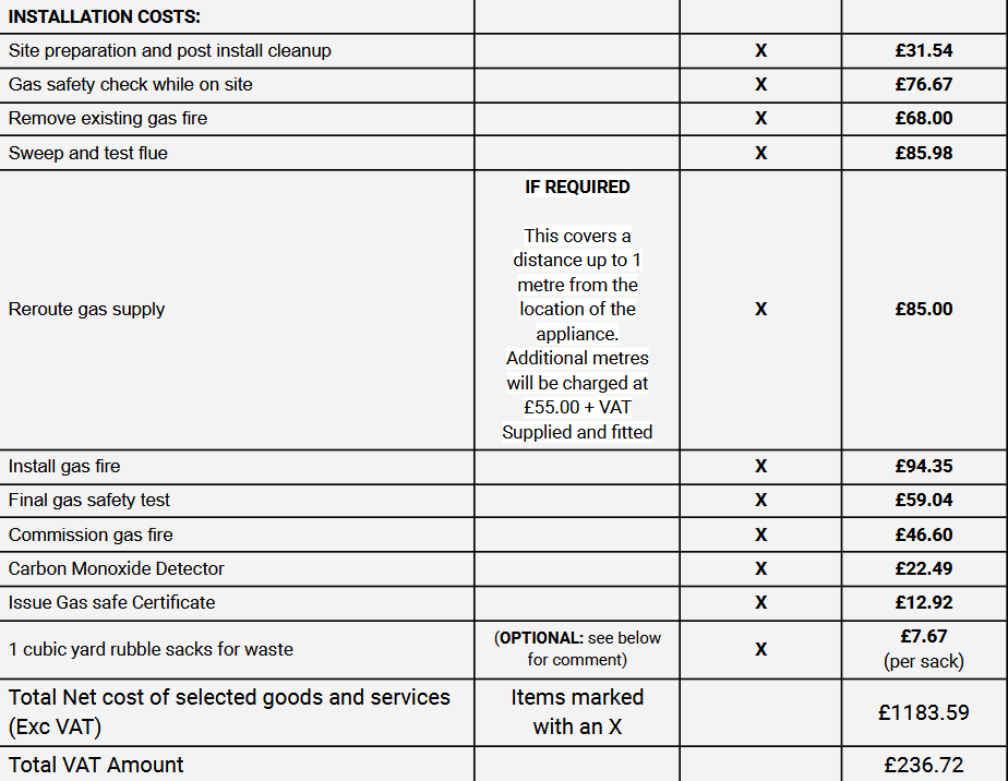

She showed me this quote for the works to give you a better idea of the situation.

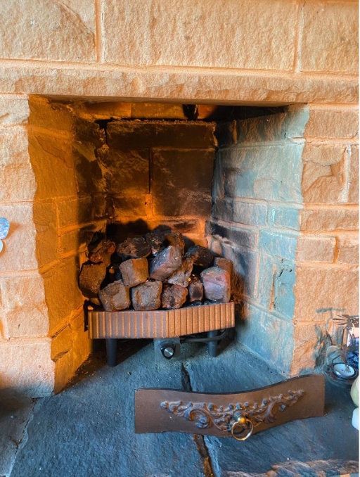

Existing fireplace, the replacement will be the same. No fancy stove or anything.

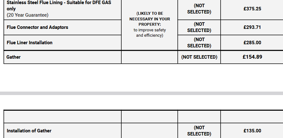

So I think, even though it says "not selected" for the additional items, they have since been added to the job. At the very least the items other than the gather and gather installation.
Which is why the job is looking to be around 3k all in.

They are aware that it is essentially an open decorative gas fireplace (they like that aspect of it). They are also somewhat aware that it will be comparatively inefficient to run, with a lot of wasted heat.
Here is a higher resolution image. I will also update the original post with it.
They are aware that it is essentially an open decorative gas fireplace (they like that aspect of it). They are also aware that it will be comparatively inefficient to run, with a lot of wasted heat.

I think the 3k-ish quote comes from the total of that first part of the quote:
£1183.59 + VAT = £1420.30
Then assuming they are doing the additional flu and ancillaries
£ 1243.85 +VAT = £1492.62
Total £2912.92

How do they know what is required when edf didn't give the reason for de commissioning the original. Get more quotes including ones with out a flue liner, if its lasted this long, and is swept regularly, with CO detectors in place, and a safe supply pipe, what could go wrong.
A lot of the quote is based on if required, so the potential engineer is likely covering what could be needed, then they’re not hitting the customer with added extras. As for the fire (no idea haven’t seen many), is in fact a dfe then a permanent vent is often needed of 100cm squared. As suggested, maybe obtain more quotes. As for EDF - was a warning notice and label filled out and was permission sought. Why was it condemned?
getting totally rinsed
charging for putting down and lifting dust sheets
gas safety check while on site , ........would like to know what they mean by that
disconnect fire 68 quid . .....60 second job to undo a nut and couple of mins to remove 2 screws
. Final gas safety check / commission gas fire this is part of fire installation
gas safety cert is 3 quid to be sent from gas safe .
. get someone else .
