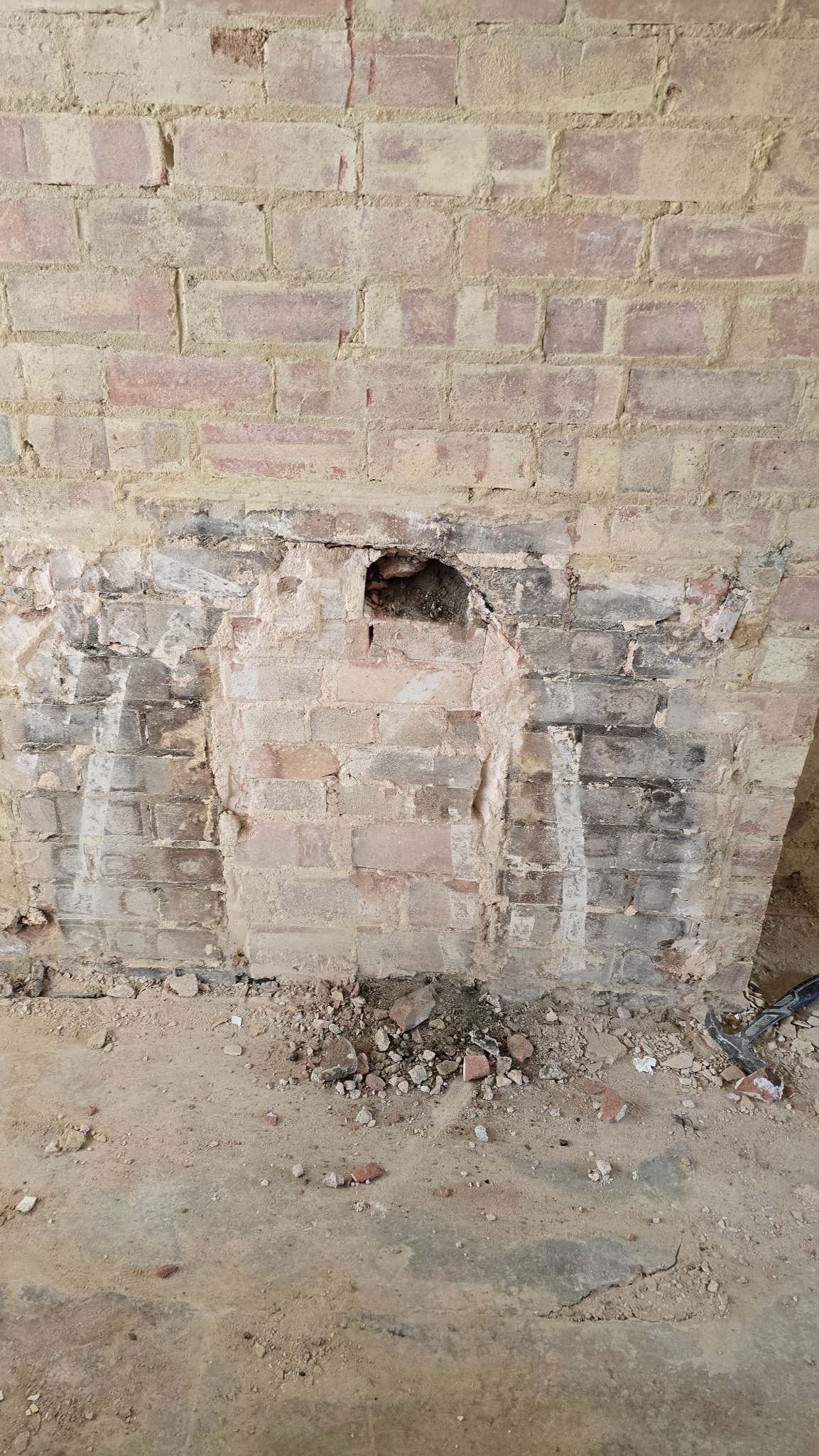

Good morning all
I am looking to restore a fireplace in my house. As shown in the photos, it has been blocked God knows how long. I have taken one brick out to see what is happening and a lot a black sandy material started to come out. I am planing to take out just the bricks in the middle as I do not wnat to affect the integrity of the chimney breast.
What options do I have to make it 'live' and making sure not to burn down the house?

You can remove those bricks and see what's behind, it will likely be a flue full of sh#t.
A decent vacuum cleaner should be your first port of call!
A 'builders' one with a shiny metal canister, or a Henry.

Looks like there was a standard grate and fireplace there at one point, judging by those soot marks and metal brackets. It could be renovated but would likely need a liner too.
