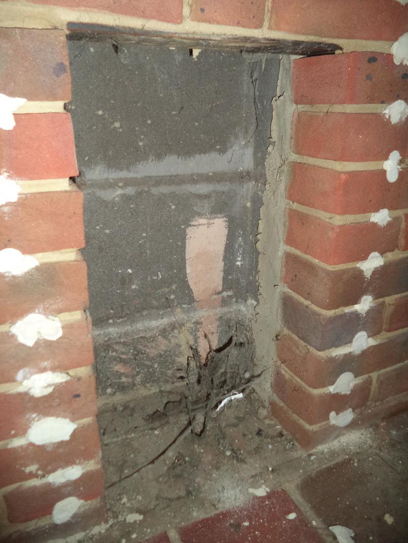

Hi,
I was hoping somebody would be able to help me, as I have entered the minefield of gas fires!
I have removed an old-fashioned brick built fireplace and gas fire that sat on a hearth and revealed an opening of dimensions: 320mm width x 600mm height x 110 depth. This supplies a pre-cast flue of which I'm informed follows old regulations, as the house was built in 1985. I believe the regulations changed in 1986.

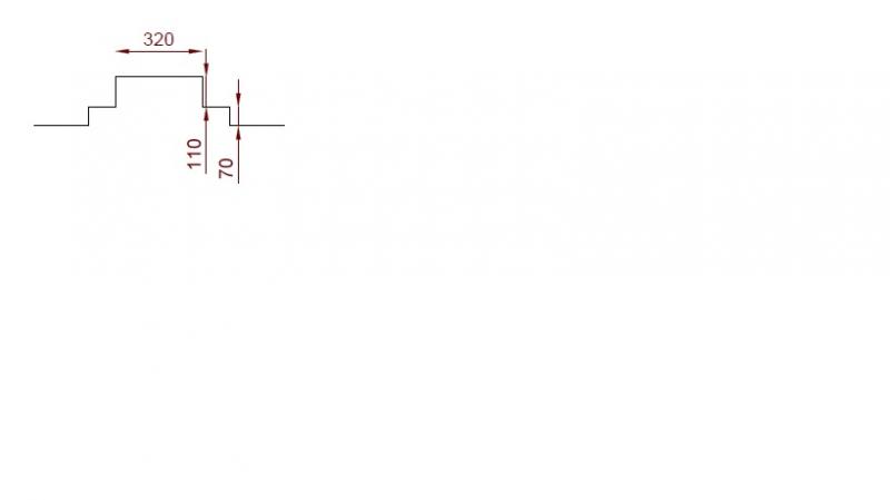

With a limestone fireplace surround with a backpanel of 70mm depth I believe I have the dimensions in the attached image to play with.
I am keen on an inset gas fire and have found the following: http://www.bfm-europe.com/data/downloads/B-131100-06.pdf
Do you think this is able to be fitted? If not can you recommend any other inset gas fires that may be able to fit.

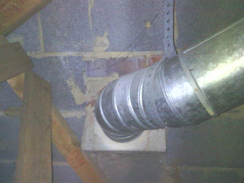

I have measured the circumference of the flue pipe in the attic and it's 480mm (or 150mm diameter) on the outside. The photo shows it entering the attic.
Get a brochure from your local stockist and ask for class two flue applications and look for business cards on their wall for a suitable guy :wink:
Thanks for your help.
So am I right in thinking that I have a Class 2 Pre-cast flue? Will there be any limitations on what fire I can have based on the dimensions of my flue?
