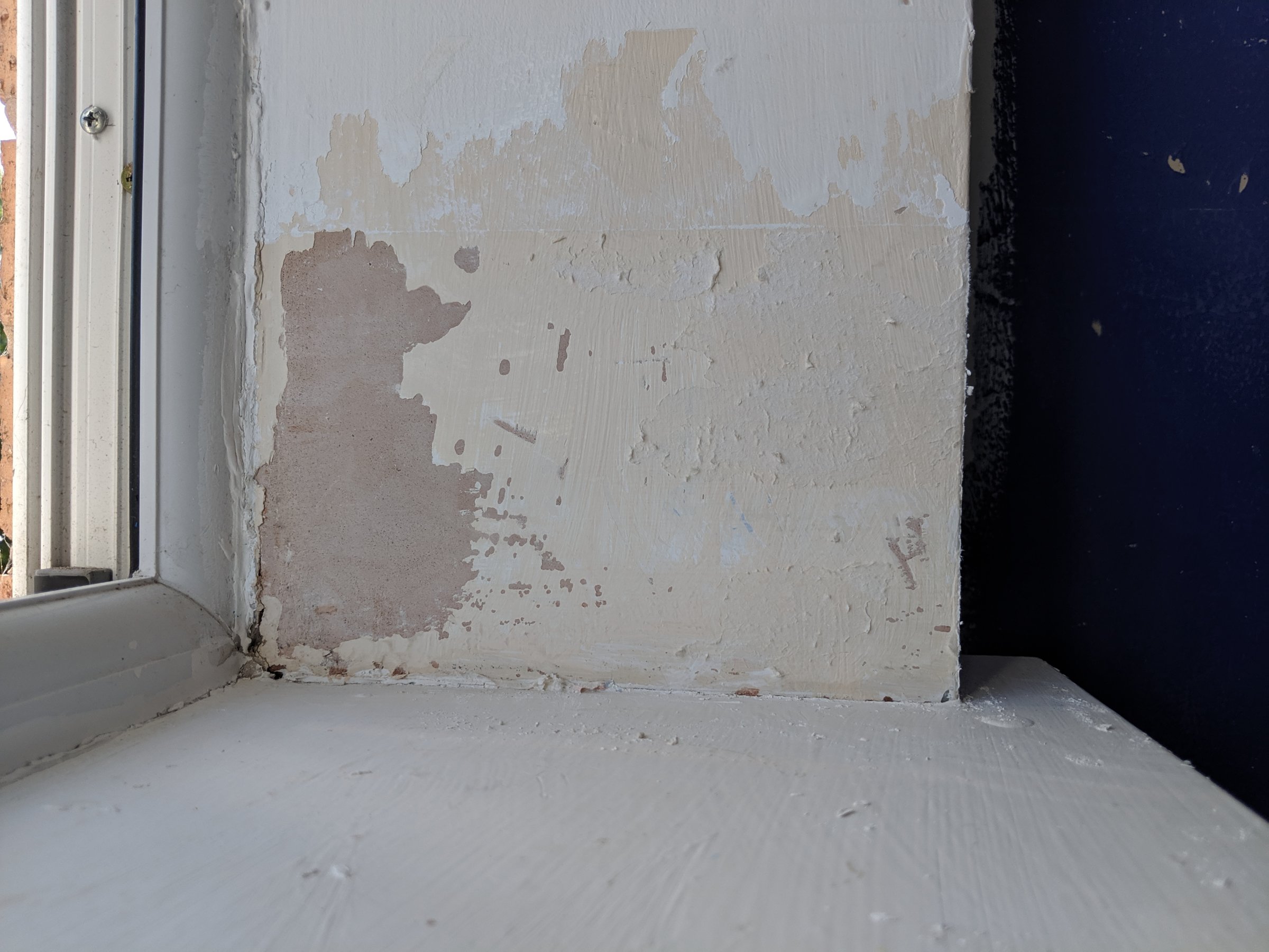

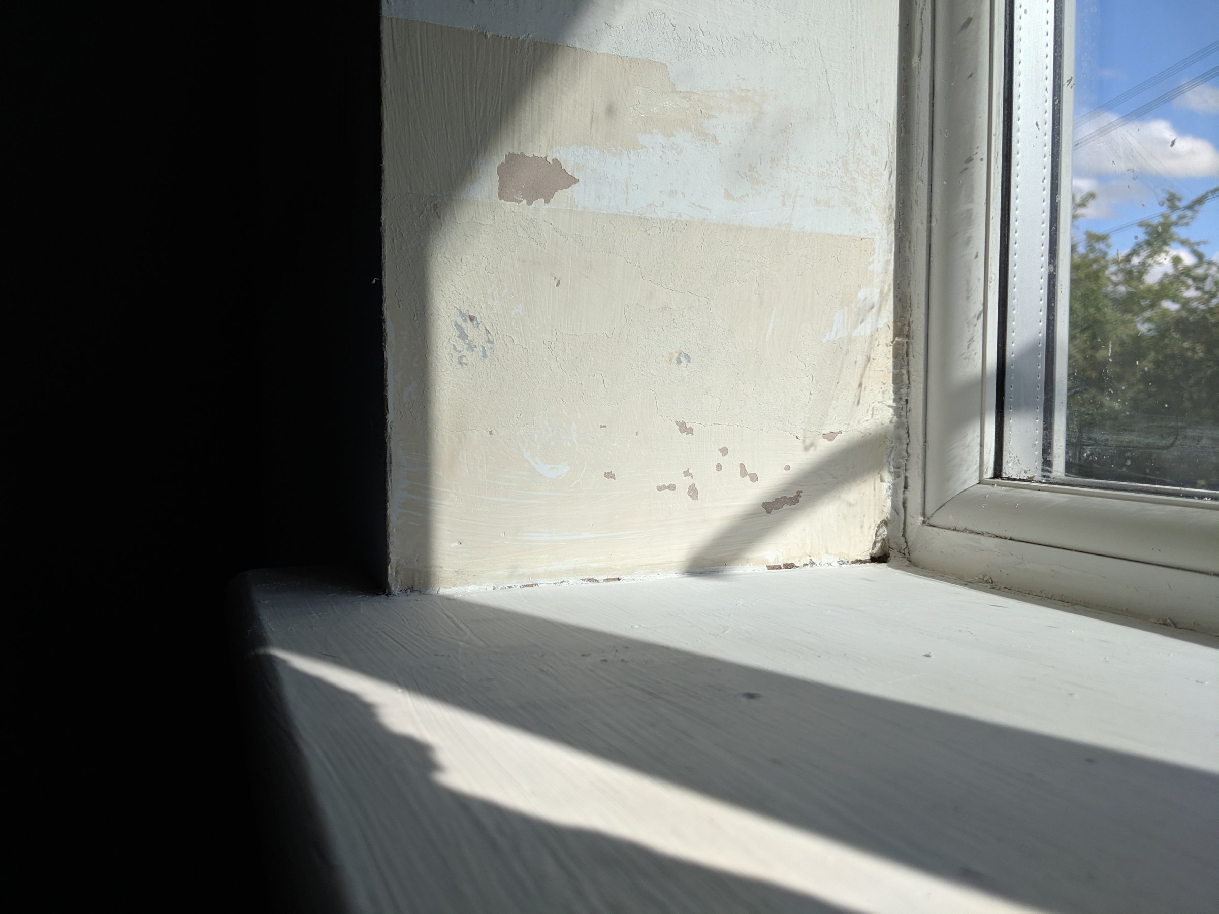

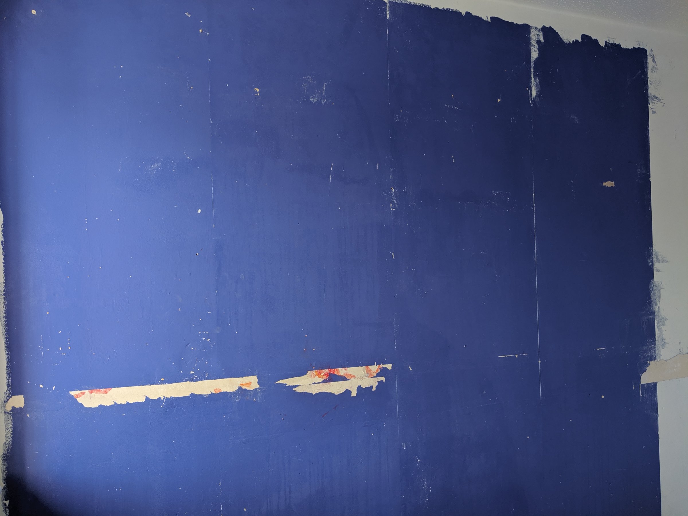

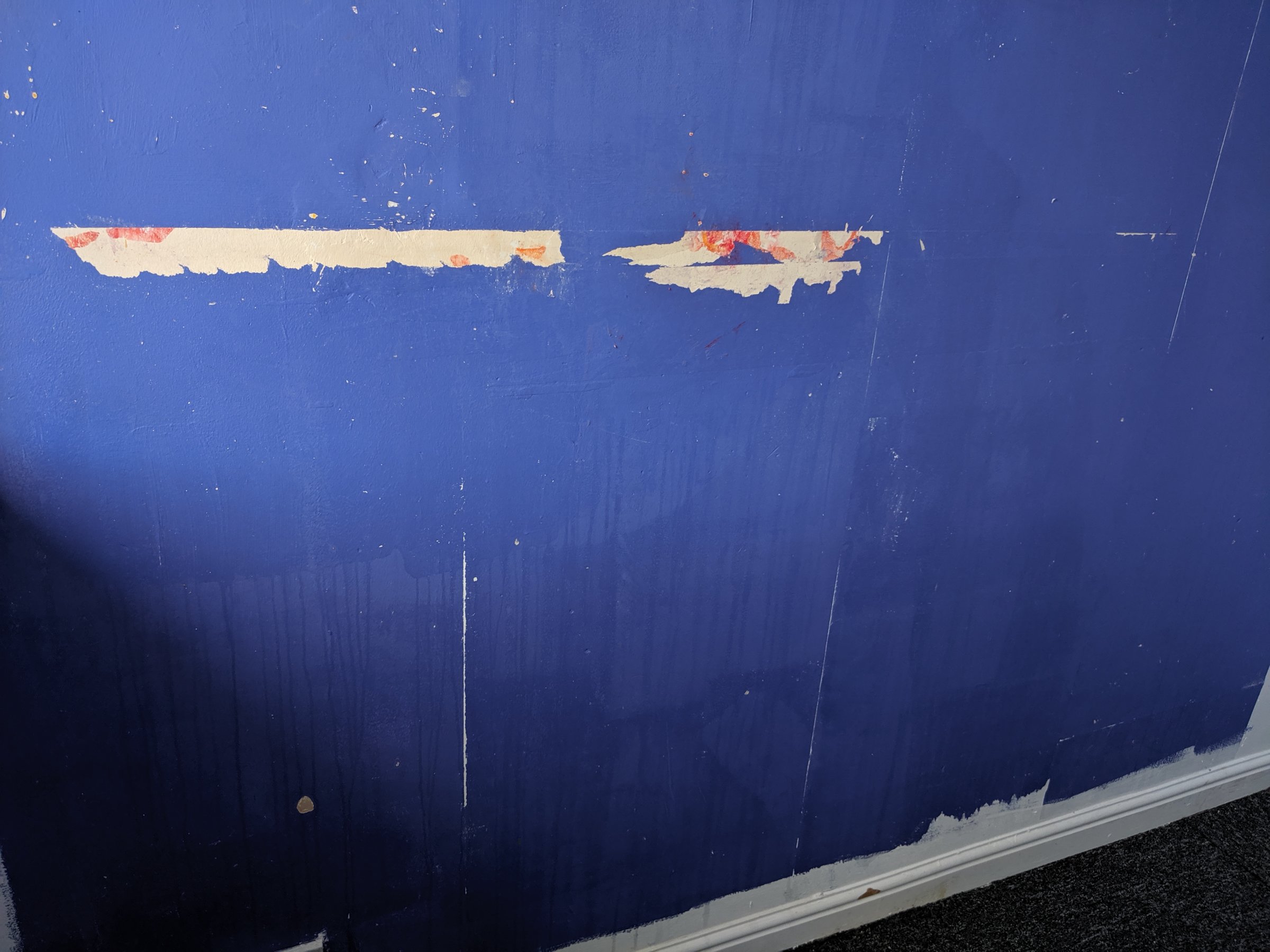

Hi. I'm new to the forum and new to plastering/skimming. I likely need to deal with a few rooms but making a start on the small box room first which is a bit of a mess I feel. I've removed some lining paper that had very big bubbles under it and looked a mess. There's also a stick on strip around the room but it's difficult to remove. I've taken care of removing any loose bits that might cause an issue I feel.
The process I'm looking to follow based on my research is to use a PVA/water mix (2 coats?), a bonding coat and then multi finish. I'm looking to use a trowel to apply the plaster and a SpeedSkim to make good and level.
Seeing the pictures below to get an idea of the current state of the room would this be the best approach and is there any advice I should follow?
Tony
Where are the deep bits that need bonding? Looks like skim only would do the trick but can’t see the pics too clearly. You could use a speedskim to flatten, but not as a substitute for knowing how to use a trowel.

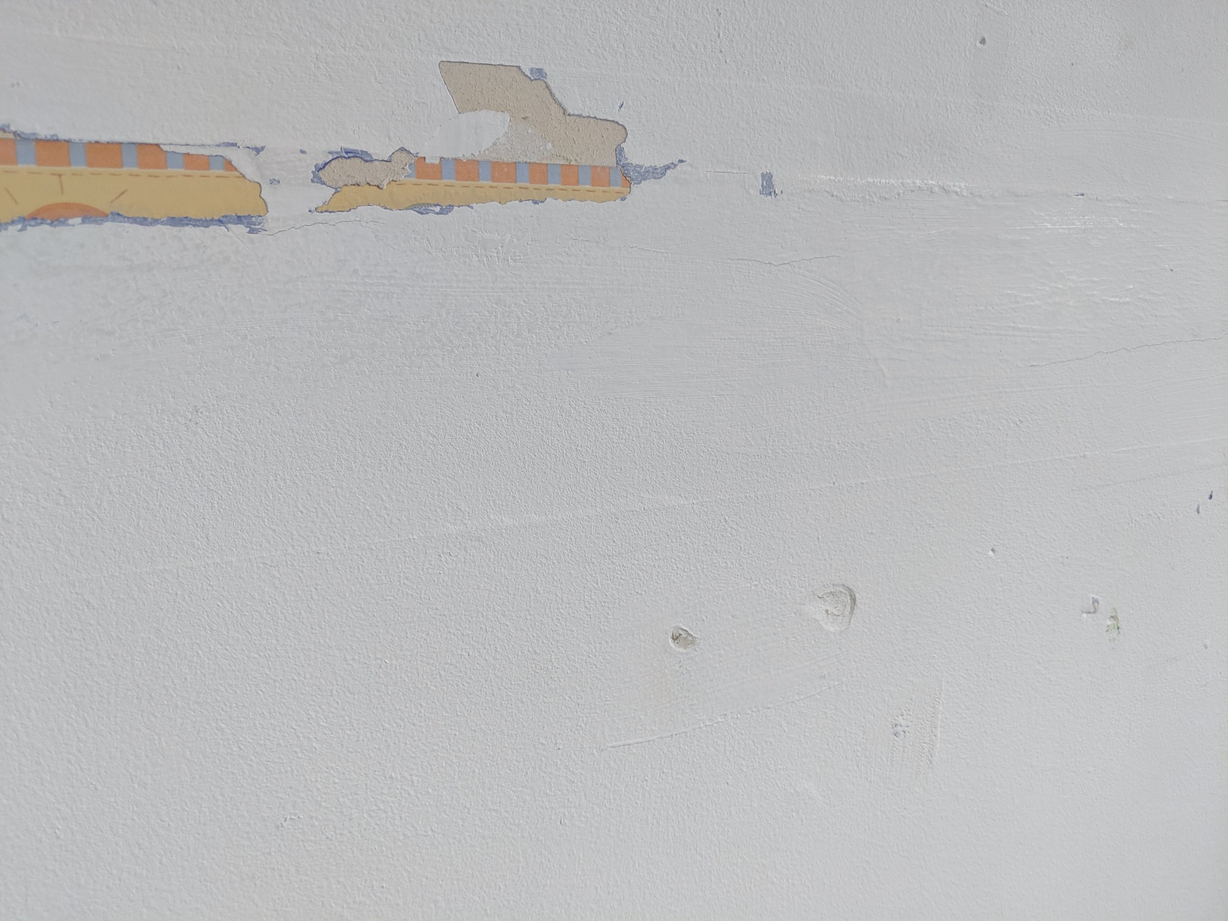

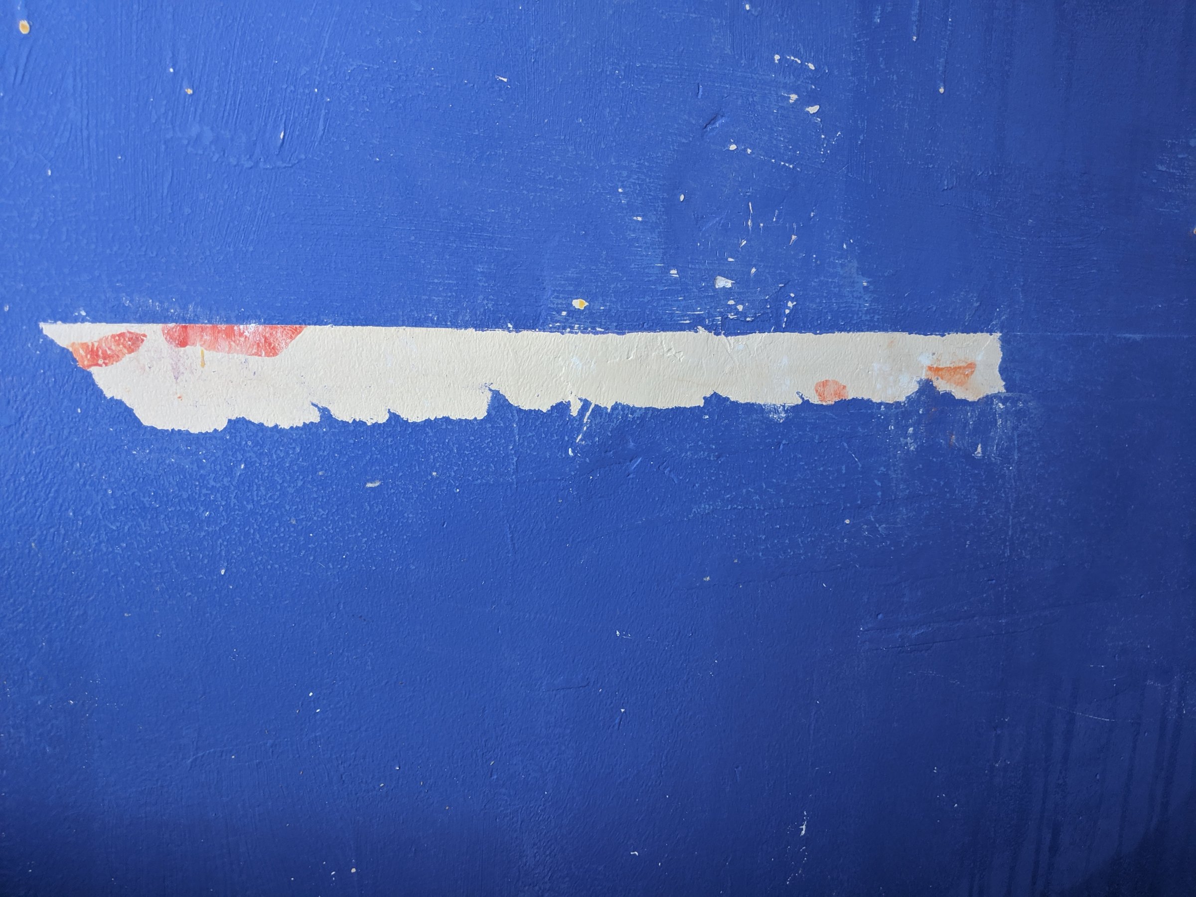

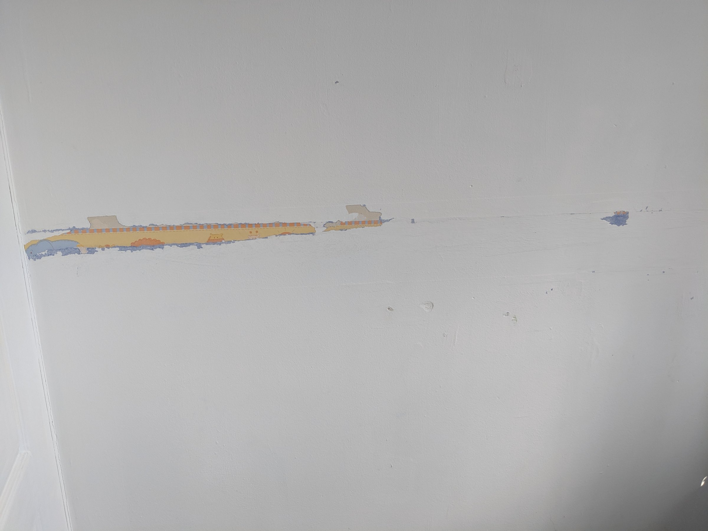

Thanks for your response.
There's a few little indentations such as where the door handle has hit the wall and on the wall where the lining paper was the wall is generally just full of smaller imperfections like bits there filler appears to has been used and not flattened, there's some naughts and crosses marks on a wall made with a knife I guess. It's those types of imperfections I'm talking about so nothing too serious. I've seen the recommendation on a few forum threads to use a bonding coat where adhesion is an issue and since I'm dealing with painted walls with stick on strips I'm unable to remove and filler and so on its unknown to me what adhesion will be like so I thought it would be best to assume the worst and use PVA, followed by a bonding coat and then multi finish. Are there any negatives to this or are you simply implying it might be over the top?
It’s the pva that will provide the adhesion. Bonding (coat) plaster is a backing plaster, for deeper coats like on bare block or levelling up uneven walls.
So pva and skim is your best bet. Skim when the PVA is tacky.
Thanks for the advice. In terms of time I've got free this week I'm looking to apply the PVA Friday after work between around 5pm and 6pm. Would I be ok to make a start on skimming at around 10am Saturday morning or does the PVA need less or more time than that before skimming?
You normally pva just before skimming, so you can skim when it’s tacky. But you can skim next day, as long as you keep an eye on the suction when you pva it.
