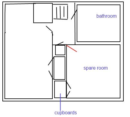

My old man suggested going in the loft and checking if the right lining leg was all the way up, he mentioned that they are in his house except that the void above the doors is plasterboard (on his).
He mentioned the walls could be in someway tied in due to its location. Its the red line in the diagram below. Do you think this is likely?
Certainly go up and have a look and post the results back here...pinenot :)
Looks like it goes all the way up! You can see the light switch wire that runs down the side of it.

One good/bad thing, depending how you look at it, it's not load bearing as such, only load appears to be the brick infill which could be replaced if you wanted to. As for the state of the frame, it's not to bad, some paint stripper required and making good the old lock keeper (by the looks) That would allow you to retain the brick infill and plaster etc., in other words the choice is really yours...pinenot :)
