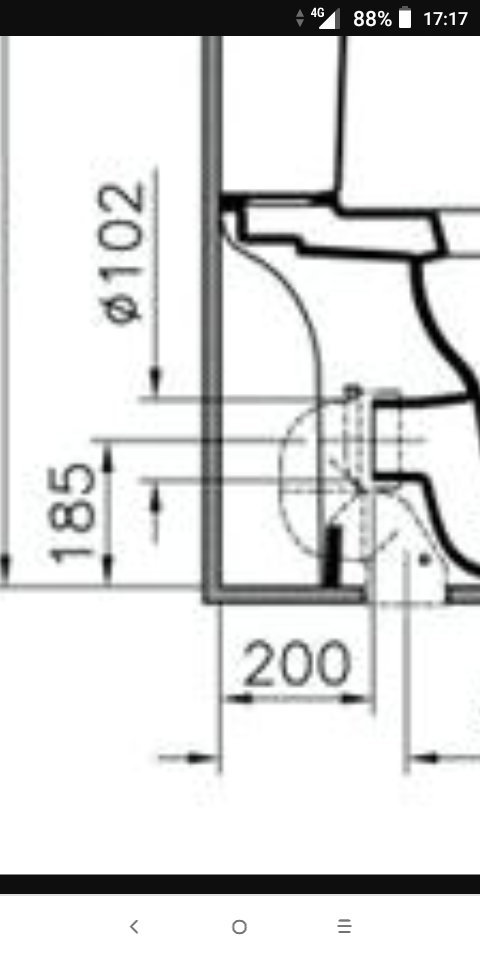

The soil pipe sticks out the wall 120mm but the measurement on the diagram is 200mm. Can the pipe be extended somehow?

Yes ,pan connector extensions are available.
Your pic shows a pan connector that is angled ,down into floor.
Don't know what relevance that is ,if anything !!
