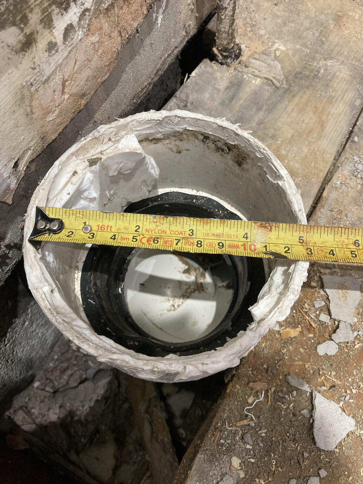

Hi I’m replacing an upstairs toilet and this is what the pan connector goes into, but had a huge bead of silicone around it to fill the gap. What do the pros usually do here?
Yeah the pan connector pulls out of the elbow. It does seem to fit well before the elbow widens to 125mm. Is there a much wider pan connector? Or suggest remove the entire elbow from the soil pipe?
You say the pipe is 125mm, not standard 110mm (4") soil pipe? 125mm is a very unusual size. Take the extension out of the elbow and post a pic, is that opening (socket?) not 110mm? If so then that elbow socket would usually just take a small piece of pipe then a normal swan neck pan connector would be used.
  • Thanks
Reactions: Hpd
Thanks for the info, it is 125mm yeah which I thought was odd… and now you’ve explained how it’s normally done it definitely isn’t standard!
I had to crack on with the job and decided the pan connector fitted snug into the socket and has worked well for 30+ years so just replaced it with a new one and all works great.
Still unsure why it’s that size socket/elbow but the toilet hides it anyway (which it didn’t before) so happy days
