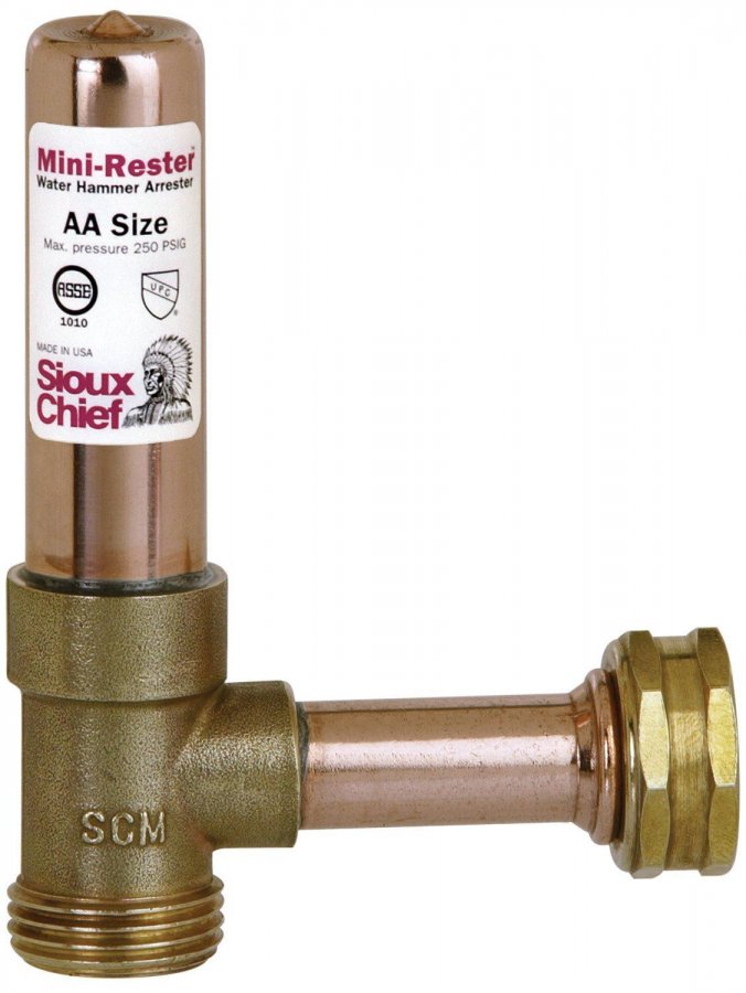

    I want to fit a water hammer arrestor
    http://www.amazon.com/Sioux-Chief-Mfg-660-H-4-Inch/dp/B000H5MQNM
    Picture is appended below.
    It has 3/4 inch male and female threads to connect to the washing machine valve and the washing machine hose. Likelihood is that the threads are American. Can anyone please tell me if this will mate happily with our UK 3/4 inch BSP threaded connectors.

    Thanks for your reply. The 64117 has not helped. The model I am considering is mounted on the machine itself and has a better chance of absorbing the shock. To install it, you undo the hose at the washing machine end and connect the female end of the arrestor directly to the washing machine. You then attach the hose to the male end of the arrestor. When the washer stops taking water, the momentum of the flowing water pushes the piston (the piston is in line with the incoming water) in the arrestor. I think this model mounted in this way has a good chance of arresting the shock.

    I remember reading that while many countries use BSP the US uses NPT I found this there are minor differences in the 3/4 pipe Dia it might be possible to interchange them with a bit of
    "graunching" but they are not exactly the same.
    Have a look at this chart.
    https://www.valvesonline.com.au/references/threads/

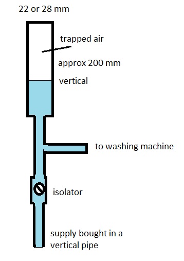

    For a washing machine a home made arrestor will normally suffice
    After time the trapped air will have dissolved into the water. Then close then isolator, loosen the connection to the washing machine hose to drain the water out of the 22 mm section. That replaces the trapped air cushion.

    Thanks. If all else fails, I will try this. Only reservation I have is the periodic draining of the tube, but it sure is a simple and workable solution. Indeed I believe in the USA many homes had these built into the plumbing systems.Another alternative for me would be to revert to my low pressure system.
