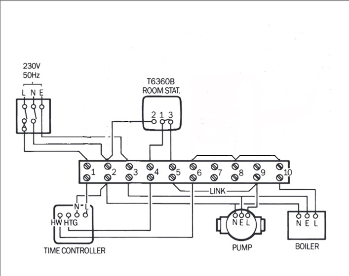

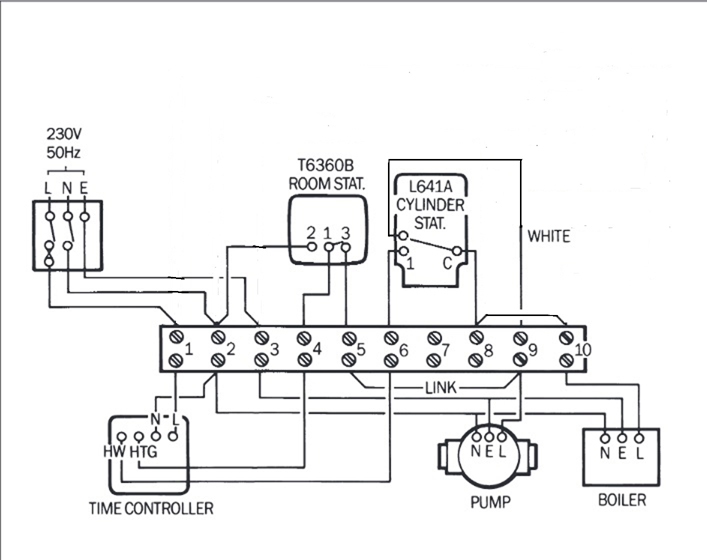

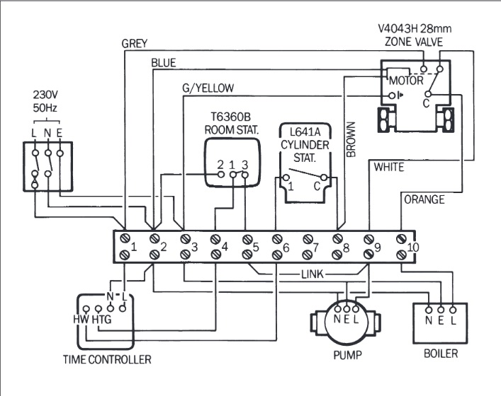

The C Plan has three basic versions as it was developed through the years. C-Plan_old2.jpg C-Plan_old.jpg C-Plan.jpg Original had no tank thermostat, that is what I have, then there was a tank thermostat for summer use, and then tank thermostat with a motorised valve.

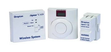

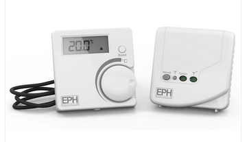

I was advised with my oil boiler that to fit the motorised valve puts a strain on the boiler, so should not do it, since I am an electrician not a plumber can't say if that is true, the centre system needs a cable to a tank thermostat, or of course wireless, I actually fitted a wireless thermostat to my dads C Plan but when I came to fit one here, could not find any for sale.
