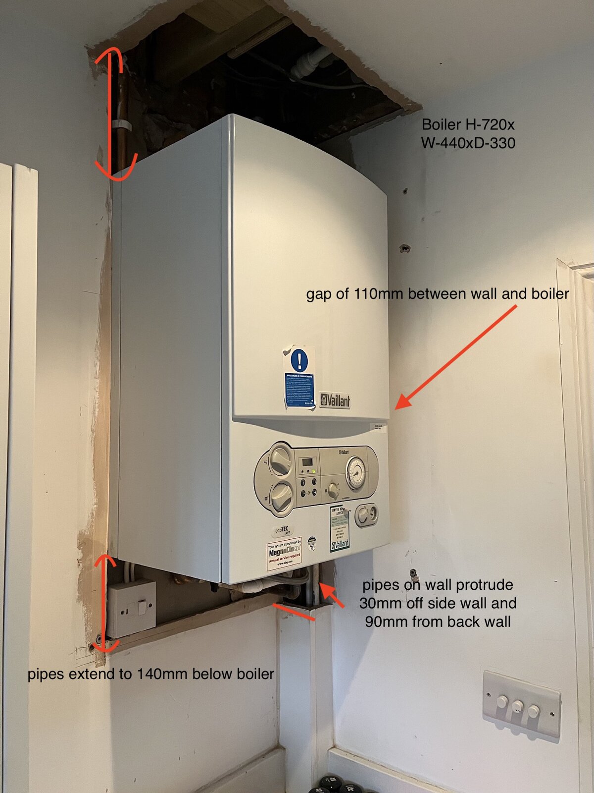

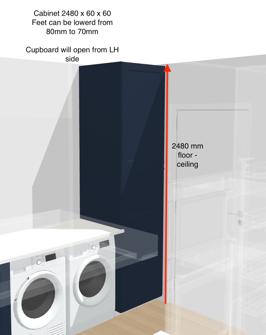

1. Covering the boiler - the boiler stands from the ceiling 2490mm down 1200mm (inc. pipes). We'd like to put a full height unit over it so we can make use of the storage underneath. However, the height would mean only 10-15mm to play at the top of the cabinet (for opening door) and I'd have to modify the cupboard to ensure it's sufficiently supported and stable. Easy access to the top of the cupboard is critical as the Magnaclean pushes into the ceiling void. Does this sound doable or is there something I'm missing? I know the Ikea legs can be dropped from 80mm to 70mm, so that gives a little more wiggle room.

Difficult to comment on boiler , need photo and accurate dimension of boiler and cupboard.
hope this makes it clearer. The graphic is what we'd like to achieve, a 2 door cupboard which allows to keep the boiler closed when not needed. Also disguising the space above the boiler and the magna clean, whilst allowing access when needed.

You can use an infill section to hide pipes to right . The cupboard will be short of the ceiling but you can make up a U section to sit on top , set back slightly, to take it up to ceiling height .Can be kitchen panel to match or mdf or plasterboard on frame painted to match walls .

I would really like the 3 tall cabinets to be full height (boiler, larder & oven). However, if I were to do this, I would only have about 10mm height to play with on either side of the kitchen. Would this be something that you'd consider too risky? I know it won't be that easy, but aesthetically it will look much better.
I've been searching online to find Ikea compatible legs that goto 60mm, 10mm lower than the Ikea Metod legs. Any ideas?
