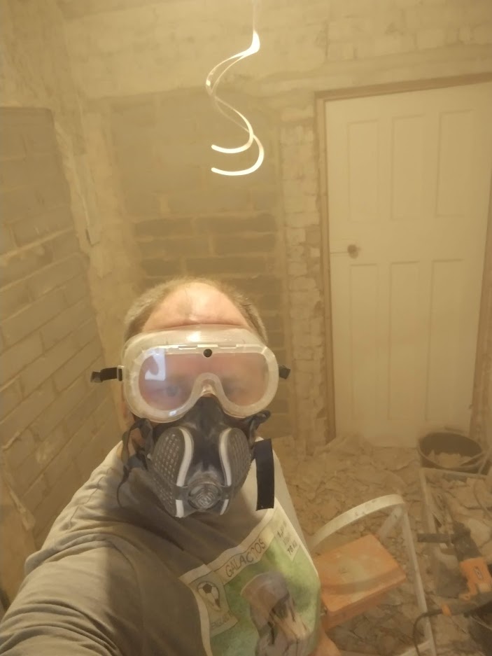

Yeah, I didn't bother taking plaster off my walls when I put insulation up. Only rooms I removed plaster was old kitchen and bathroom, as I knew these had been damp and mouldy so wanted a fresh start. Also, the foam adhesives stick much better to plastered walls than brick if you use that method.
Removing plaster is very very dusty!
