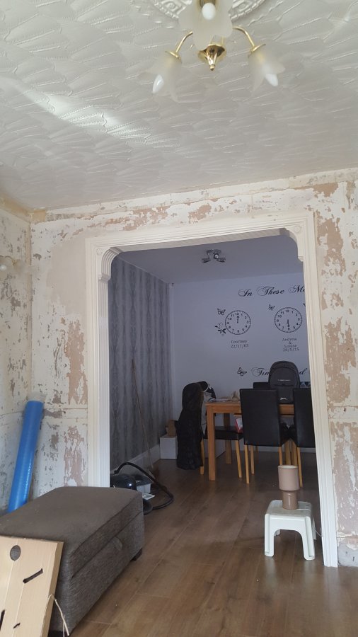

Hi if you can see in the picture I plan to put double doors up in the living room in the near future once all decorating had been finished.
Given the odd shape of the door frame would I be able to buy doors and get a joiner to fit to suit ?

Assuming you wish to retain the top moulding detail, you'd be better getting them custom made- even if you did manage to find ready made that size.
I suspect that the wall beside the door frame on each side is less than half the width of the doorframe ?
My brother's house is like that and the doors hinge in the middle - so it's actually four panels that fold out to the walls.
Do some measuring first.
You might be lucky and find ready made "original" salvage doors that a chippie could alter but get someone you trust
