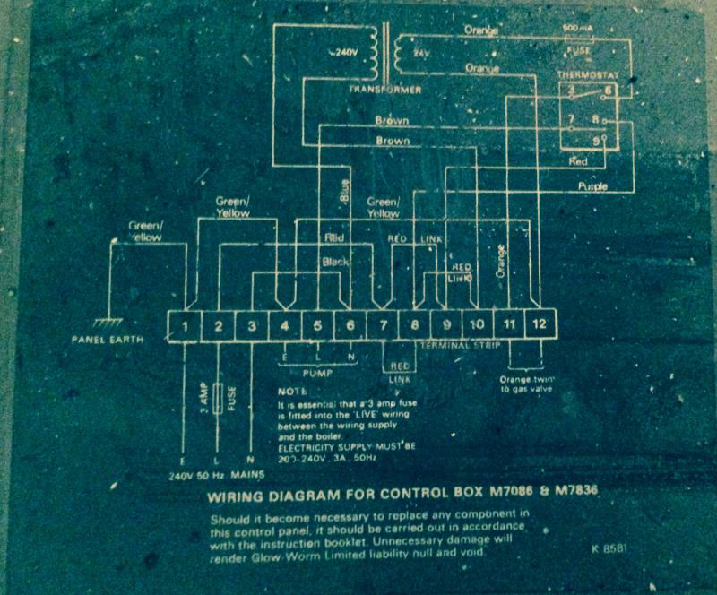

Just trying to work out where to break into wiring to install a salus 500rf a bit of advice would be much appreciated
The salus 500rf is a wireless stat.
Is there a stat on the boiler already? Otherwise its hard to tell unless we know what wiring is already in place.
I cannot find specific installation instructions for the 52e (someone on the plumbing forum may be able to help) it looks like an old model.
The wiring for a more recent Glowworm boiler
http://www.acwilgar.co.uk/Boiler-Manual-PDF/Glow Worm/ultimate-40-FF.pdf
(and from the wiring details you posted) indicates that you remove the RED LINK.
Using some 3-core and earth cable connect the wireless sender up like this:
Live to term > 7
Switched live > 8
Neutral > 3
Earth > 1
That should do it
