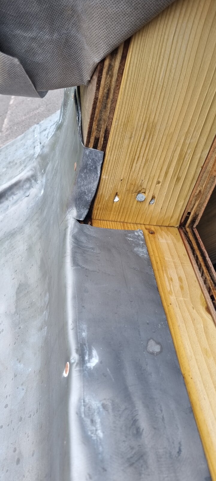

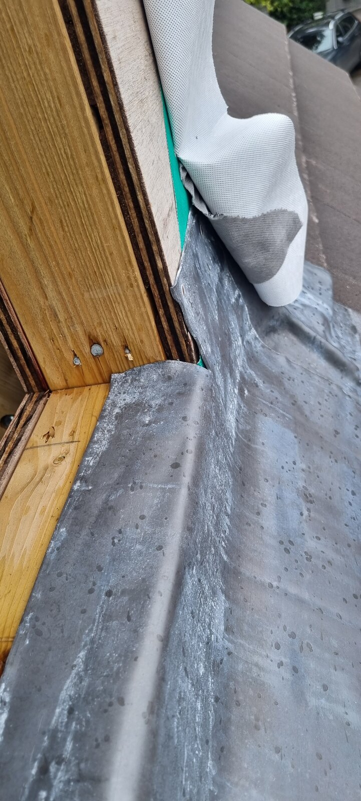

Iam about to fit a UPVC window in this area with sill, however i see the lead flashing isn't great in the corners see pics, can i get away with sealing all the way into the corners with lead sheet silicone and then silicone up round the frame? And a few beads across under the sill? The front face ply exopsed and cheeks will be timber clad.
that looks like a dormer so will be subject to high wind
personally Id be a bit nervous about leaks in those corners
ideally you want a lead tray that goes inside and up the back of the frame
