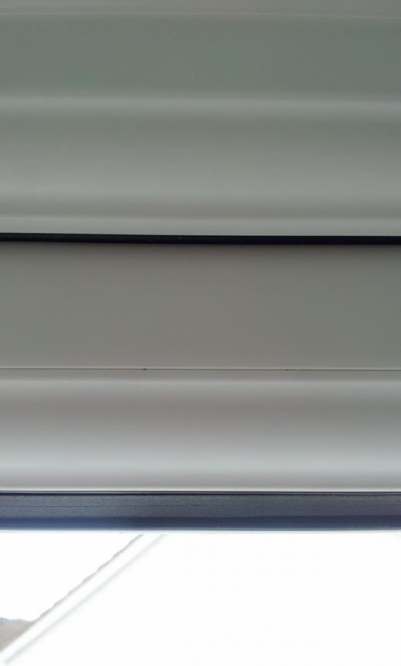

The window that I want to fit the sensor to is set back from the frame and the frame edge is curved. I guess this is true for most with newish double glazing. So what is the best way to fit the sensor so that it is secure. I've posted a image to show the problem.
The top section is the frame - the bottom is the UPVC holding the window. I hope you can see that the edge of the frame curves down to the UPVC holding the window.

plastic packing wedges, or whittle one out of wood if you prefer. Or you could mould silicone under the sensor to form a flat platform, but wrap it in cling film first to prevent it being stuck.
you can buy a roll of double-sided foam sticky tape.
