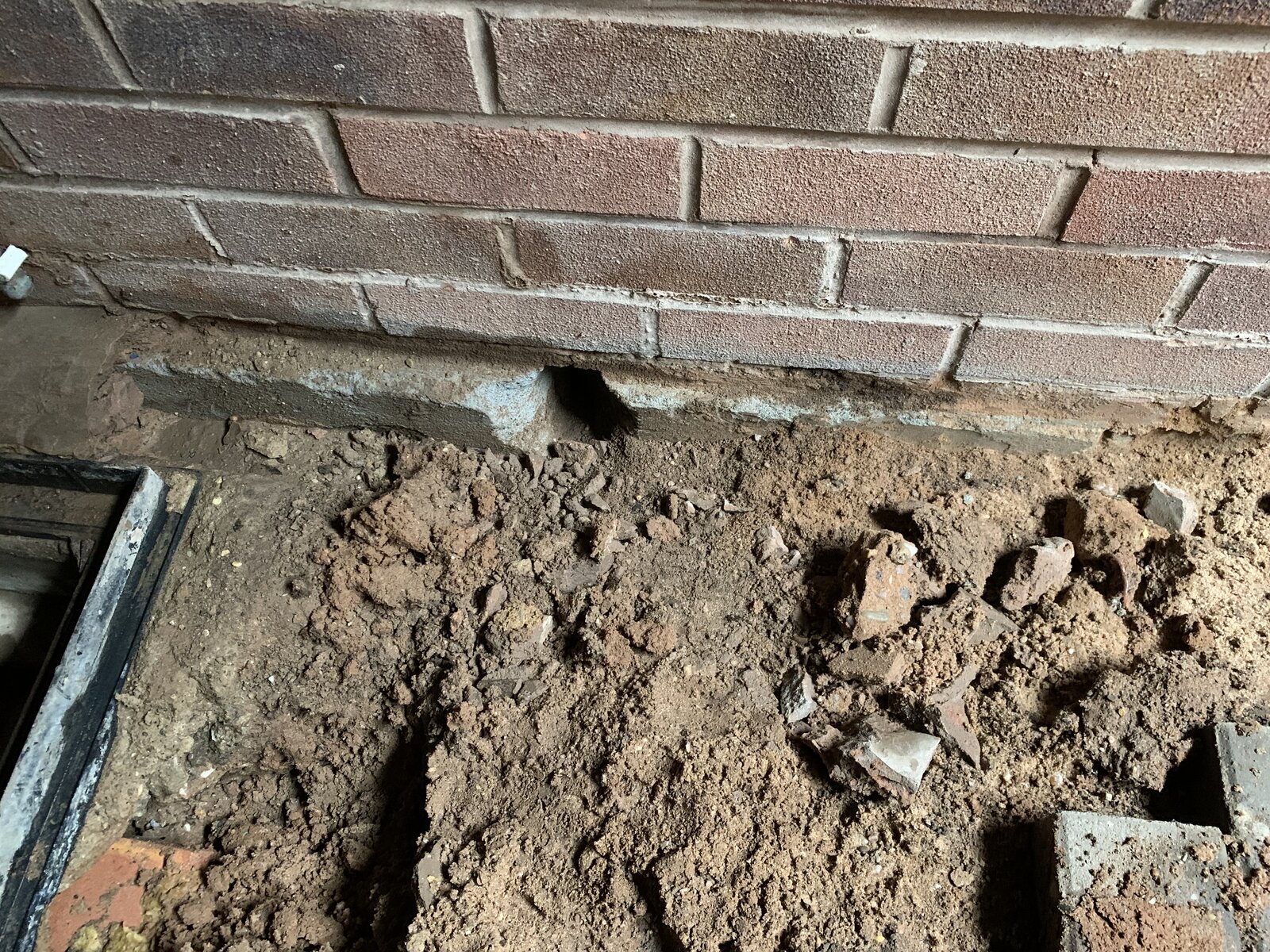

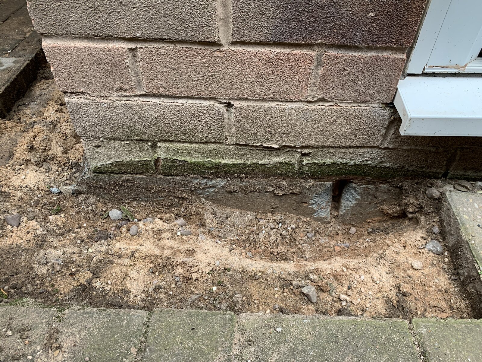

Hi, just wondered what the best product was to use to seal up this damage that a rodent caused as it was trying to dig its way into my house. I want to seal it and make good of the area but as it's below the brick course I don't really know what to use to fill it with.

Thanks. When you say mixed broken glass, how do you mean?
I don't have the rodent problem anymore, I just want to fix the mess it's left so wondered if I needed something special to repair this damage or what the best advice was.
Sand, cement with a few very small pebbles then, if the rodent issue is gone. The suggestion of glass in the mix, was to deter the rodents.
I don't think you need glass. A good fill of small and medium stones, and the concrete kept damp while it cures to hard, will wear away their teeth and they will not chew through it.
I read somewhere that the introduction of concrete and burned bricks made a vast reduction in rodent spoilage, when old lime mortar and cob walls fell out of use.
Gravel because it’ll be tough as a foundation?
Out of interest. What are your thoughts on the condition of the 2 courses of bricks below the DPC? I guess they look worse than they are and should really have been a tougher brick than LBC heathers? The previous owners used them in this area and they are approx 8 years old I’d say.
I'd surprised your rodent made that hole. I suspect there was already a gap, perhaps from poor mortar fill, or a soft patch, tempting him to enlarge it.
is there any chance there might have been a water leak escaping through the wall?
push your new fill in good and deep.
Yeah, both areas that I photographed are where the two blocks meet and it’s the mortar joint that he’s gone for/enlarged. I guess these are the foundations of what the house is built on?
Reconstructing the damage won’t offer any structural strength I guess, you’re just advising to fill up the gap that he’s opened up to detract anything else having at go at that area?
The reason I think it’s a rat is that we had the thing in the loft for a bit but no we’ve put some mesh in where we think he was getting in/out of the property it encouraged him to try digging his way in. The droppings in the loft were rat and not mouse too.
I think it was living in the drain as now I’ve refitted the toilet (that was not present) and started flushing it I’ve not heard anything from him for the last 2 months. I think he’s moved on.
