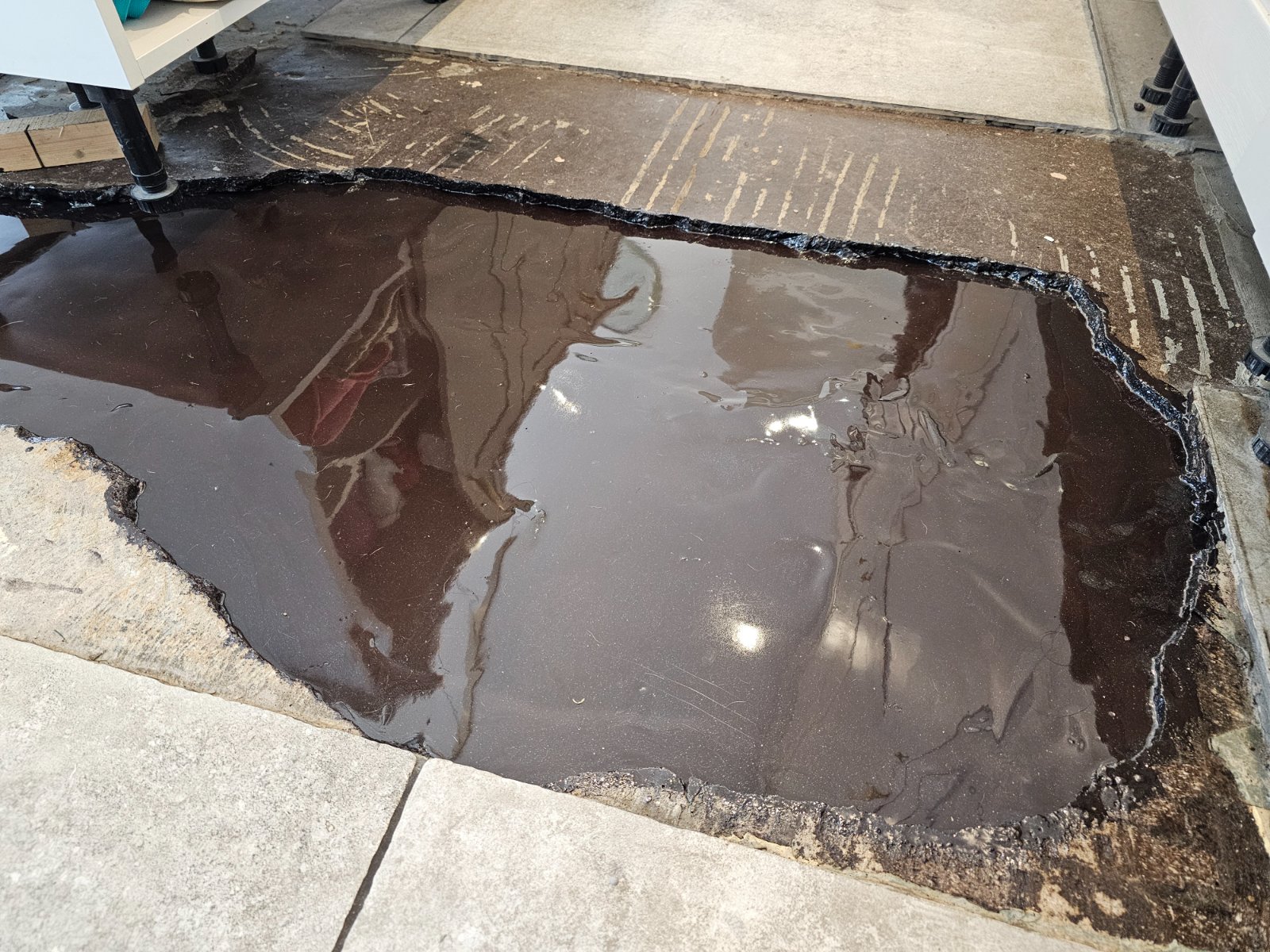

I have a 1950's house. I had a leak in my kitchen, where the mains water pipe comes up into the house before the stop tap. We had to bring up the floor and follow the mains pipe down through the concrete floor and find the clay/ceramic service pipe that houses the copper pipes that goes to the street stop tap and mains water provider. We had to replace about 50cm of copper that had been eaten by the concrete over the last 70 years. Had someone out, thats all fixed.

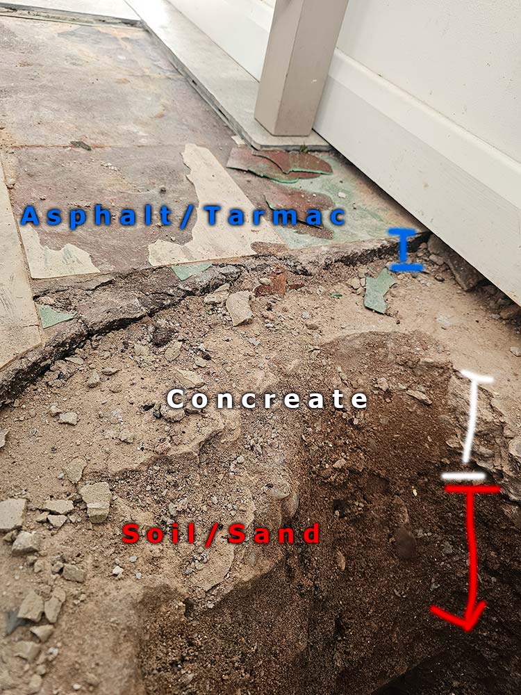

The issue is the house, like a lot during this time, has a concrete floor supported by an Aspalt/tarmac layer that acts as a dampproof membrane and, by the looks of it, used to level the floor.
My question is how best to repair the Asphalt? Is there a product I can paint down on the concrete, or a screed? My thoughts are that tarmac expands and contracts as I've seen in other areas of the house where we had channels put into the floor for Electric supply to kitchen island etc. The solution they used was to chase the tarmac to leave expansion but unsure of what product they put down? Maybe some sort of flexible waterproof screed?
Any ideas?

I'd just dig out tidy. Square off the edges.
Gravel.
Sand
Plastic
4 inches of concrete
To make up the top layer in not sure.
I'd use wood.

Regarding the floor, you'd put plastic down in the area before the concrete to stop the rising damp, thus mitigating the Asphalt removal in that area?
My concern is that the top layer moves a little. I assume this is because it is asphalt (like any tarmac expands and contracts with heat and cold). So, I should leave a gap for expansion, but what do I put in the gab so there's no void since I'm tiling over. I don't want something dropping where its hallow and breaking the tile. Some sort of foam board or cork maybe?
Sand and cement with a visqueen sheet under it to the level of the asphalt then top it off with ardex DPM1c epoxy or similar making sure you overlap it to the asphalt
No need to bother with expansion gaps or anything then? Just coat it with DPM Epoxy. Can I tile directly on that?

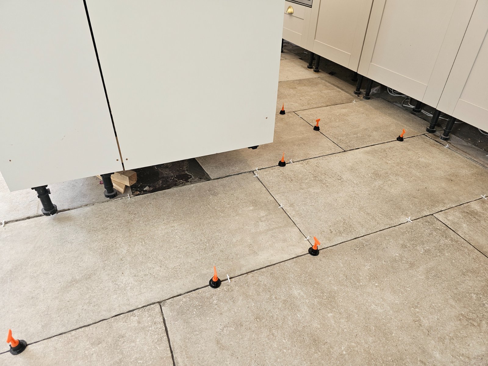

So, I have a secondary problem. I have tiles in my kitchen that are lifting in the same room as the leak. Since lifting the floor up due to this water leak I've come to realise that I think the problem is due to the channels that were cut into the floor for Plumbing and drains. The channel is about 5 inch wide, and filled in with new concrete/cement.
It doesn't look like these channels were primed or damp-proofed. The asphalt comes up to the channel, and then whatever product they used to fill the channel (looks cement based). I think the damp must be rising through the channel, then the sulphates in the cement and mould eating the tile adhesive, making them lift.
So, the solution must be pretty similar: coat it in damp proof, overlap the asphalt, and complete the seal.
My question I'll probably just fix the tiles as they pop. Is there a product I can put down that can be sealed and reused as required. I found black jack that will cover the concrete but will it be safe to overlap the Asphalt?

Update: for anyone who comes across this problem. I phoned Ardex directly to ask for technical help. They arranged for a floor specialist to call me back.
He said the asphalt is temperature-sensitive and expands and contracts at a different rate than the concrete. He said any fresh concrete that had been laid for my kitchen services buried in the ground would also expand at a different rate. He said you've got small movements that over time make the tiles pop.
He said if your using porcelain tiles (as we are) and are planning to continue to use them you don't need to worry about rising damp.
He said concrete in your floor then on the top layer use Ardex NA up to the asphalt. It will bond to the concrete and asphalt, giving you some damp-proofing qualities as it is moisture tolerant. He said its also flexible with lots of flexural strength. Then on top of that use a flexible tile adhesive like Ardex X7. That should take care of any movement with both products being flexible.
I noticed the X7 is also suitable outside with a pools etc. so it must have added damp-proof qualities, not that it will be an issue with Porcelain.
From further reading, it would appear Ardex NA is some sort of super product that we bond with most things, including Bitumen. So I'm tempted to paint down some blackjack first. Even though I've been told I don't need it, I figure extra protection can't be a bad idea?
