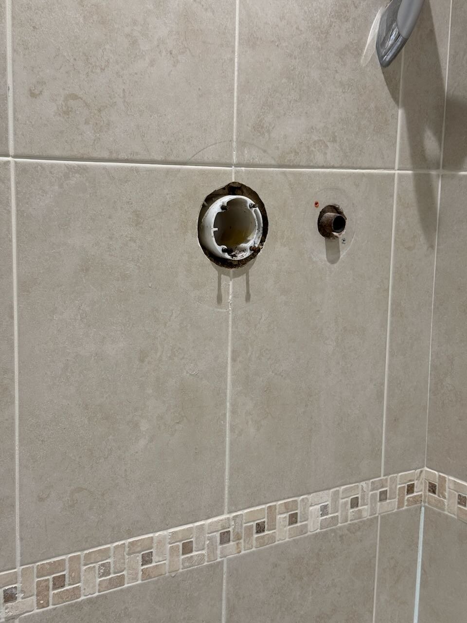

I have a couple of holes where I removed an old thermostatic shower mixer. See pictures. These tiles are not available anymore.
What would be the best way of fixing this?
I'm thinking I have four options:

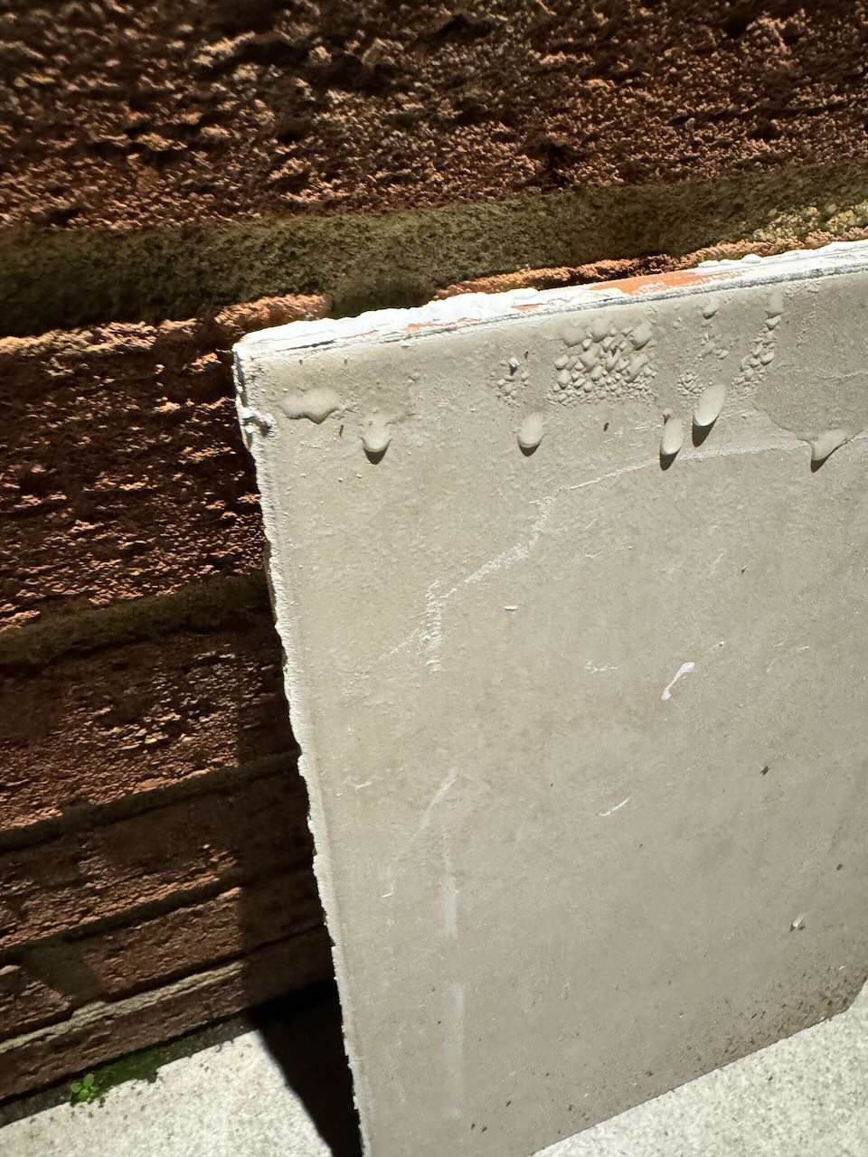

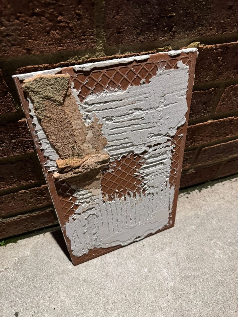

1. I have salvaged some of these same tiles from a prior job, but they still have the old tile adhesive and mortar on them. I could perhaps try scraping off any residue (is this even possible?) and then re-use them? See pictures for the condition of these salvaged tiles.
2. I have some spare close-matching tiles (but a trained eye would notice they are not original). However, these are 100mm too long and so I will have to cut them down. This will leave an unfinished edge which I'm not too keen about, but maybe I position the cut edge at the bottom?
3. Try to use a straight tile cutter to cut a somewhat circular shape into an offcut of tile and then fix it in place. I can't imagine this will be very easy on a small bit of tile.
4. Leave the tiles in place and just grout over both holes, but that will look a bit crap.
What would you recommend or are there any better options?

Do you need a soap dish?
Try soaking the old tiles: some adhesives will certainly soften.
I'll putting a riser rail over the top of where that hole is, so unfortunately a soap dish isn't possible.
I've tried soaking the tile for a couple of hours in hot water and unfortunately I didn't have much luck with it. It softened a little but it was still not very easy to remove.
I've used an old wood chisel: slow and tedious but if you only need a couple of tiles worth the effort. Also used a 4 1/2 inch angle grinder. Quicker but a lot messier.
Angle grinder will remove cement in a few minutes . Soaking method takes a few weeks to soften cement.
I've used a combination of the wood chisel to get the lumps off, and then 60 grit sand paper to flatten the old adhesive on the back of the tile. Given the old adhesive is still stuck between the dimples/ridges of the tile, and the sanding has created a relatively smooth surface on the back of the tile, can I use some SBR bond on the back of the tile to improve the bond to the new adhesive?
