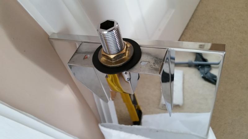

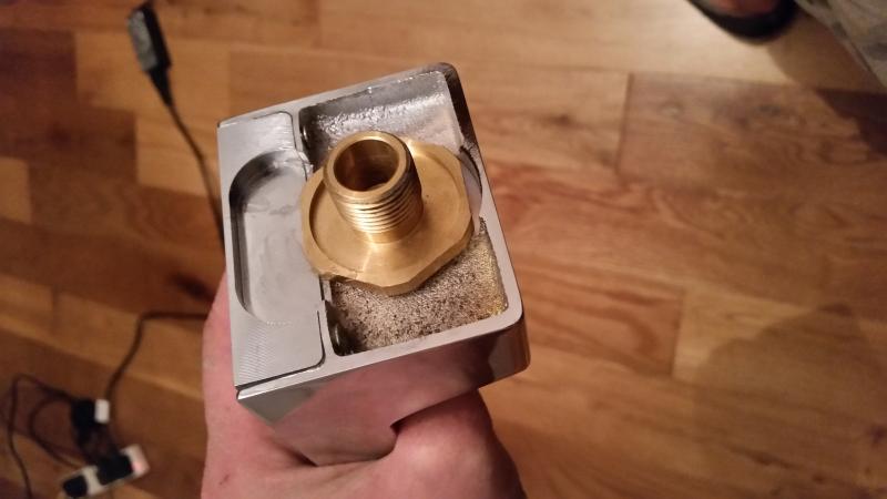

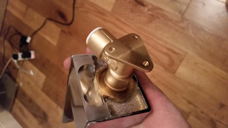

I know this has been asked, and I've searched in vain for the exact right answer I'm afraid.
I've built a stud wall (against an exterior wall) to house pipework for a valve, bath filler and shower head. The valve seems simple enough as there's some degree of flexibility in how far the taps slide on.
However, the filler and shower head are the issue. I've bought wall plate elbows (which I'll mount securely in the stud wall) to attach them to but :
a) there doesn't seem to be enough room to fit in the plasterboard and tiles - so, when fully screwed on, the gap between the back of the filler and the elbow is only around 15mm. Does it have be screwed fully on? I could extend with another connector, but then surely the weight of it, is on that rather than the wall plate?
b) how can you possibly work out where the rotation will end up? Obviously, both need to finish perfectly horizontal.
Thanks in advance for advice.

Firstly then, where does the wall plate to shower head / bath filler seal?
On the threads, on tape, no an o-ring or a washer?
If I understand your question, they seal against the tiles (is that what you meant?)
The shower head has a washer (see pic) but having read other threads, this can be pretty much discarded (as there will be no way to get behind the stud wall to screw it on)
Recess the wall plate elbow into the plaster board to create the desired gap?
Rather than backing any fittings off, which will most probably result in leaks that you cannot deal with, try and get the distance you need out of the wall.
What gap do you need?
You can get extensions for the backplate elbow. Its an 1/2 inch male to female iron ask a plumbers merchant they are called tap extensions.
