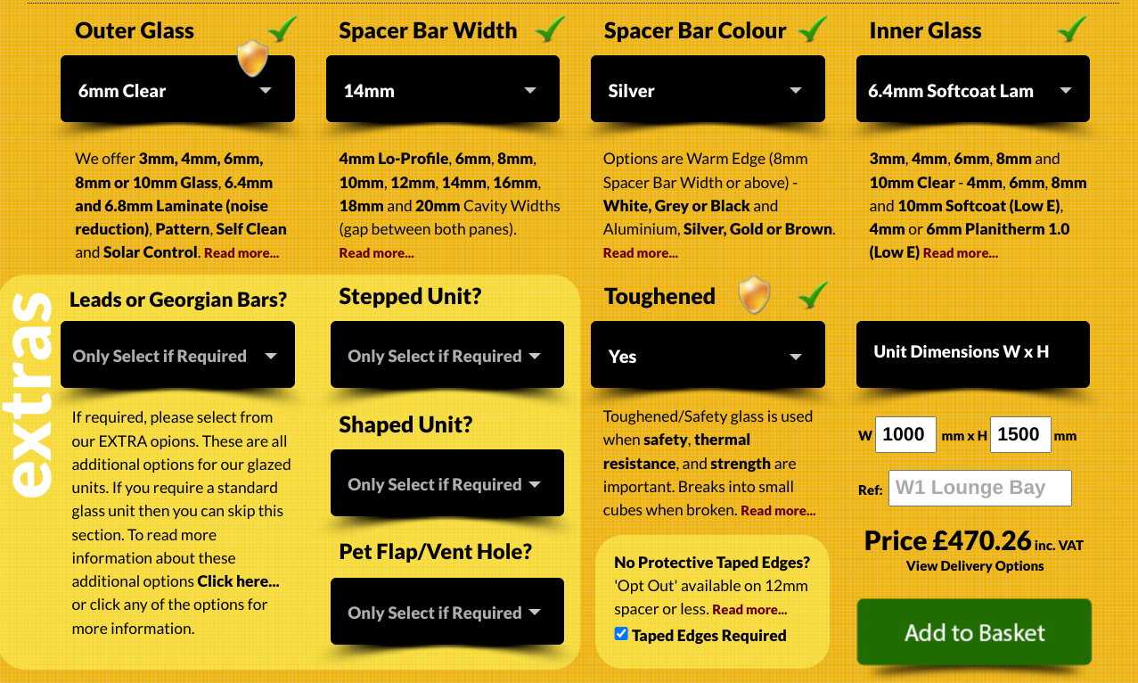

I've just run that unit online - OK with only 6.4mm laminated internally as this co didn't offer 8.8

I've run it through my pricing system as 6mm toughened and 6.8mm accoustic lam @ £520 fitted with a 10 year guarantee however bare in mind a unit with that glass will be around 50kg so will take 2 men so allow a bit extra for a second man

I'd imagine 4mm toughened external and 6.4mm low e internally to catch the toughened outer in case it shatters £340 fitted 10 year guarantee
