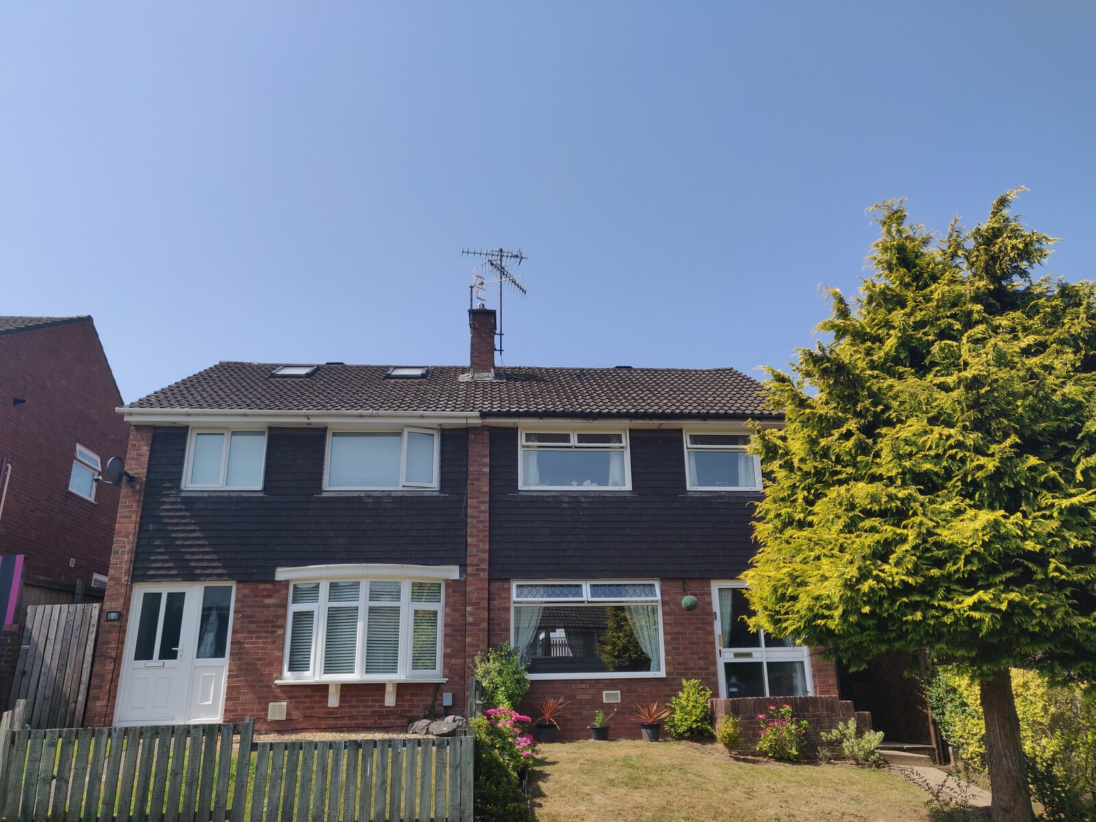

I'm considering having my roof replaced in advance of fitting Solar PV panels, and having new membrane, tiles, eaves ventilation, dry ventilated ridge, dry verge, fascias, soffits, guttering etc, and then fitting PIR board between and under the rafters to bring the insulation up to spec.
I have a 1971 Wimpey built 3 bedroom semi-detached with interlocking concrete double roman tiles. I understand that the extent of the repairs mean that building control approval is required, though some of the roofers I have approached either don't know this or don't seem to care.
The roofer I am dealing with at the moment has suggested that on the front elevation of my house (where my roof is on the right and my neighbours on the left with a chimney between us) he will not be able to double fix the tiles (BS 5534?) without installing a bonding gutter. I don't see why this is the case, but I assume it might be something to do with the tile interlock requiring them to be laid/fixed from right to left (ie toward my neighbours roof). Is this the case?
Also, my understanding is that a bonding gutter is intended for weathering the joint between two DIFFERENT roof coverings, but I would be replacing the existing double roman tiles like-for-like with double roman tiles, so I can't see why this would be necessary. Also, using bonding gutters requires disturbing my neighbours roof by crossing the party wall line between us, so I really, really don't want to do this.
Looking around my estate I cannot find a single instance where someone has replaced their roof and used a bonding gutter to do so.
Advice and opinions welcome

They are a Federation Of Master Builders member. I know that isn't a guarantee of good quality or knowledge in and of itself, but they were the first roofer I've spoken to that recognised that Building Control approval was a legal necessity, which at least gave me a small measure of confidence in them.
After a bit of initial confusion, my local Building Control has confirmed that because the tiles are the same both sides of the roof between myself and my neighbour (ie Double Roman) there is no requirement for bonding gutters to be fitted, which is not only what I would have expected, but also is a big relief in not having to disturb my neighbours roof tiles.

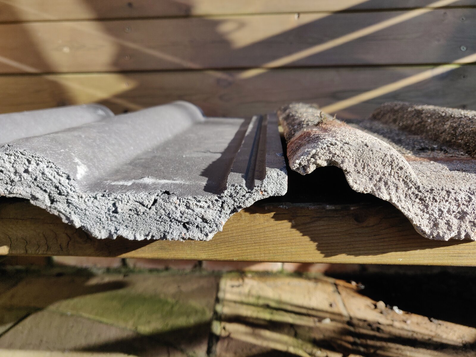

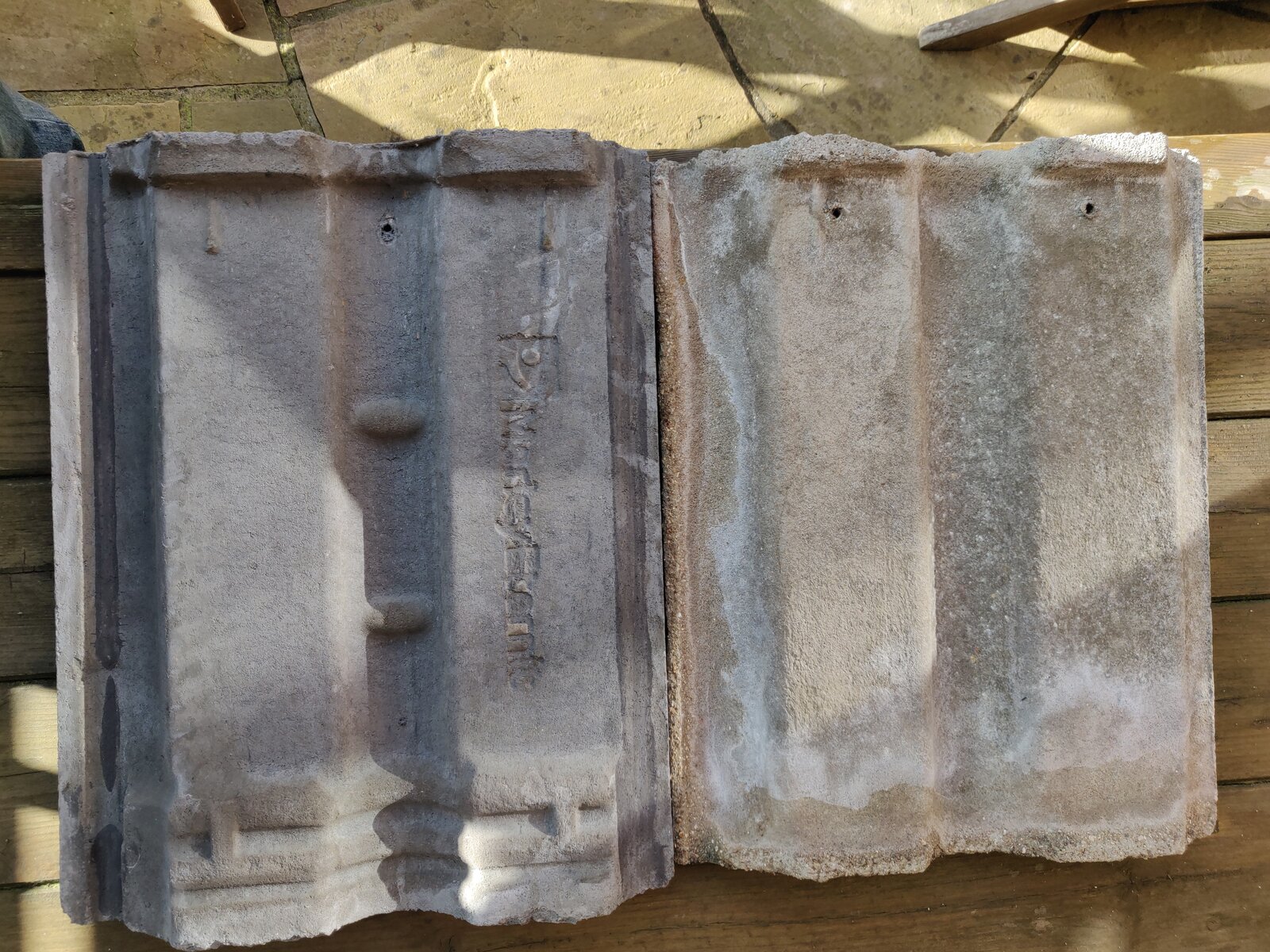

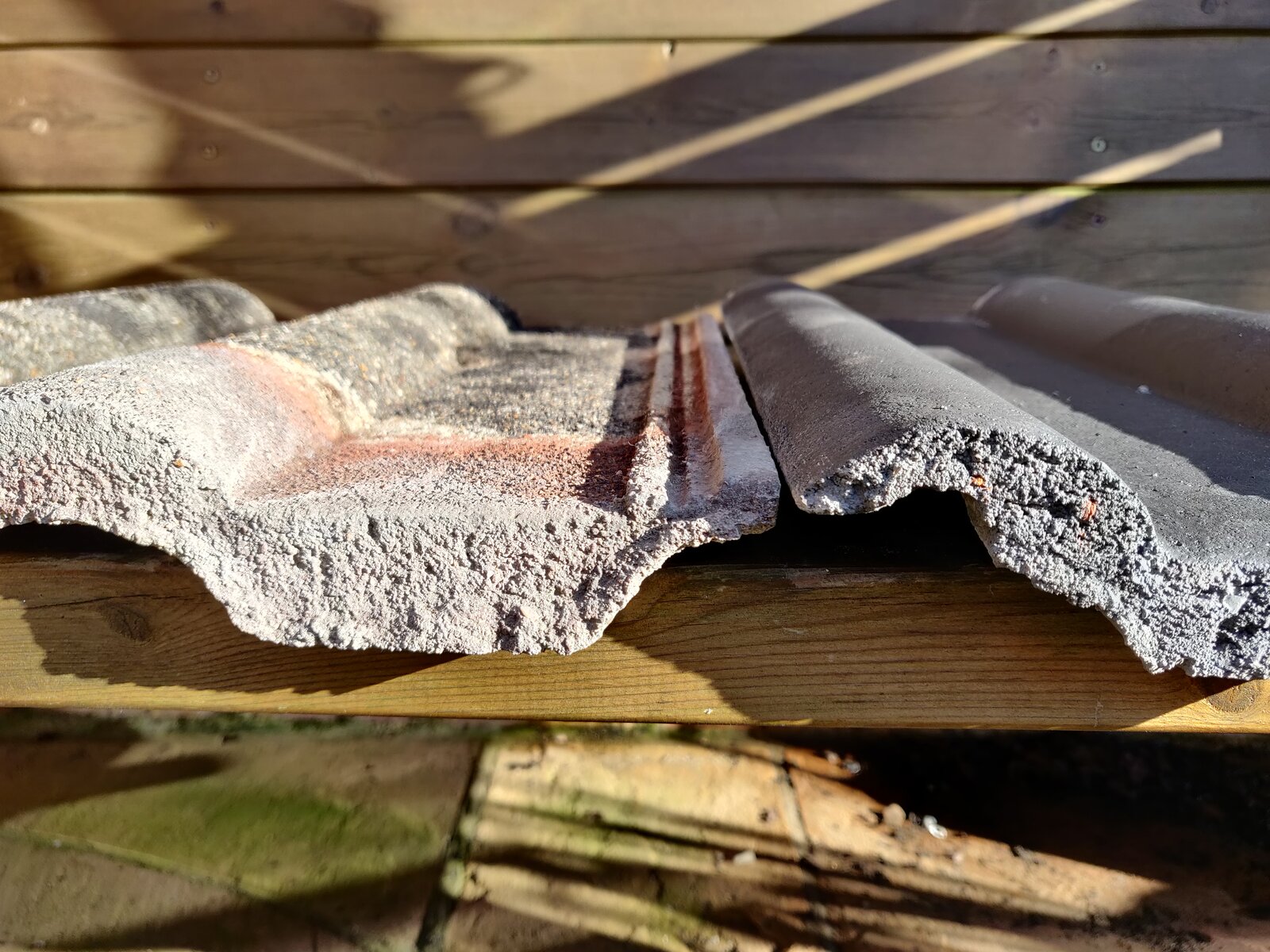

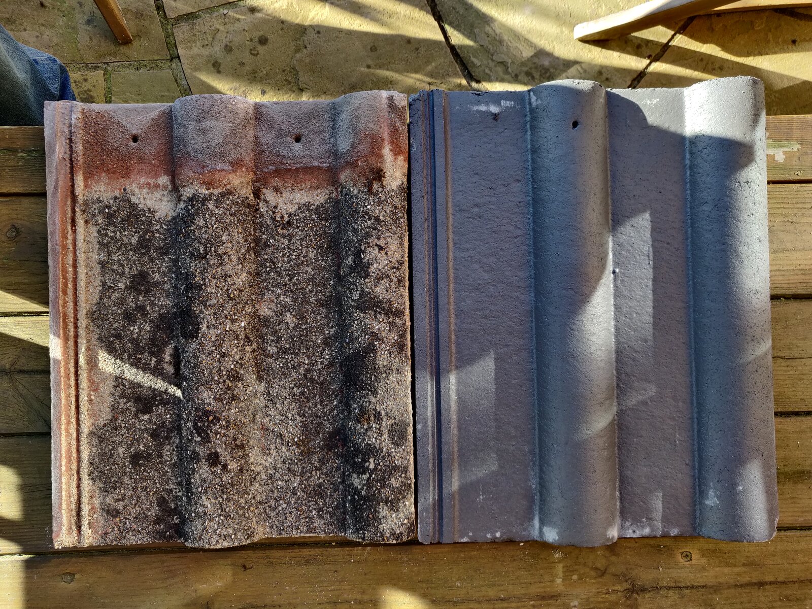

Retile with the same make and tile type (marley double roman, or Redland 50) will go back as they came off.
If it was a much earlier Marley version the channels were different .. but way beforev1971.
A picture zoomed into the tile will allow proper identification and ten potential issues if any ..

I intend to. I took one of the existing tiles off the roof to try and identify whether it was Marley, Redland, or Sandtoft etc, but there are no manufacturer marks visible, so I'm still not certain, though at the moment my roofer has gone with Marley Double Roman Smooth Grey.
I've attached some photos of an existing roof tile alongside a Marley double roman. Maybe someone can definitevly identify them?
