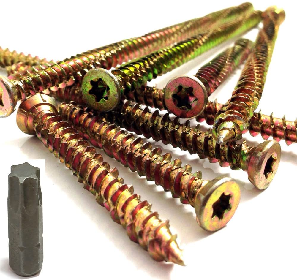

I'm looking to fix kitchen wall units to (72mm total width) Plasterboard /Insulated backed Walls.
The 72mm walls are dabbed to either lathe and ply walls (with air gap) or to Solid brick (not cavity) walls (with air gap).
What is recommended: a hanging rail for both types of wall (trying to find studs on the lathe and ply wall)?
OR
Using Torx masonry screws for fixing a hanging rail to the PB with brick wall behind?
Any advice welcome. Thanks

Picture of torx screws - These would go through the PB/Insulation (72mm) air gap (25mm ish) and into wall, to fasten hanging rail for cabinets. A bit afraid of crushing PB/Insulation though. I'd be looking to use wood screws through the 72mm and airgap into any wooden uprights I can detect in the lathe wall. (Foil on insulation messes up the stud detector a bit.)

you wont have enough control over those screws to get the right torque.
they’ll either stop too slack or so tight they’ll pull the bracket in to the board.
also imo i think the gap is too great and the screw and bracket will sag under the weight . id use metal wall rails to spread the load.
That's not going to be any good, you will be relying on the screw to do the weight carrying and at 4" the cantilever on the screw will be far to much, the cabinets will be coming down.
The correct thing to do is to drill large holes say 15-20mm and get metal spacers machined that are 100mm long, when you screw the cabinet brackets to the spacers and to the wooden uprights it will bunch up tight and provide a solid fixing which you won't be relying on a screw on a cantilever.
Plasterboard requires the weight to be spread over a large area otherwise it's very weak.

Hi and thanks. When you say use metal wall rails to spread load, I assume you mean the 1 or 2 m metal rails (e.g from Screwfix). I was going to use those anyway (top and bottom of wall units), just a question of the way I'd fix the spreader rail to the PB. Would torx screws for brick wall fixings and woodscrews to wooden uprights be ok? SXTurbo advises spacer through to wall behind PB/Insulation which seems ideal.
