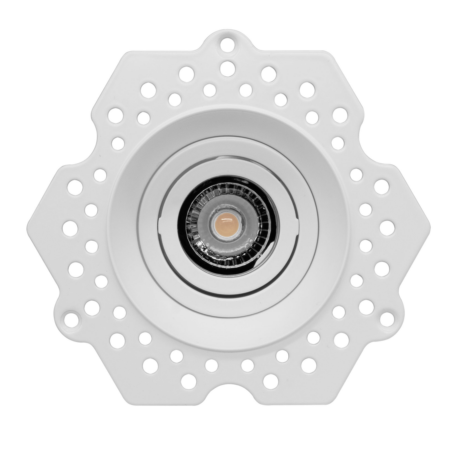

Hi all,
I have a load of downlights that are to be plastered in to fit. They won't all be next to a joist above, and they don't have the spring clips, just a plastic section that gets plasterered over.
What's the best way to secure them for plastering? I'm thinking of a bit of Sticks Like Sh1t, and a few staples?
These are the lights: https://www.mr-resistor.co.uk/product/22187
Any help much appreciated!
Small 20mm x 3mm screws will hold to ceiling while its plastered, don’t use a cordless just screw in by hand unless you have one of those very little low torque power drivers to screw gently into plasterboard.
I have 4x20 and 3.5x16, so I'll see what works best. This has been very helpful, thank you. Would you go with a bit of Sticks Like behind the frame too?

Use a Polymer like CT1 or sticks like xxxx.
I used loads over the years to fix corner beading ect. Was my preferred method having tried super glue, hot glue gun, nails ect...Can also use a staple gun along with polymer if you have one.
Everbuild stixall will do it
3 screws in board in the 3 edge holes although not that clear in the instructions
I'd still stick on myself

Think Ill try a bit of polymer adhesive (Got a tube of stixall in stock), and 3x 4x20mm screws, and see how I go. 19 of them to fit in the next few days.

They have a clear plastic bit already in place to protect against plasterers.
You can remove the lamp from below using a suction cup. Looks a bit of a faff, but hopefully years between needing to do it.....
