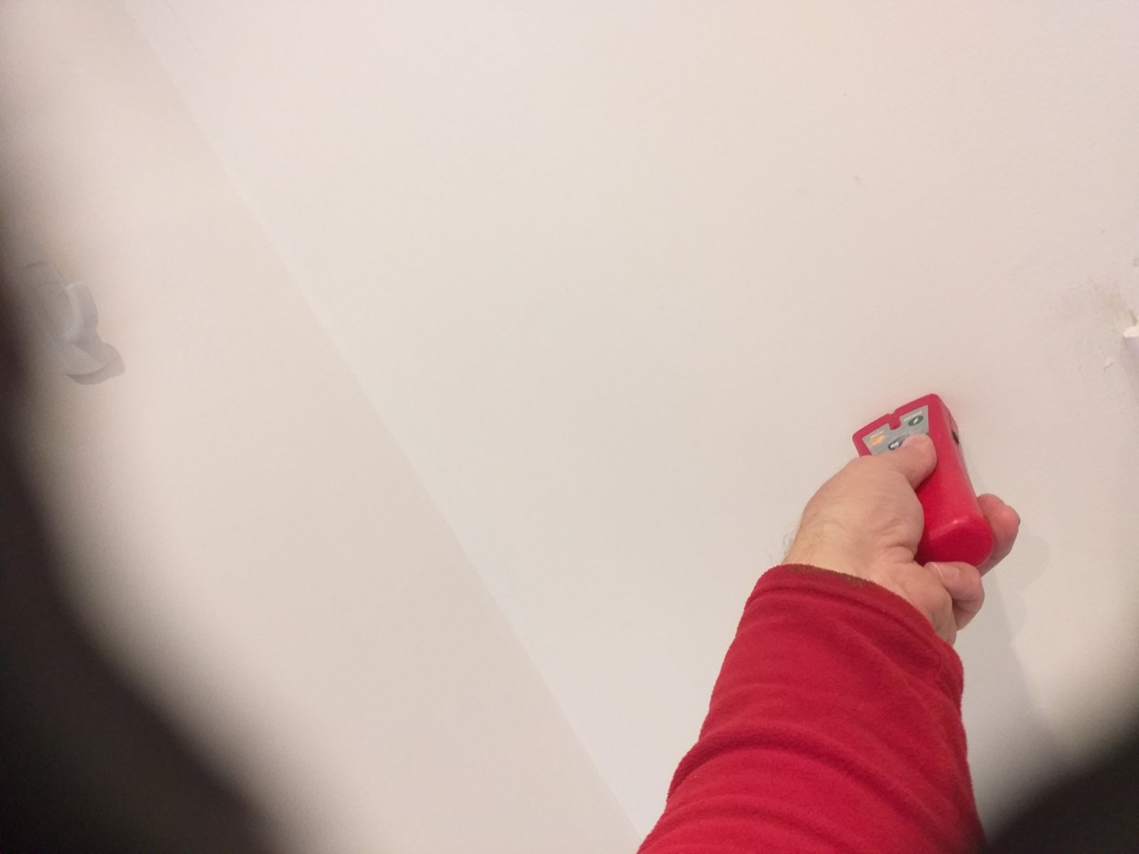

I was using the below.

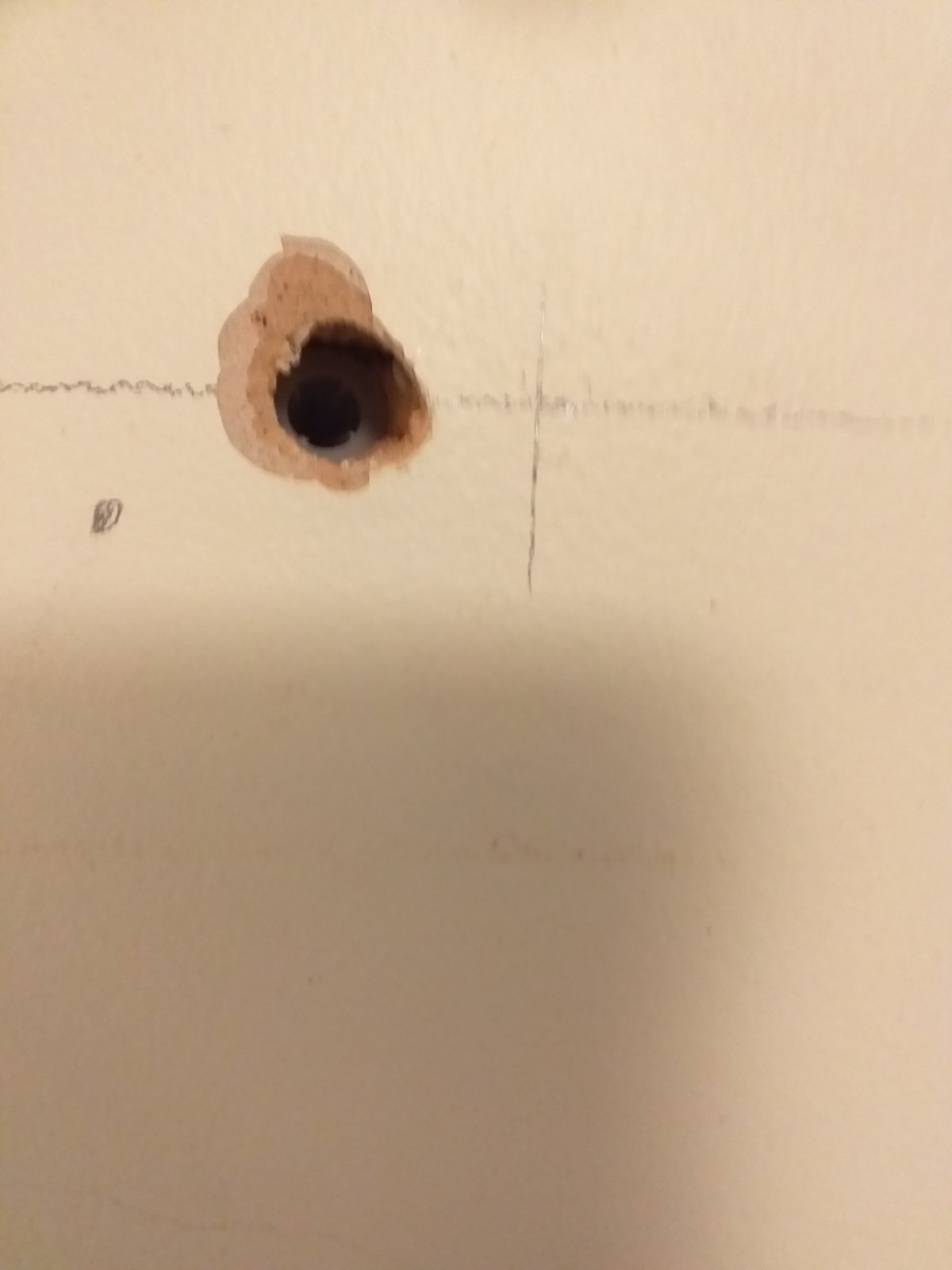

Also when put my cheap detector on metal it was bleeping all the time so I went in slowly then pushed a nail in to see if I could feel a pipe.
Felt nothing. No water spurted out. I guess all good?

Got to put another cabinet in this corner. It's obviously a stud wall separating kitchen from bathroom. I've run my metal detector thing and it beeps alot in corner and 400mm out from corner. Are these the screws for studs? The cabinet is 600mm wide so how about running a piece of rail attached to both studs?
400mm seems right for the stud centres in a wall. Those long rails can be fixed into the studs, but there would be no harm in adding an umbrella fixing or even an ordinary plasterboard fixing at the "wagging" end of the rail as well for extra strength.
