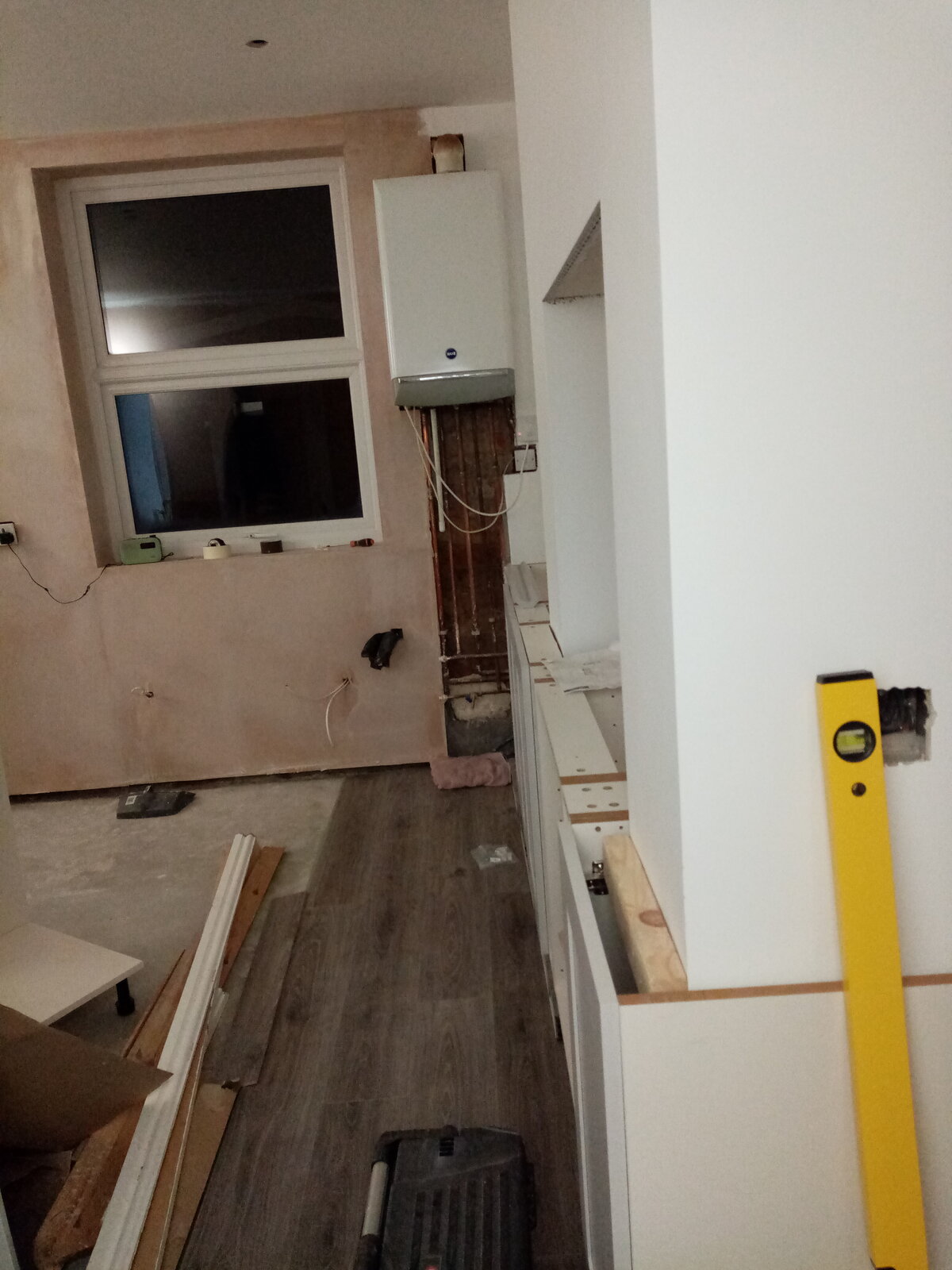

1st pic: cabibet run installed so far. Started installing at chimney breast
2nd pic: looking from R rise of chimney breast down to where corner will be

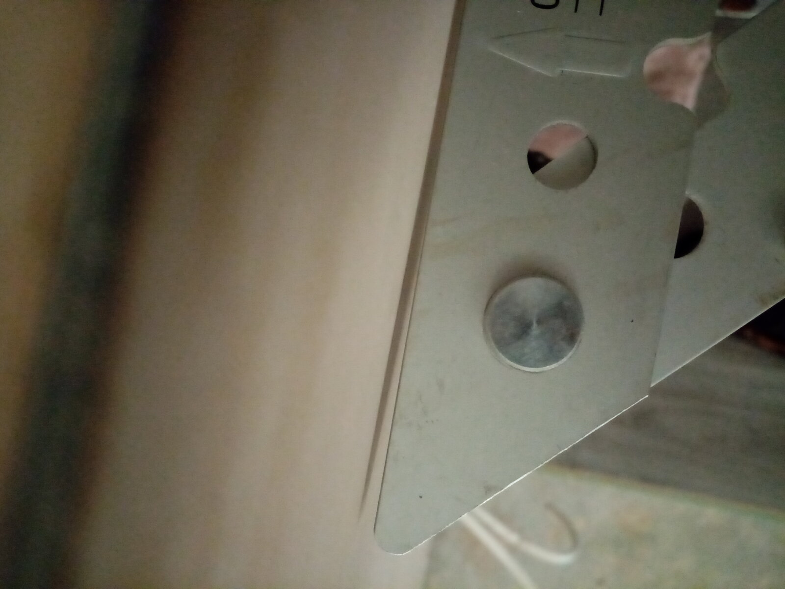

3rd pic: gap between wall and set square when set square is on current installed corner unit. Looking at it now it's probably not overly bad, maybe 3-4mm gap but I imagine this gap will increase the further along the run of cabinets.

What are you going to do with the exposed edge this side in photo 2 where your level is?
The gap in photo 3 could be anything, its where it runs when you have a run of units in place to see how far out its running.

is that pillar isn't falling behind the line where the feet come, if not you need to think what you are going to do with the plinth there.

yes i was thinking about the plinth - it's because instead of hacking a cabinet to bits and having slithers left, i just cut a bit of the side panel so i could hand the door making a false cupboard, hence no feet. I will probably just leave it? It's only a 450mm length/section and will be butting up to an end panel.
yes, the front faces are all flat, apart from the left side of the oven unit, and the right side of the 150mm unit next to the oven (about a 2-3mm gap between spirit level and front edge)- not sure why - doors look okay and all flush along the run of cabinets.

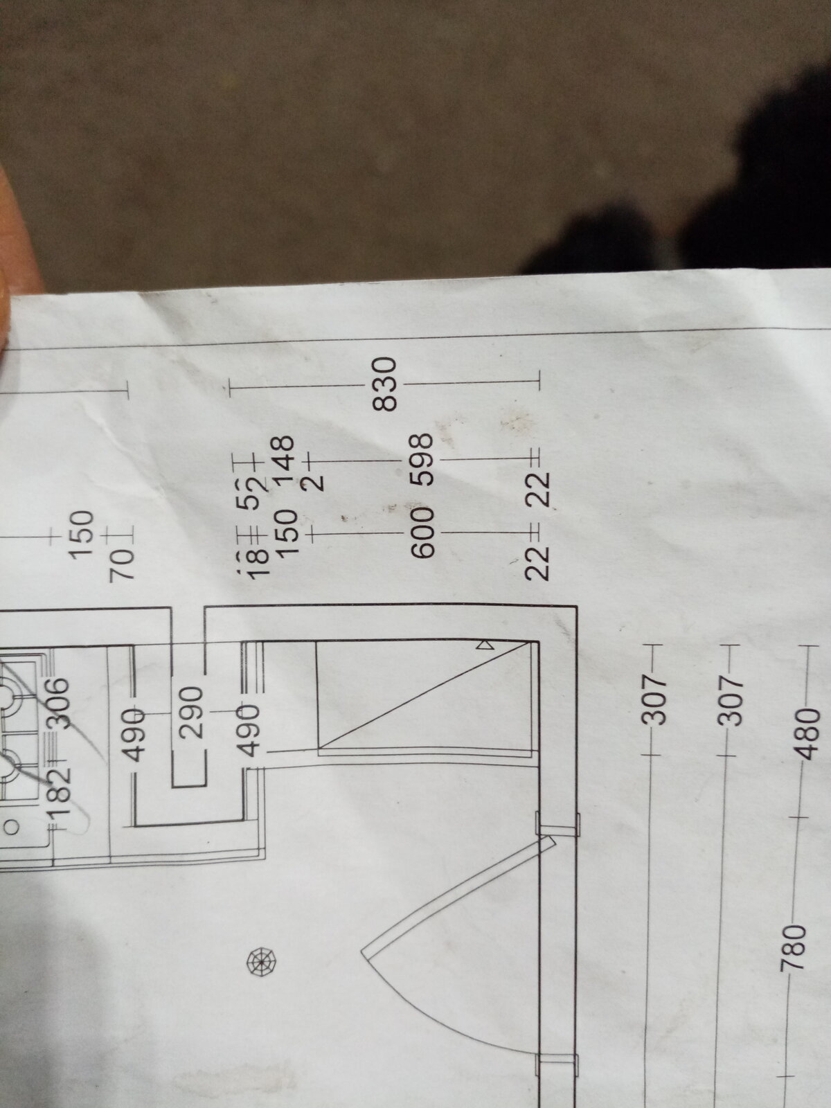

Here is plan pic
Hope you haven't fixed the cupboards as yet.
What you should do is measure from what will be the back wall of the cupboards at each end 605mm out into the room at each side wall.
Draw a line between those 2 points, Check the line is square with the most important side wall (or at least looks 'square').
That line is the front of your cabinets. You may need to draw another line inset the distance the legs/feet are from the front of the cabinets.
You then fix the cabinets to the wall using "Space Plugs' (see Link).
HTH
