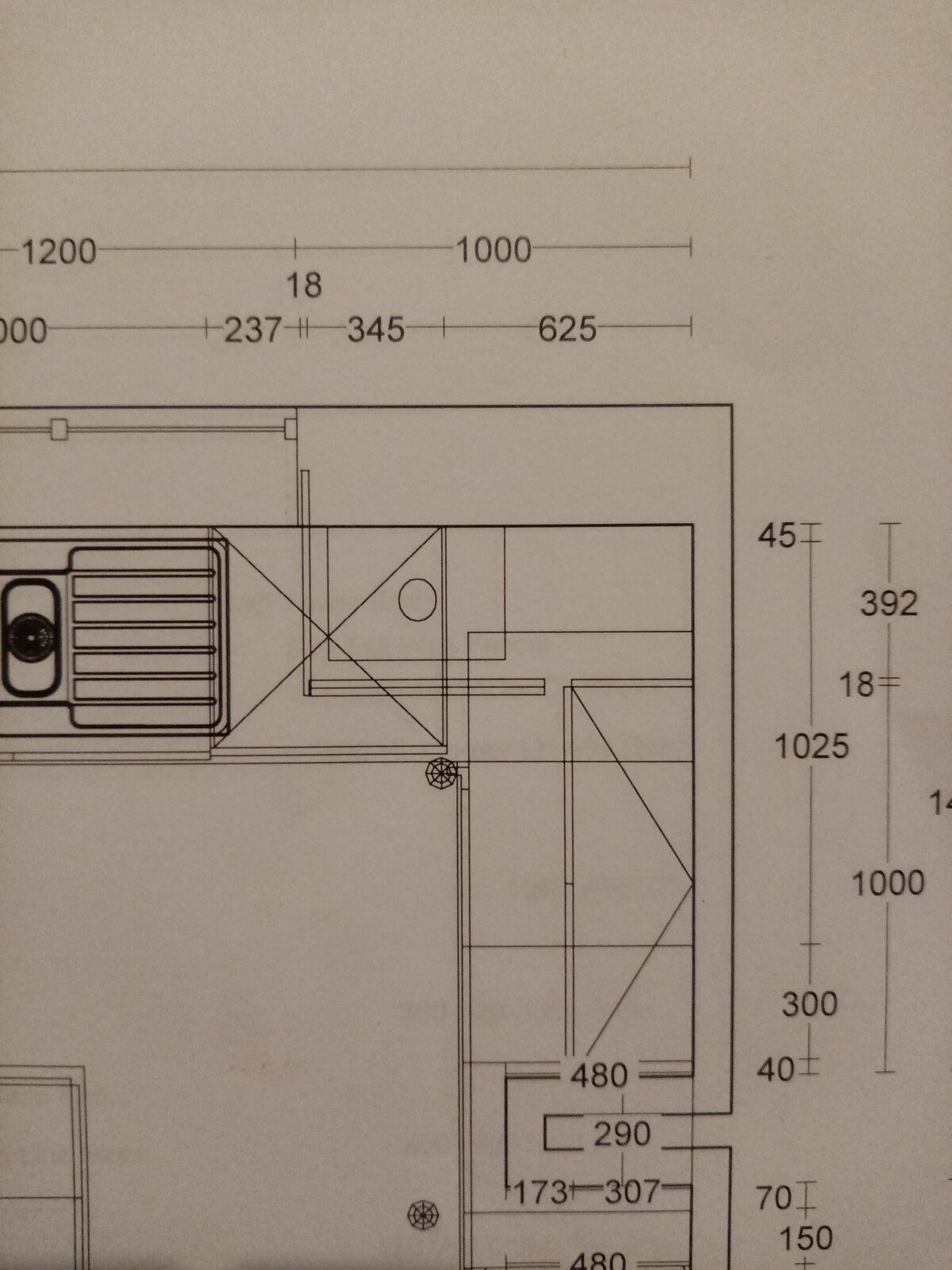

Having had my kitchen designed, because i need to centralise my oven unit in the centre of my chimney breast (starting point for kitchen fit), this will mean that to the left of the chimney breast, where the corner unit meets the dishwasher on the return wall, a standard corner post won't fit.
The kitchen designer said i will need to make a corner post out of plinth.
Am i correct in my understanding that as i look at the corner unit, to the left of the centre post, i will install an end panel, the same thickness of the door. I would then use a cut off plinth to attached to this end panel, creating a corner post made to size;
Is my understanding correct.
Please see picture of design and corner in question
You could do this and yes it would work in the manner you are referring to.
If you are having a slab door you could use a door to form the corner post, presuming the appliance to the right of the sink is integrated you will also need a base end panel behind the corner post thus forming a 600mm gap for appliance and doubling as support for worksurface.
If you are having stone, corian, quartz worktops you could baton the sink run off the wall to enable the correct corner posts to be fitted, which is another option.

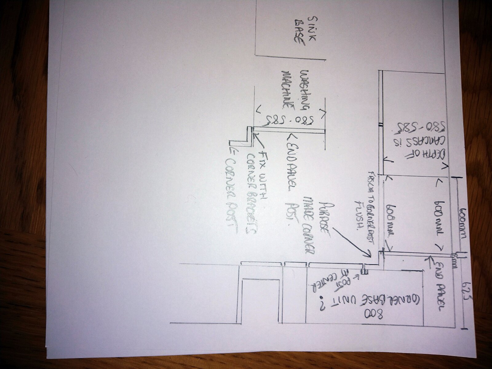

Ok working from the right hand side of sink base unit, next is washing machine which will need a gap of 600mm, this gap is formed from the right hand side of the sink base unit to the left hand edge of a base unit end panel. This end panel needs to be the depth of the base unit 580mm* and the correct height that it sits on the floor but also level with the top of the base units.
The corner post will be connected to the front of this end panel thus the face of the corner post at this point is in plain with door fascia's on that run, the gap between the left edge of corner post to right of sink should be 600mm.
Connect corner post to corner base unit with brackets etc, fill void behind with scrap shelf or similar so cans and stuff don't fall into void.
I can't though tell you what size the corner post should be, this will be determined after you have set the base units out.

Looking at the diagram it would appear that the End panel that sits behind the purpose made corner post is set 625mm from the wall of the oven run.
Fit oven cabinet and work to your left fixing all cabinets including corner base cabinet*.
From oven run wall measure 1243mm along sink run wall and draw a line on the wall at this point "this is the position of the right hand side of the sink base unit "fix in position". Measure to the right of sink base unit 600mm and Mark line on wall, this Mark is the left hand side of the base end panel which forms the 600mm void for the integrated washing machine.
Cut this end panel to carcass depth and a height so it can be bracketed to floor and supports the worktop. If you screw a baton to the top of sink base across to top of end panel set 600mm and screw to top of end panel "check end panel is plumb" you can work out what out width of corner post to corner base unit as depicted in my sketch.
I presuming the corner base unit is 800mm, the standard door for this cabinet is a 400mm door as there is a post at centre in this cabinet. However this post can be moved, there may be pre drilled holes in the top rail for this purpose, thus enabling a 450mm - 500mm door to be installed should this be viable.
