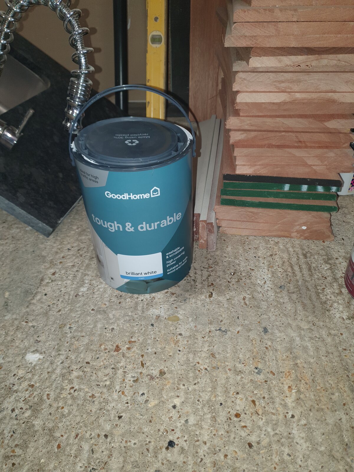

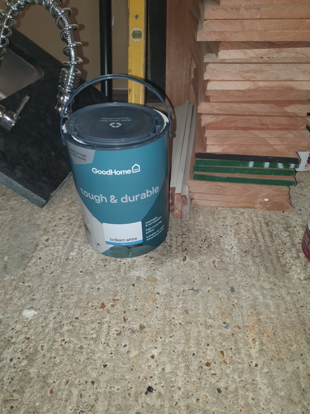

Already on it
Yeah. It's good paint. I heard the sprayers use it on MDF furniture as good value with great application. I've used some

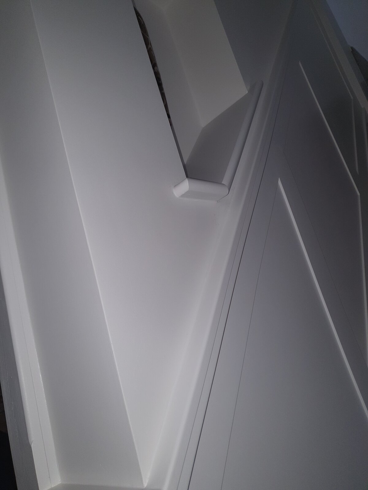

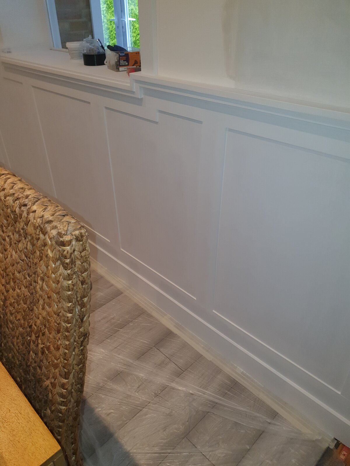

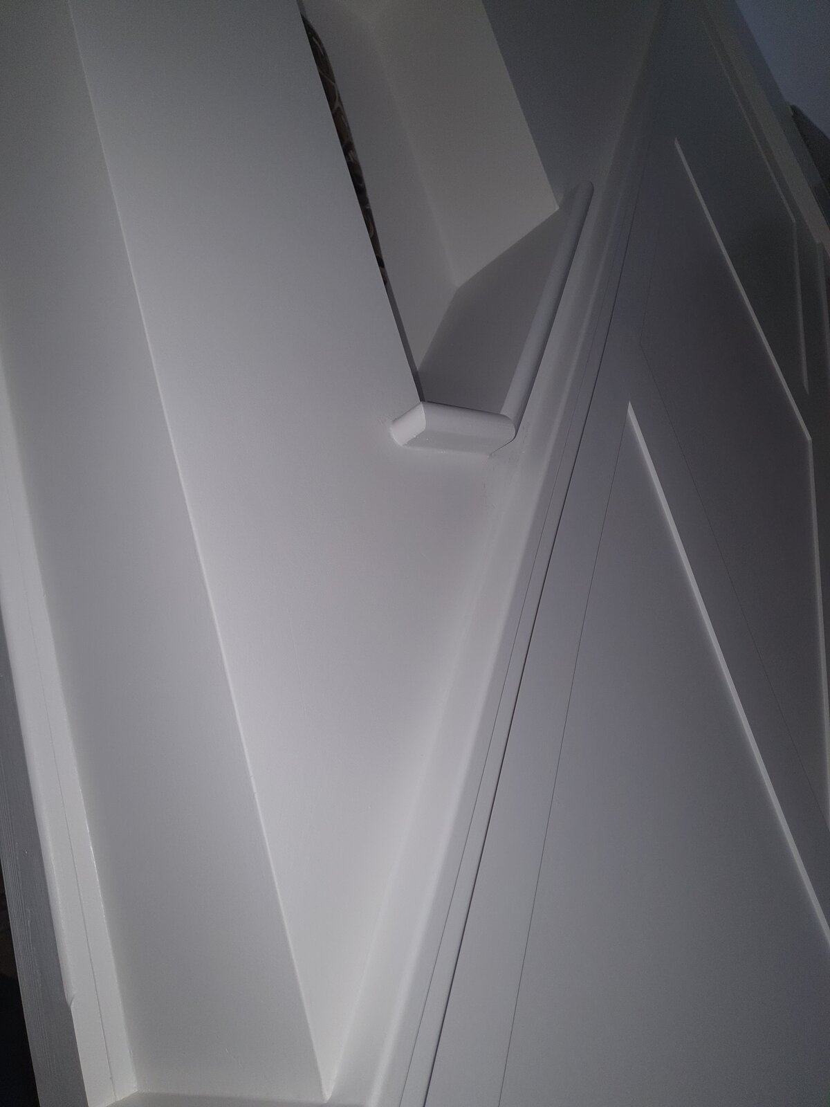

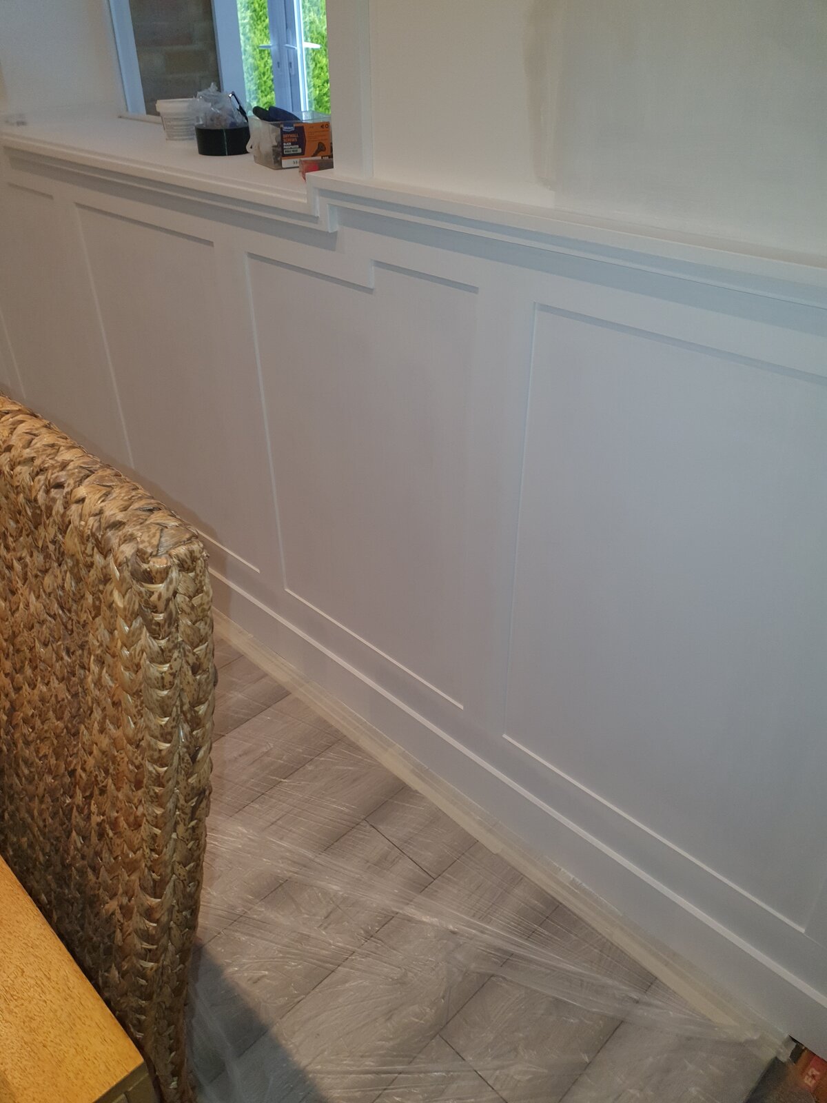

First coat. On primed mdf
