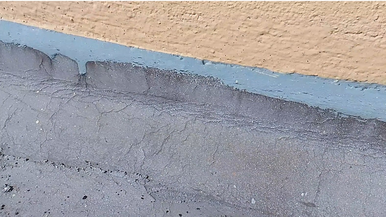

Looking for the light blue / grey product that is sealing between the yellow down wall and the tar/bitumen roof (no idea what its called)
Job was done few years ago and the black stuff came in blocks and the guys came with big containers and gas bottles and melted and poured it on the roof, that was already concrete. But some of the gaps between wall and roof have cracks that weren't filled in, so rain is sneaking in at a few spots, so I want to get that blue/grey stuff and fill them in. The stuff is rock hard still and doesn't seem to crack so it seems to be doing the job. Any i.d for it would be appreciated, thanks
Not as hard.
It's like a tin of blancmange. It hardens, but stays flexible to deal with any minor movement.
yeah but the stuff the guys put on years ago is still rock hard and not cracking at all, whereas Acrypol as per Woody can be flexible.
You need it to be flexible to accommodate differential movement between the wall and roof.
