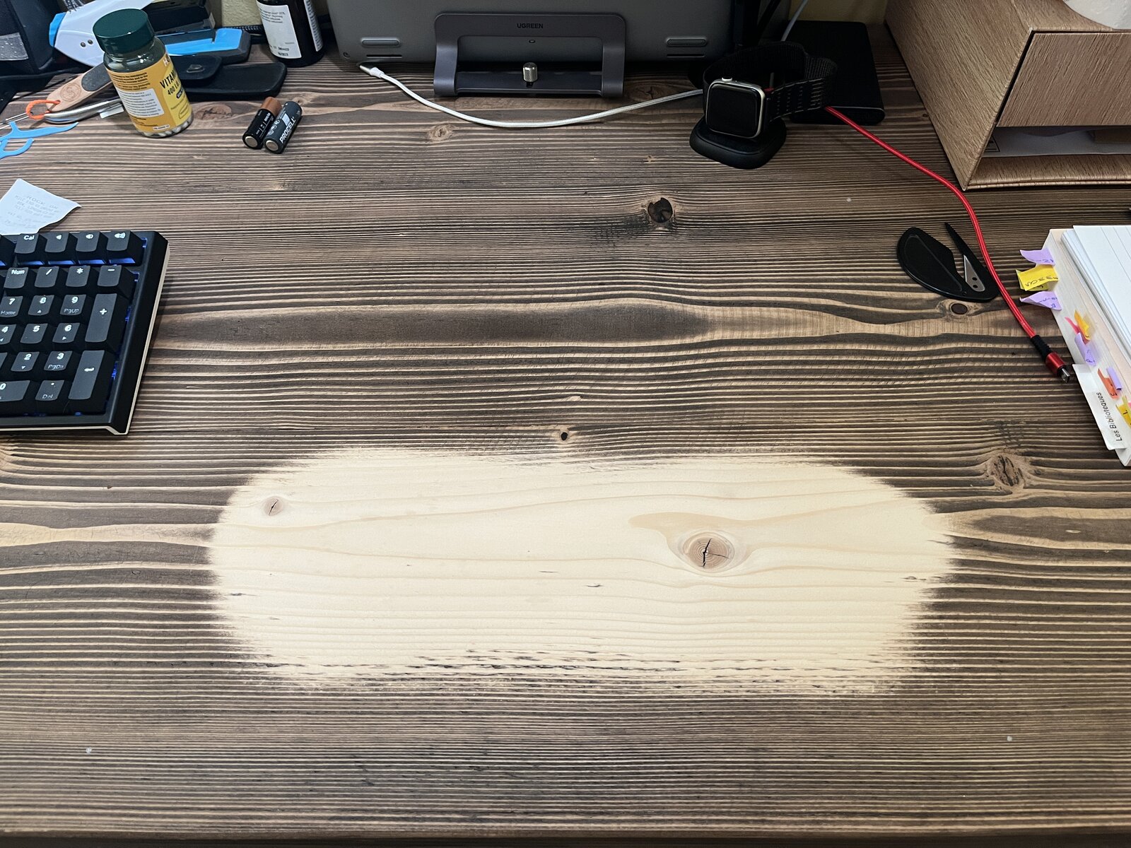

I have a desk that is made from three scaffolding boards biscuit jointed together.
Whilst it looks lovely and despite being sanded by the supplier, the desk isn’t completely flat, rising and falling around the grain and knots. This isn’t ideal for some of the computer mice sensors I use for precision work.
I have tried to sand where it’s obviously proud using a spirit level to see the highs and lows, but it’s still not great.
To finesse the final parts that are still a bit much for my mouse to track over, I imagine that I kind of want to run a massive pencil lead over the surface so that it only marks the areas still proud. Obviously that massive pencil lead doesn’t exist at 40cm in length. I’ve thought about putting a bit of wood oil on the bottom of the metal spirit level and ‘wiping’ it across the area to mark the parts that are proud, but I suspect there’s better ideas. Any suggestions? I can do it bit by bit, by hand through a fabric mouse mat but it’s imperfect and wonder if there’s a better way.
I’ve used a random orbital sander to do most of the work to this point but will probably finish with a sanding block by hand, 80 – 120 – 240 grit.
Thanks in advance.

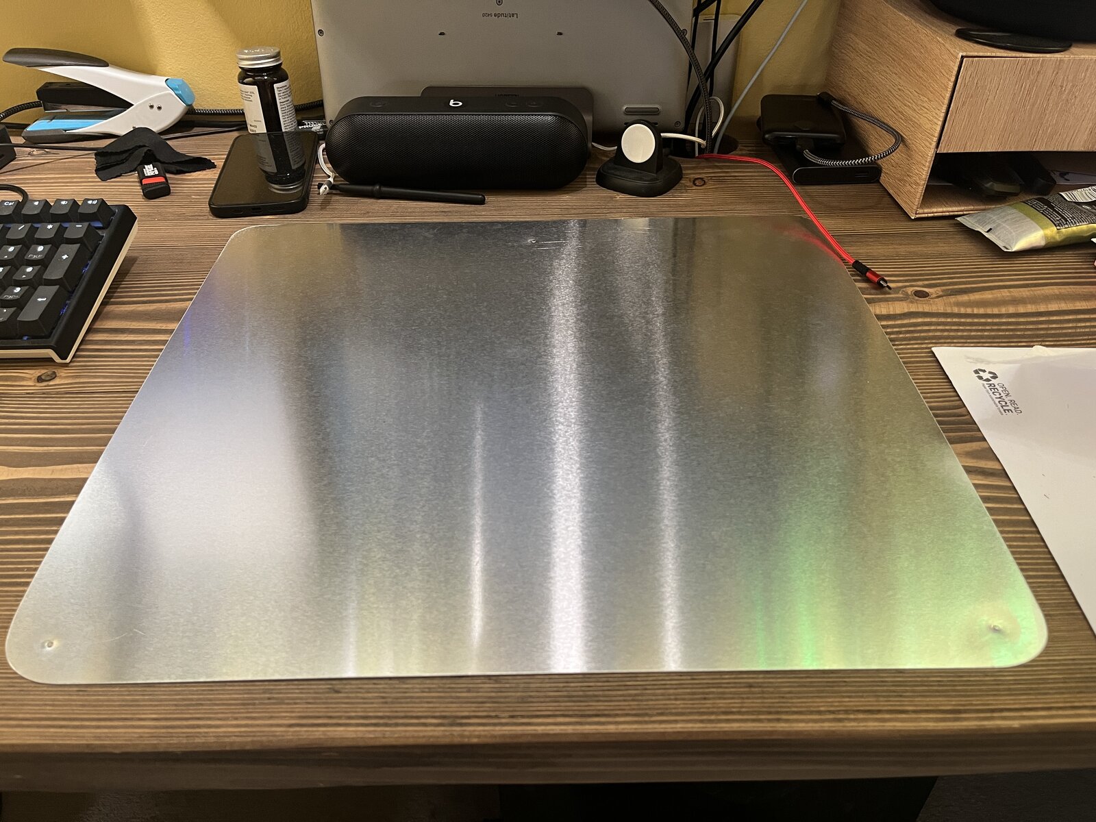

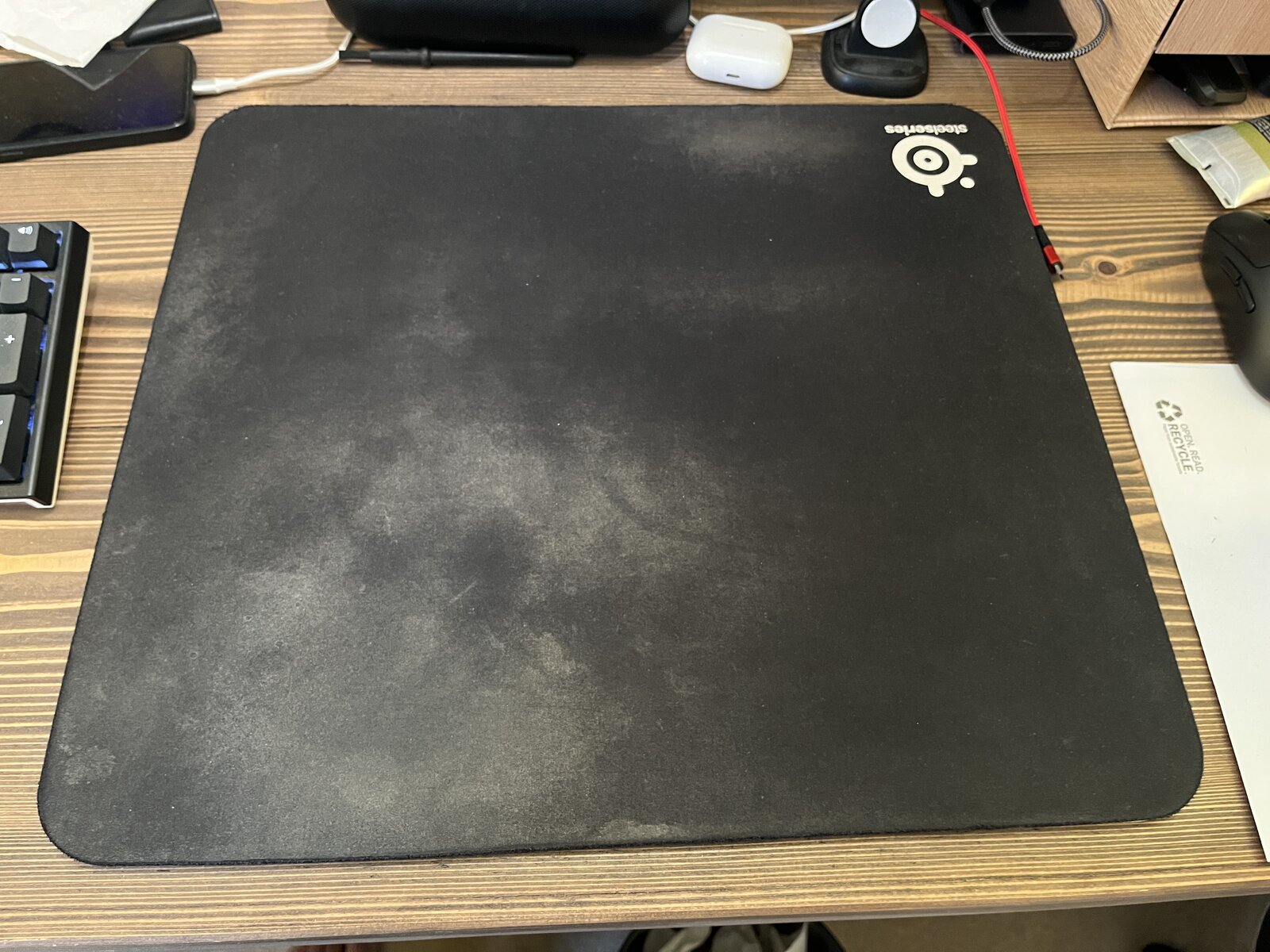

Another idea I’ve had which I’m going to try is getting a 1mm thick of sheet aluminium and screwing it into the boards over the affected area. Hopefully it will have enough rigidity to remove the ridges from a 4mm cloth mouse pad on top of it. Feels like a good trade-off time/cost/outcome compared to fixing.

Just a quick update for those that may find this thread through Google in months/years. I got a 1mm aluminium sheet as per the idea from a few posts above and it works really well at levelling off the area under the mouse pad. Very low-cost solution with no further work required on the wood itself other than 1mm panel pins on each corner to prevent it sliding.
Thanks again for all your suggestions :)
