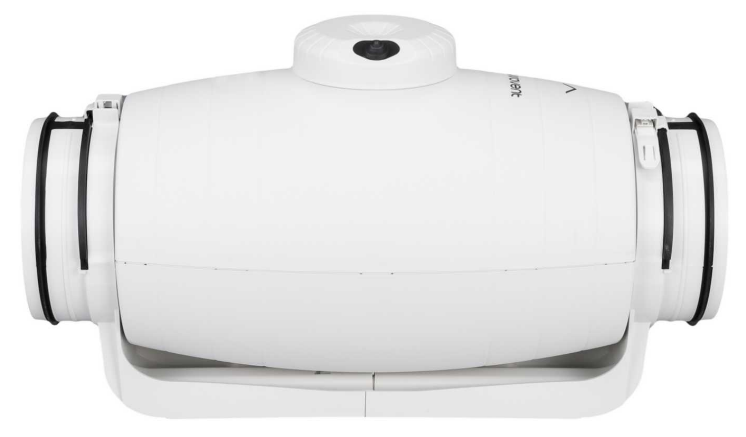

As for the set-up:
Inline fan in the loft, connected directly to a vent in the bathroom ceiling. One of these, installed vertically:
A metre or so away, horizontally, and less than that vertically, is a vent in the roof tiles.
125mm ducting.
