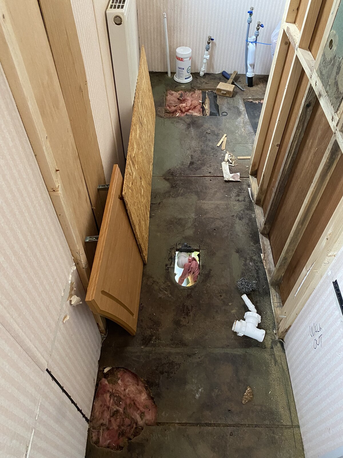

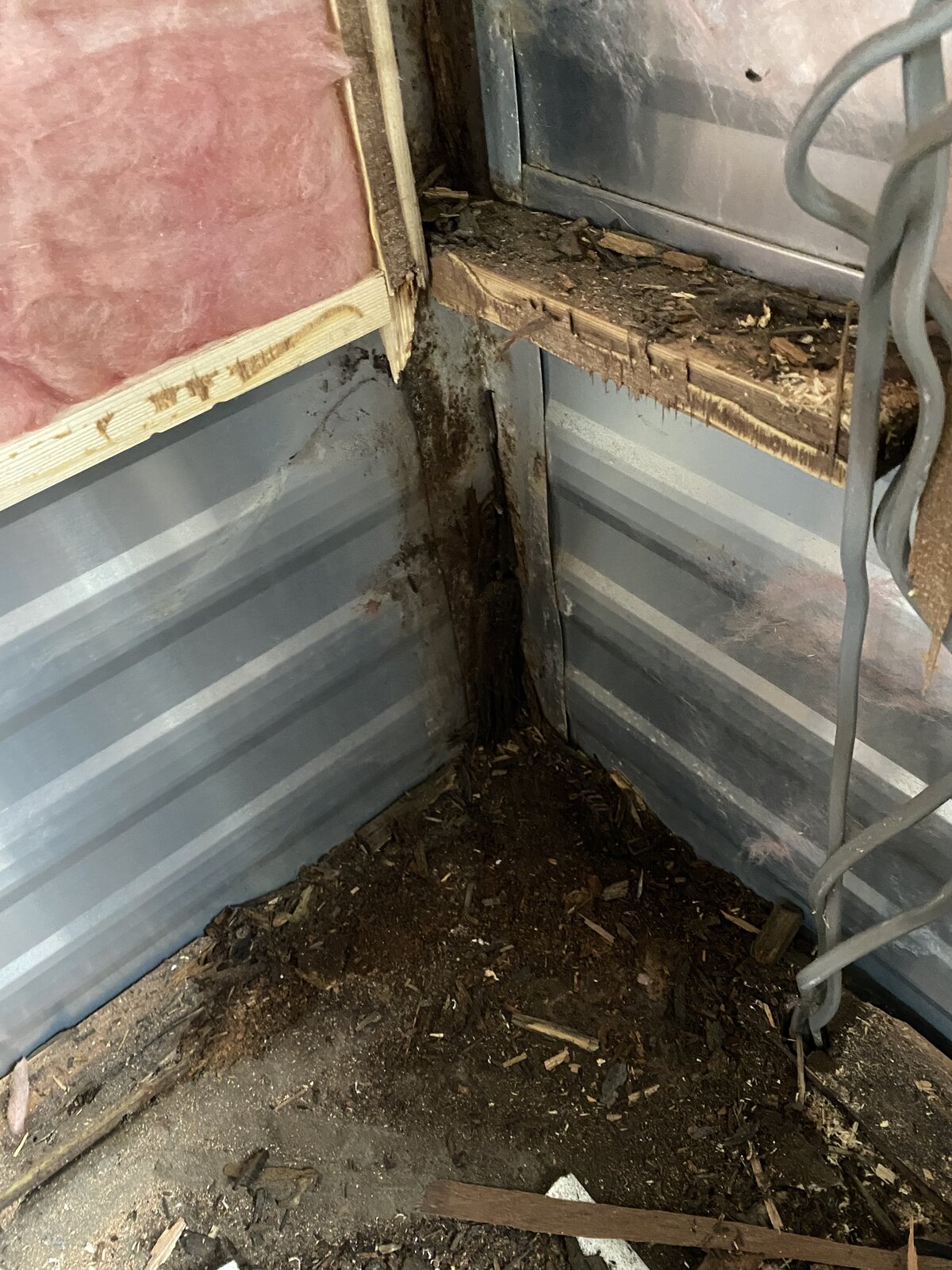

Hi, ive just retired to an old caravan in need of a major refurb. The first job i have is to renew the rotted chipboard flooring at the back end (about 4x5 sq/m)
The under insulation currently is mineral with an outer poly covering (underneath) but ive no further details until i start ripping the floors out.
Id like some advice on the best way of topping up/renewing the insulation. I guess mineral is the obvious although I had considerd topping up with Celotex but i always like to refer to the experts. And I read some suggestions that there's little to be gained with this approach anyway? W ould underfloor heating be the answer.
Im planning to lay 18mm Hardwood ply and possibly painting the underneath with bitumen or PVA as a further measure of weathering although it wont be directly exposed.

Hello, Have you any photos?
I presume you will be intending to install the insulation from underneath the floor? As doing internally will rob you of head height.
Rockwool is cheaper than celotex but roughly half the efficiency. I would be tempted to stick celotex straight to the plywood floor (from underneath), tape and seal all gaps with a foam gun and aluminium duct tape, you shouldn't need to paint the plywood.

I had the same thoughts as yourself ill fit Celotex fitted between the joists and lay the ply directly over. If i tape it off and use the foam from above ie. when the floors off, i assume that will be sufficient?

I've ordered the screws from SFX and I'll give it a go when i eventually get a bit of flooring down, getting the old stuff up is proving s lot more difficult than i thought it might be.
Found a good price/supplier for 80mm Celotex which has been delivered but ill consider the foam option for the remainder where i won't need to replace the flooring.
As you'd expect trying to make a tin can habitable is proving, well, interesting!
