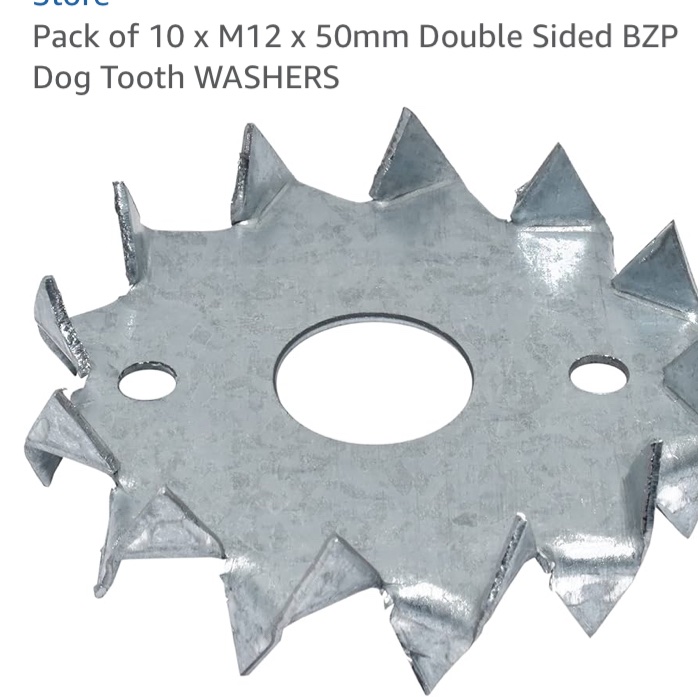

Oh, and with the coach bolts used for sistering, what washers do I need for the head end of the bolt? They have the square section that normally forces into the wood, so do I need washers with larger holes?
Toothed washers
Fofhole's washers go between the timbers, you have big washers under bolt head and nut (typ 50 square). You don't need coach bolts: I tend to use cut lengths of studding
You can get made for purpose bolts with large heads specifically for the job.
Why would you use washers between joists? That is what it appears they are intended for but I can't understand what purpose they would serve.
The toothed washers' purpose is to prevent slippage: critical if you're extending a beam where the fastenings will experience shearing forces.
No real benefit if you're just full length sistering where all you're doing is holding the 2 beams together
