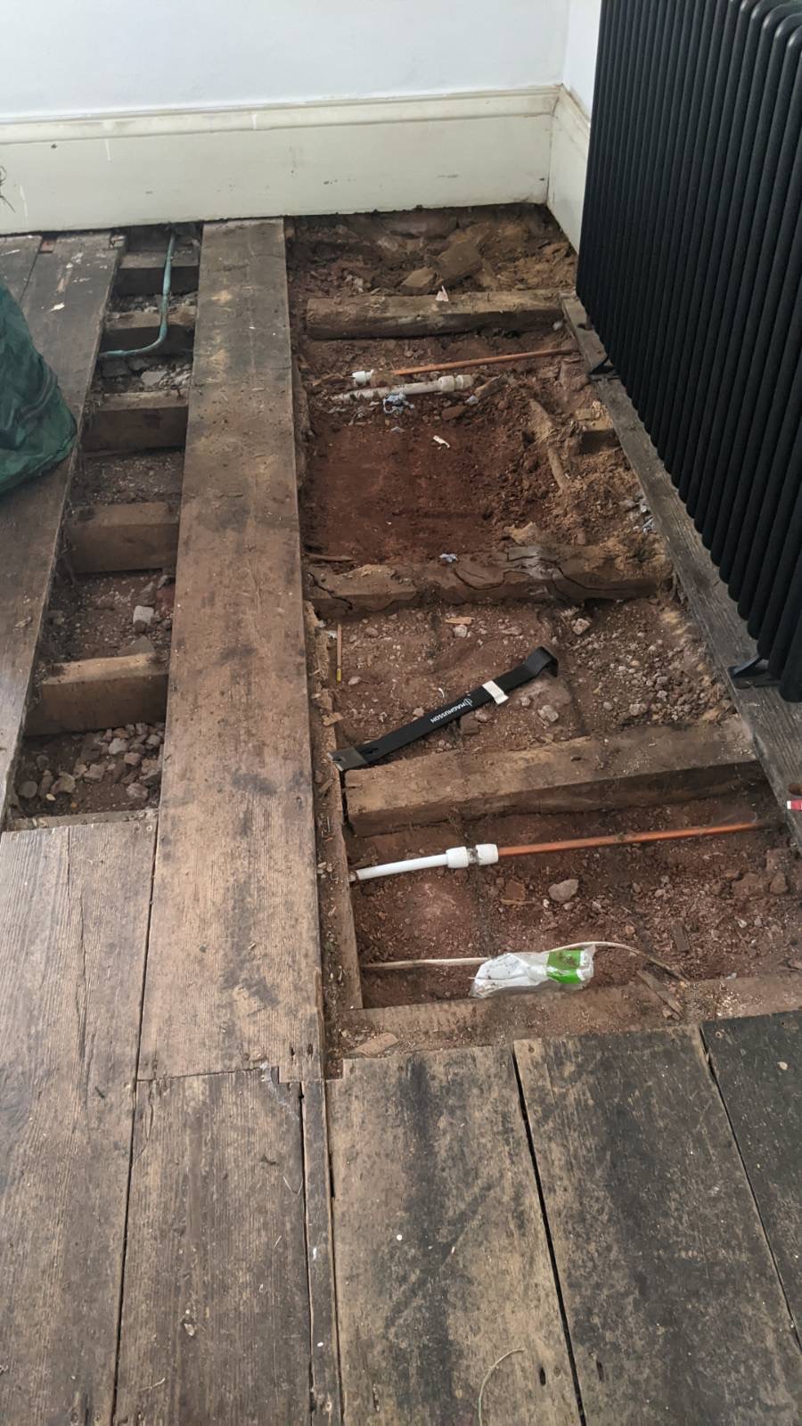

Hi all. I've moved onto a Georgian house in serious need of renovation and care. The flooring in the main downstairs room is rotten in the corner so i'm pulling up the floor to see how far the problem extends. It looks like the joists are plonked straight onto the ground so not surprising the joists have rotted near the external wall. Is this likely or should their be something like sleeper walls supporting the floor?
Thanks Bonni. Is it worth digging out a cavity so there's room to put in dwarf walls and rest new joists on those? I'm thinking I should do this "properly" with dwarf walls, breathable membrane etc but that would require digging out a fair bit of earth which the joists are currently resting on.
Hello
Have you got air vents installed in the outside walls?
If so, and you are wanting to have a suspended floor, you would be better digging and removing some of the soil/rubble say 300mm to allow for ventilation, this helps control the damp from the 'earth'
Depending on room size this will dictate new timber sizing and where/if you need sleeper walls building etc.
If you choose to make the floors solid concrete, you will still need to dig out some of what's there
As you'll need hardcore (100mm), sand (50mm) DPM sheet, Concrete (100mm) insulation (100mm min) and finally screed (65mm) = 415mm approx.
Wood doesn't want to be in direct contact with soil.
Hope this helps.(y)
Thanks Mr C; Yes, there are a few airbricks in the exterior wall, though no air will have got through to the rotten joists. I will excavate to 300mm. Do you think sleeper/dwarf walls are the right way to go? Would positioning new joists on single bricks also work? Willing to be shot down by those with experience but given how the house was originally built (e.g. joists straight onto earth) I wonder if this might be a big improvement for much less disturbance & effort?

In older properties I've lived in (with suspended floors) there is usually a dwarf wall around two opposing walls, and honeycombed sleeper wall if the span is large. Guess you could dig less out and rest new joists on brick/blocks but you'd need to get the air vent clear and establish some airflow in and out, otherwise you are increasing the chance of damp/rot again.
